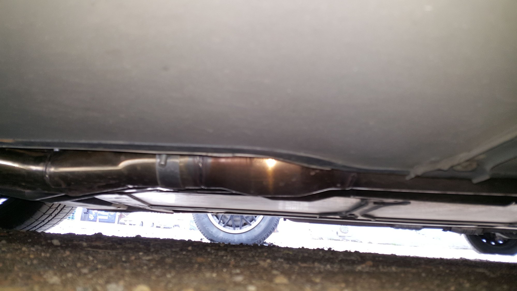

Hi CF, I have a 2000 vert, considering headers. The previous owner had replaced the h-pipe with an X - the cats appear to be the stock ones. I have no idea who the manufacturer of the x-pipe is.
Was wondering if I could use the stock cats and x-pipe with a set of Long Tubes or do I have to replace the cats and X to ensure fitment.
I have a Corsa Axleback which mated up fine with the X-Pipe if that at all matters.
Thanks

Although AFAIK the stock cats flow plenty well, they would at the very least have to be moved with most LT's. For this reason (and age) I'd opt for some new (I used MagnaFlow 3") cats.
P.S. A pic would help us identify if your cats are factory or not.

Thanks folks. I will try and take a pic of the cats this weekend. Car is lowered with side skirts so I need to raise it up to get access.
