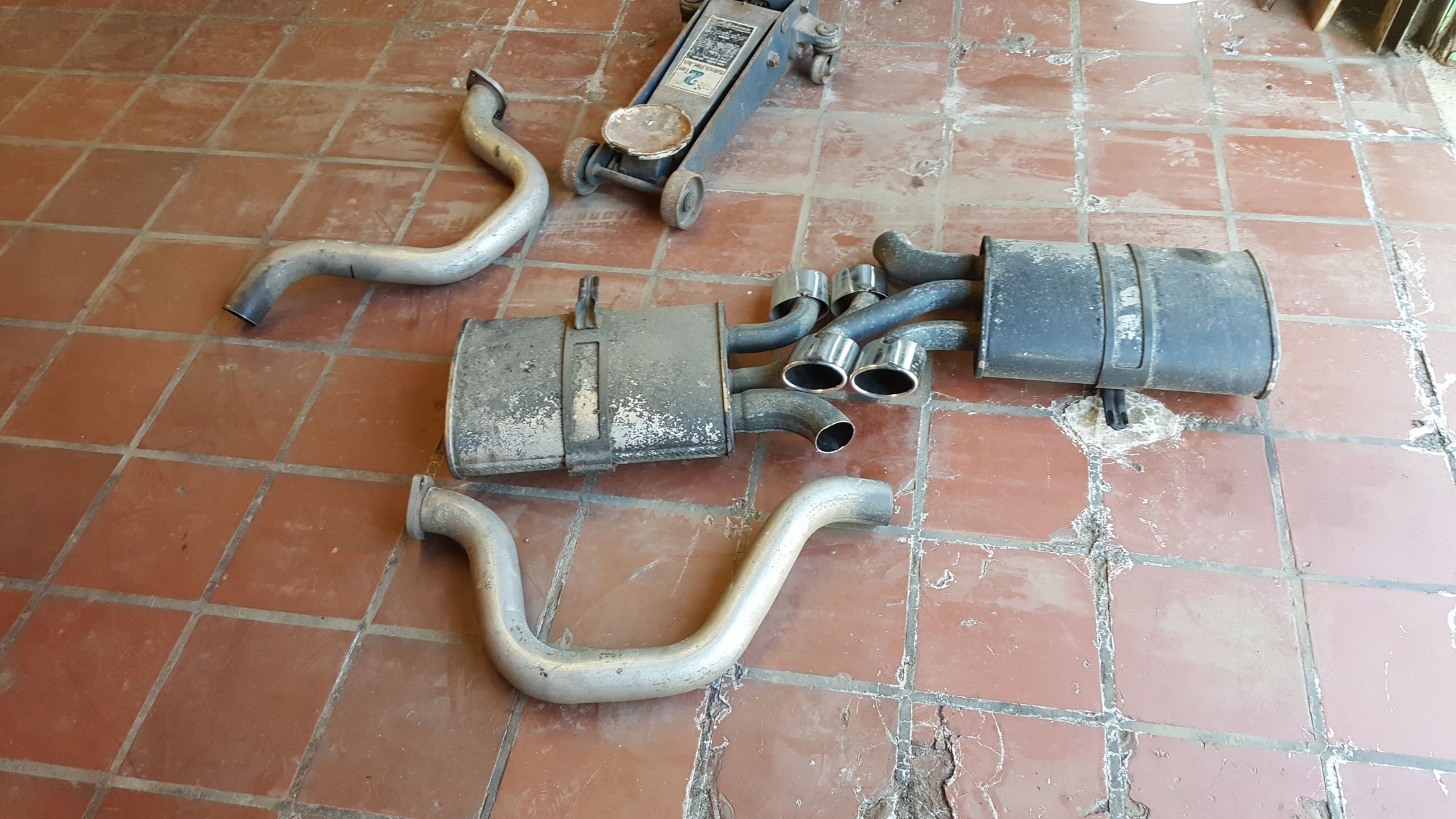

Default Corsa Sport along with Corsa X-Pipe installed..VID
SOUNDS SWEET ! I LOVE IT
I dunno why this damn video isn't working...here's the direct link :
https://www.youtube.com/watch?v=0V-y...ature=youtu.be
And yes I know the enhancer plate is off to one side. Will fix at a later date.

To install a catback exhaust at home, what is the height the car needs to be raised to?
Old 04-09-2017, 04:35 PM
SG Lou
SG Lou's Avatar
Member Since: Dec 2010
Location: Fords, NJ
Posts: 3,937
Received 486 Likes on 370 Posts
I had my car about 2 feet off the ground on jack stands. If you are going to remove the stock mufflers a MINIMUM of 3 feet is needed to swing the pipe over the axle. A lift is highly recommended. If you don't want to save the original mufflers then you can cut them like I did for easy removal.
