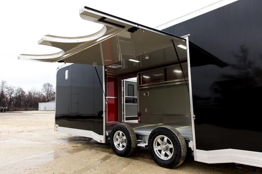

The "escape door" is pretty much a requirement for any coupe vehicle (with larger doors).
This is a premium option type which removes the whole fender and side wall. But you can get others which are just a door that opens. You are going to have to measure you door height and check each trailer for it's height for the bottom lip of the escape door.
Winch is pretty much a necessity, just in case. But winching in is no picnic either. You have to leave the window down in case you need to adjust the steering wheel, both going in, and going out. Well, we are likely going to want the window up when finished, so now you still have to open the door, key in ignition, etc. etc. (Unless you have a window valet.) Also, a wireless controller for the winch is much better so you can stand/walk next to the steering wheel as you winch in the trailer.
