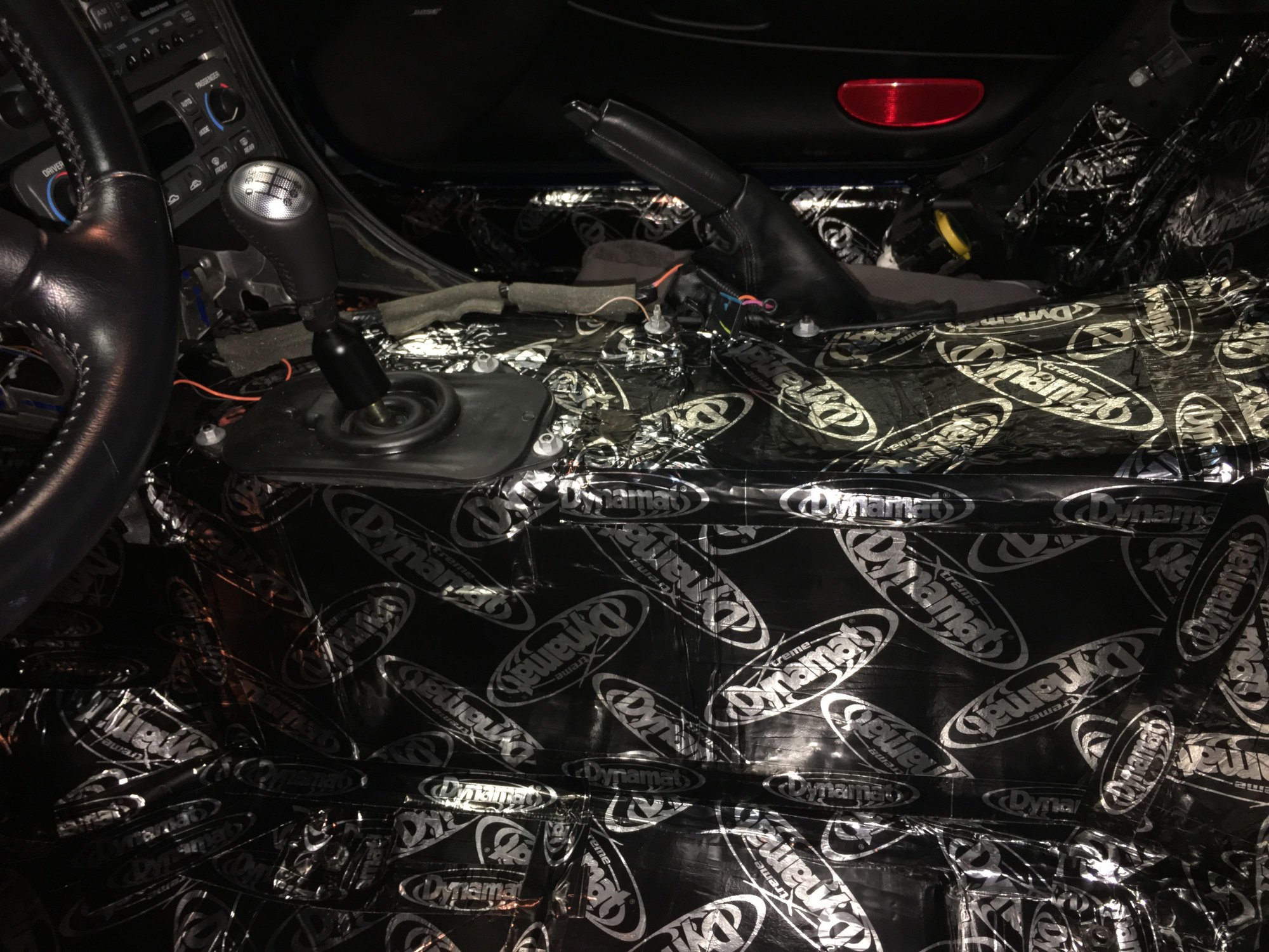

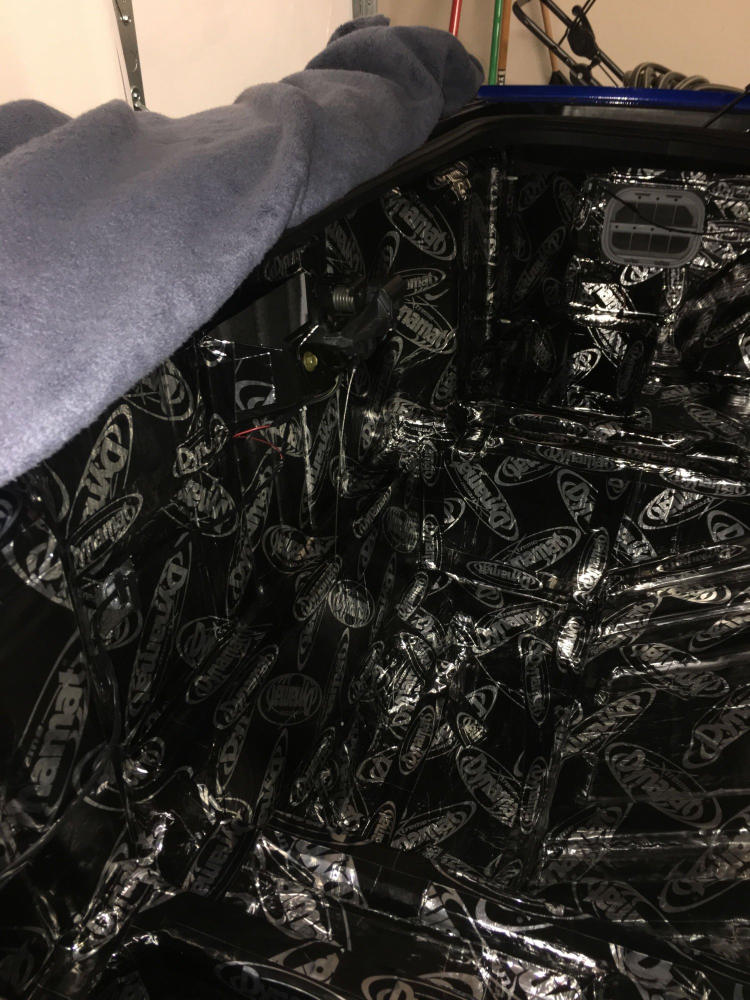

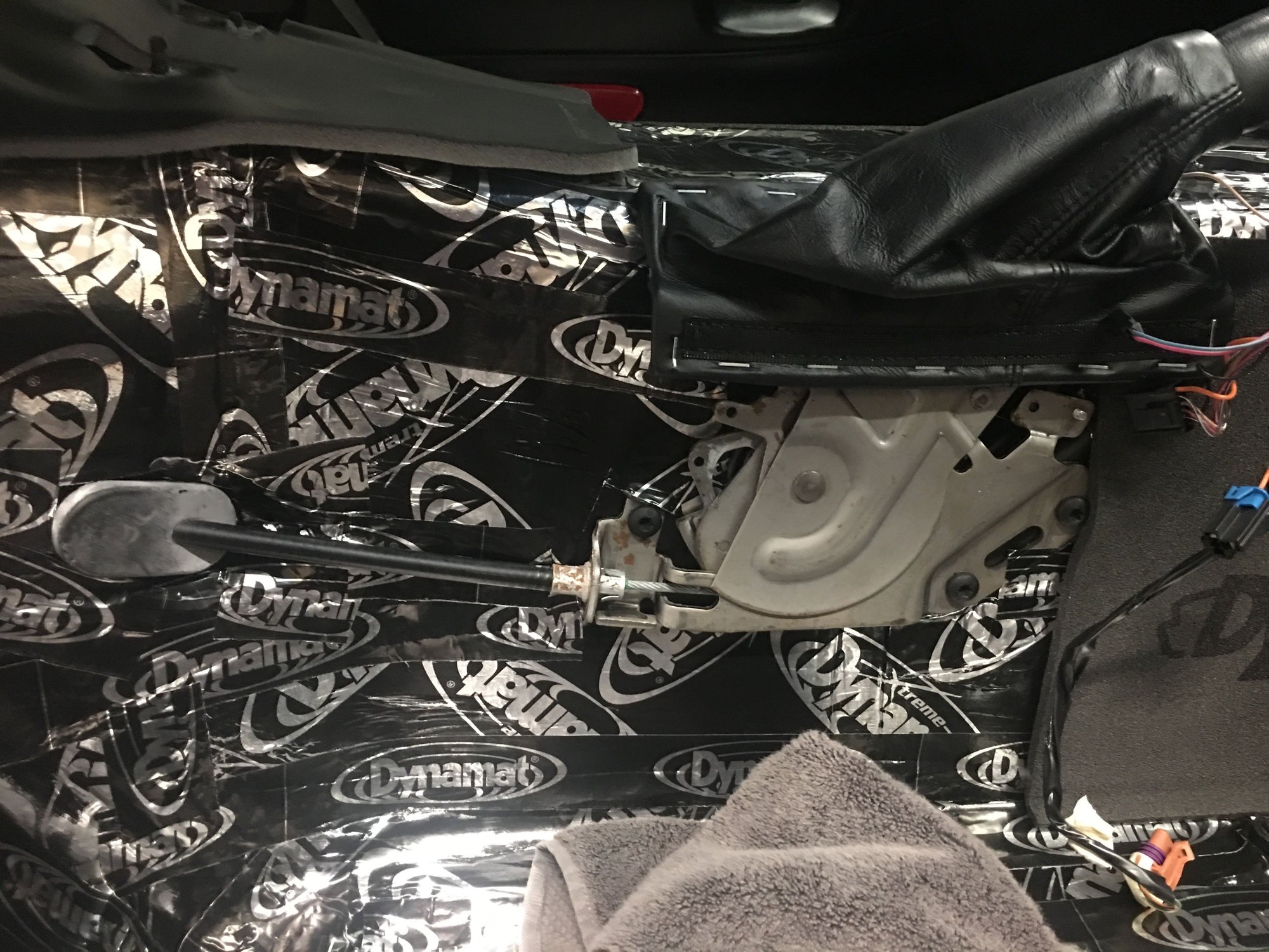

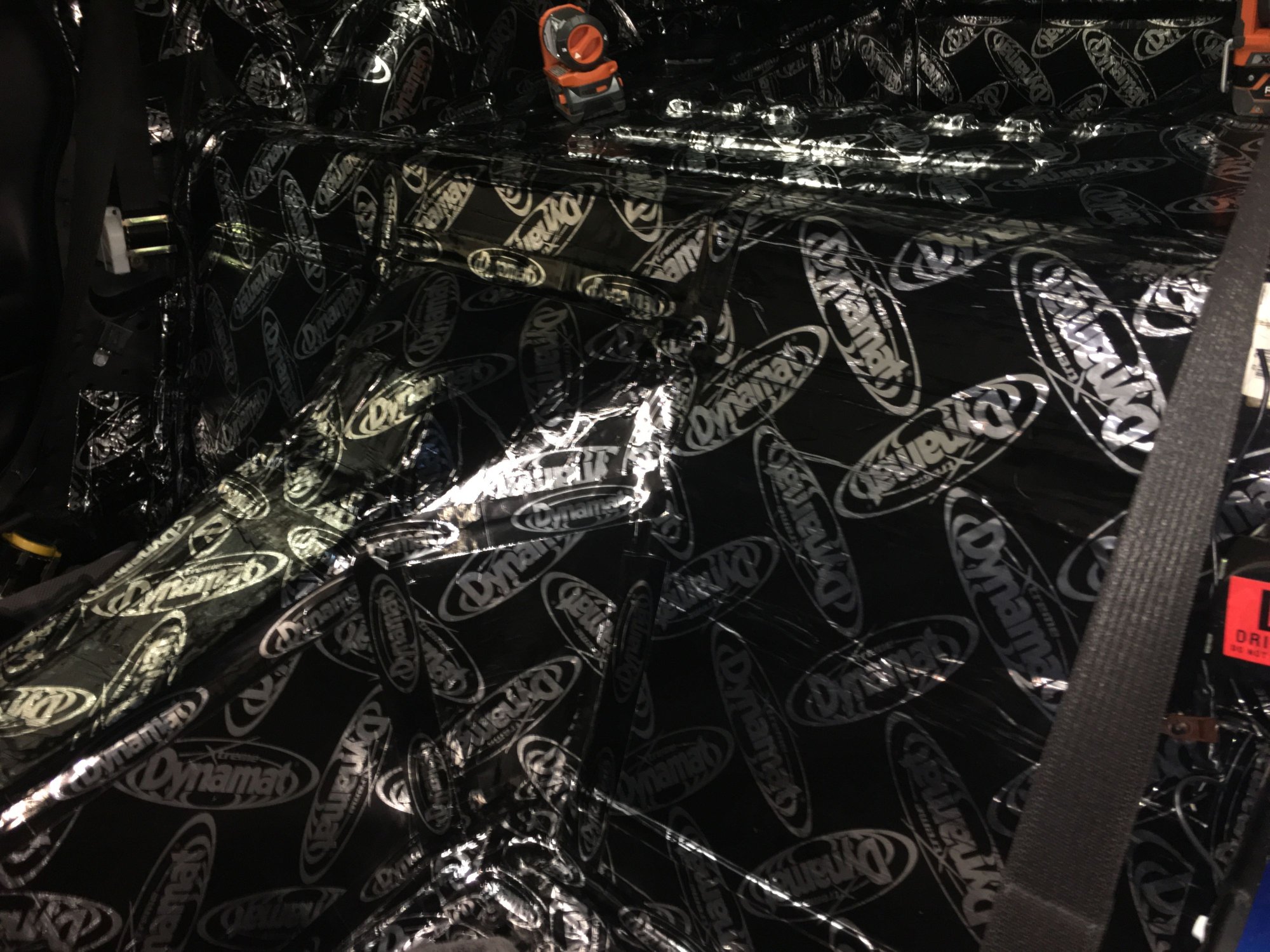

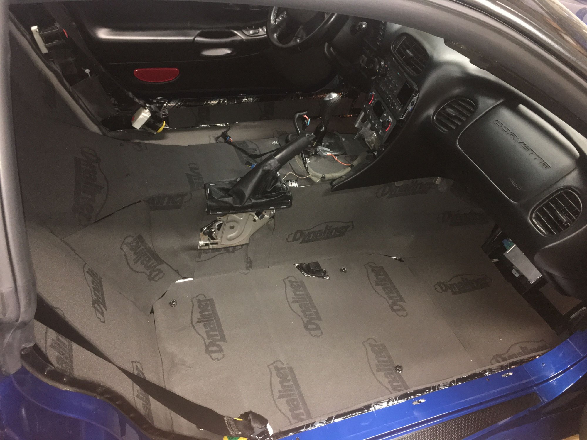

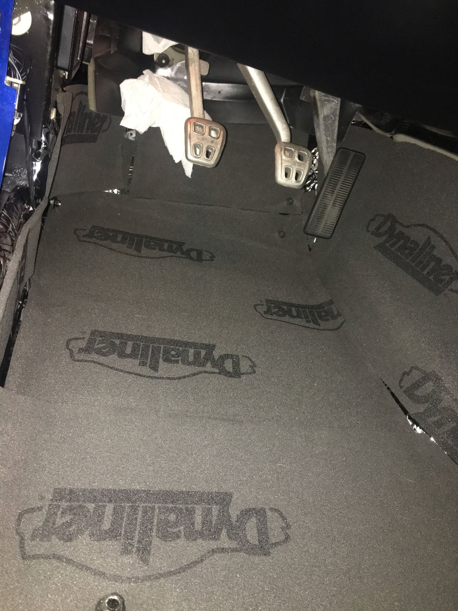

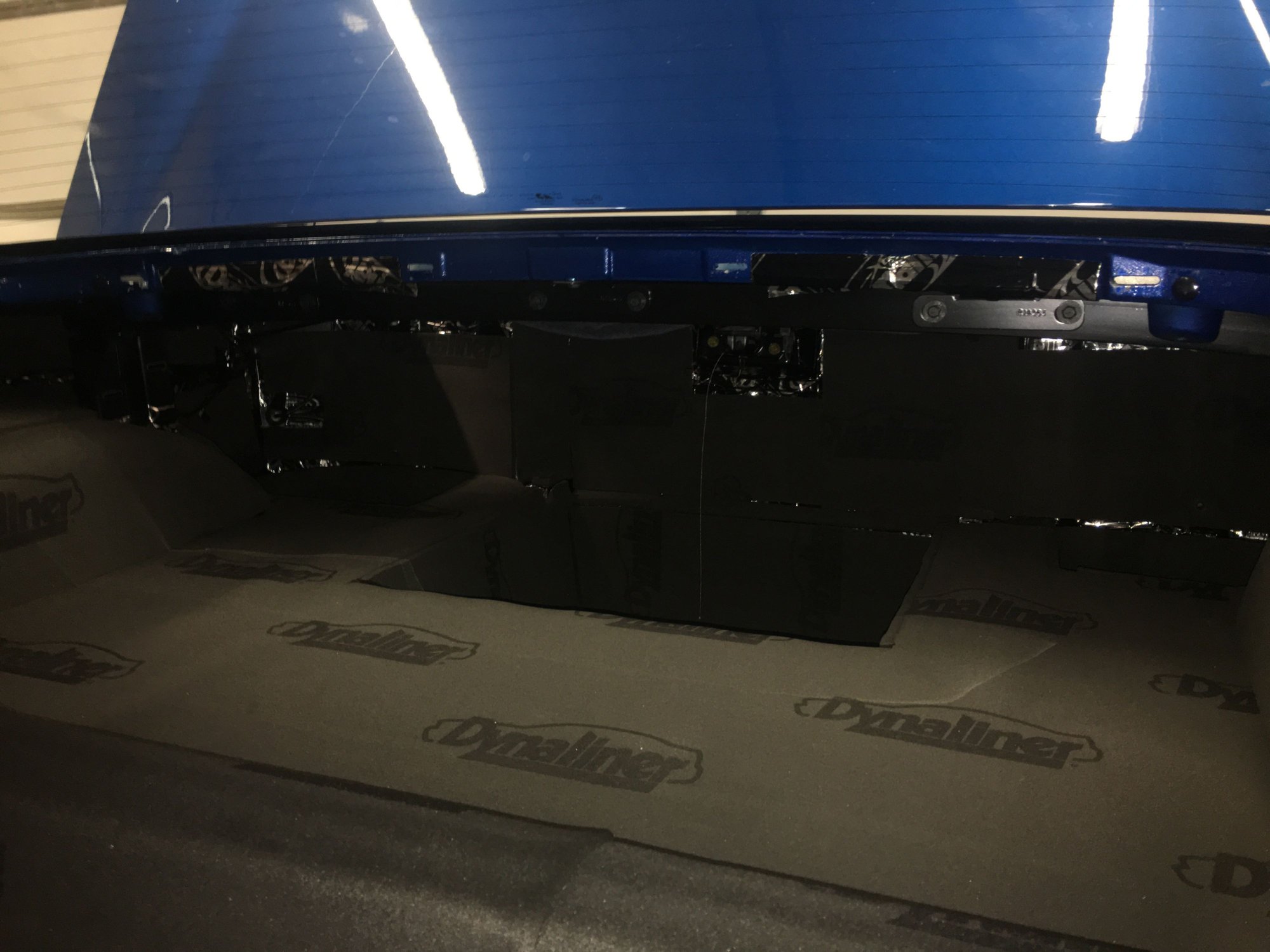

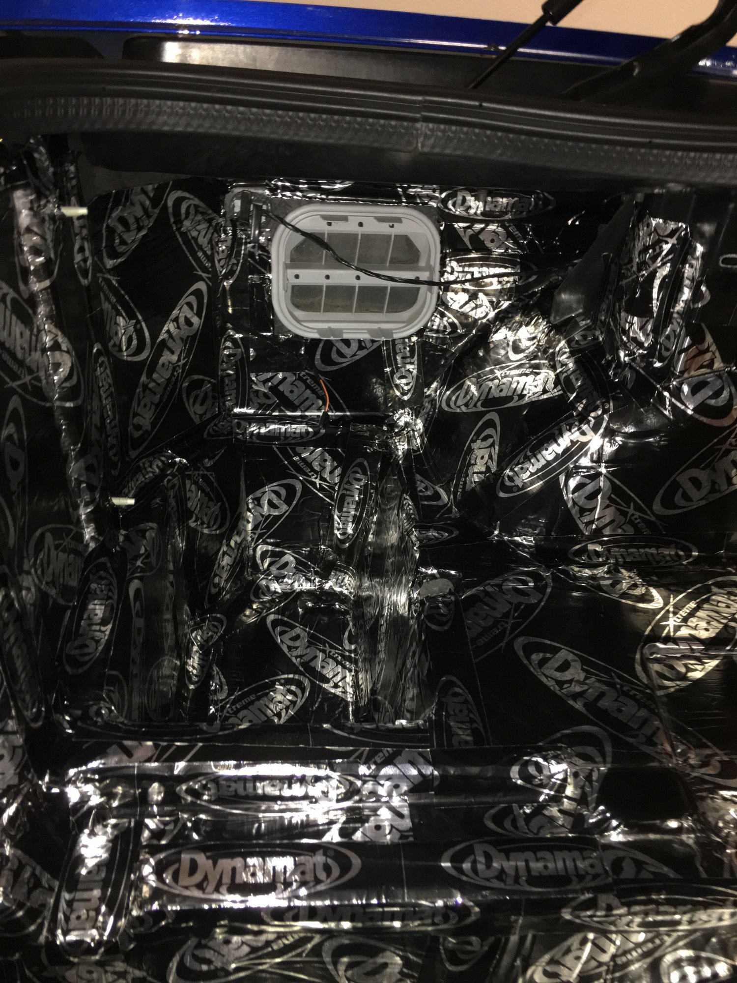

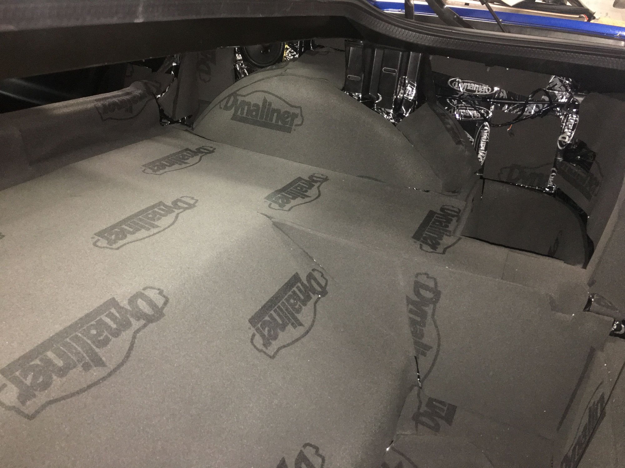

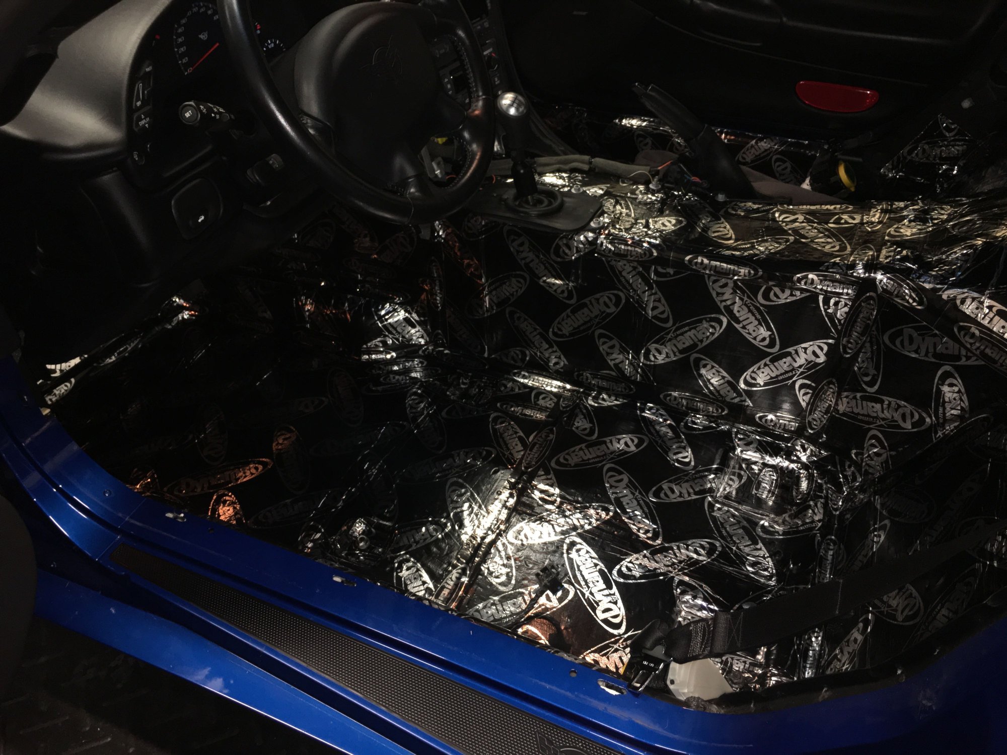

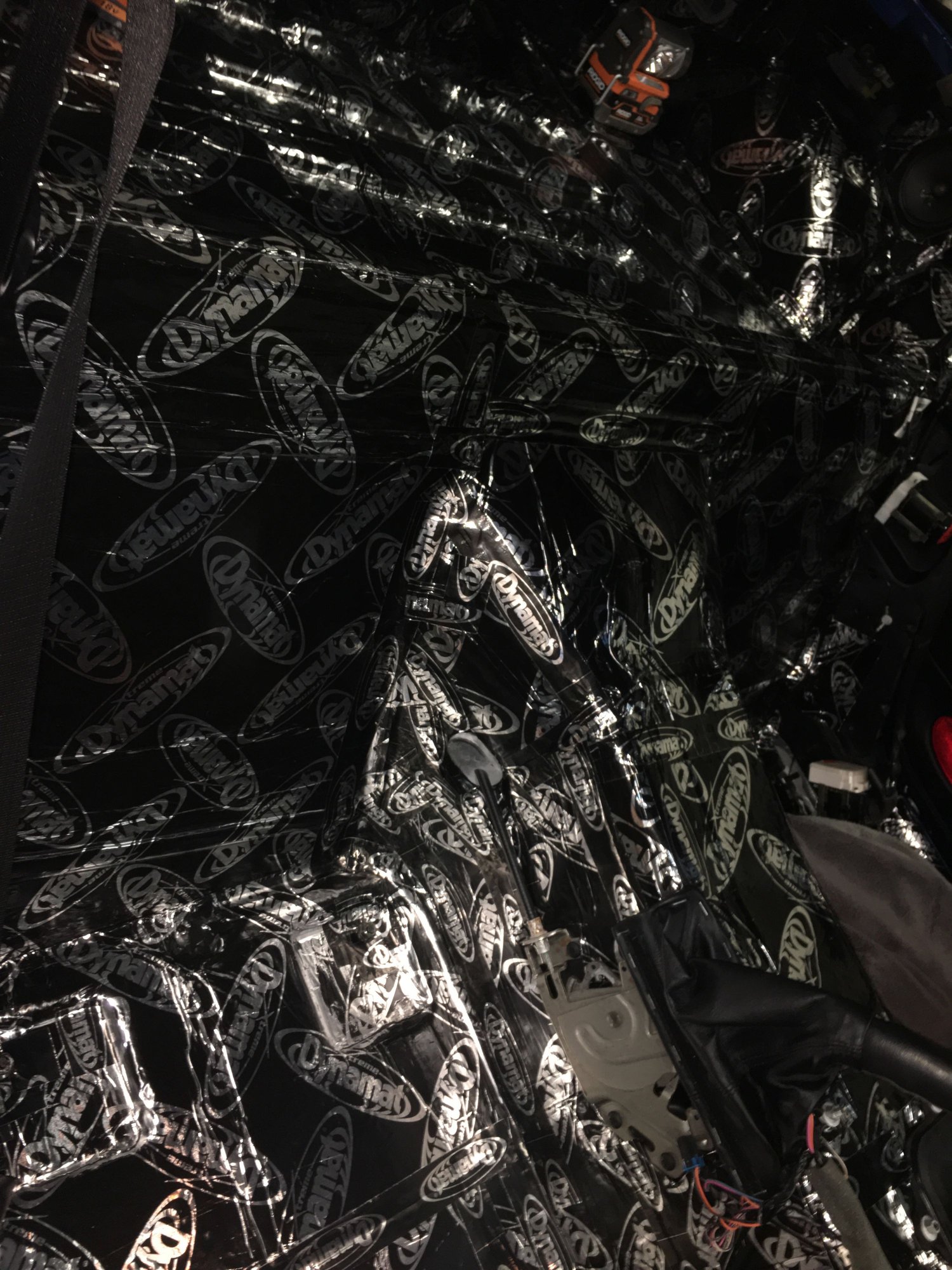

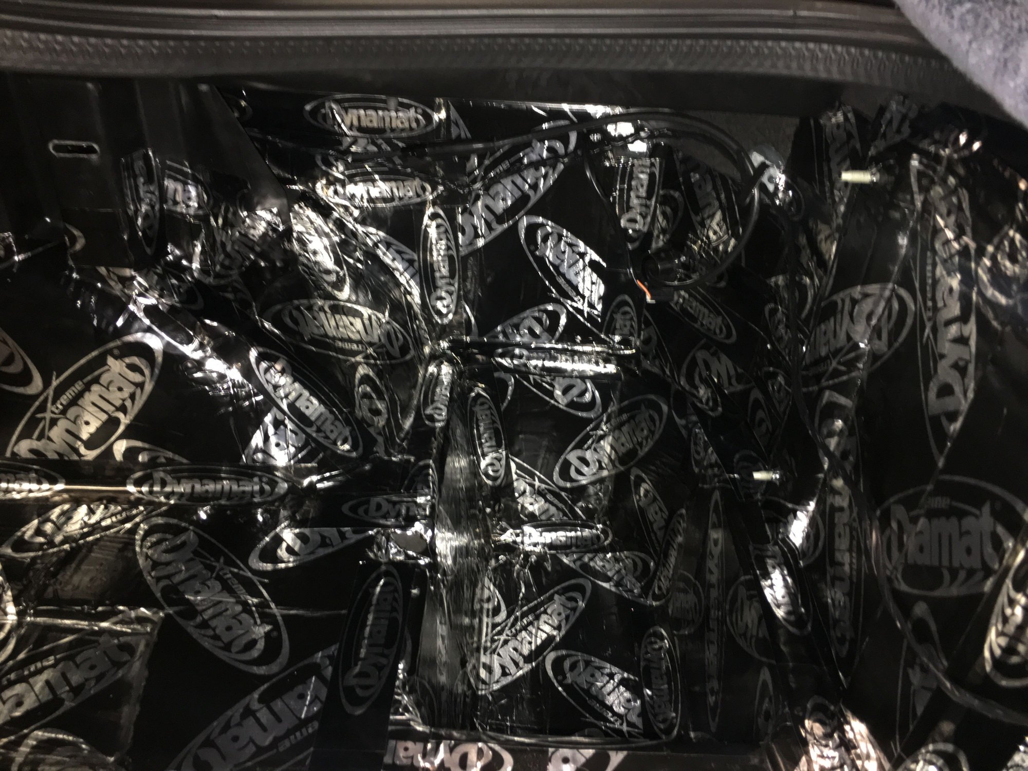

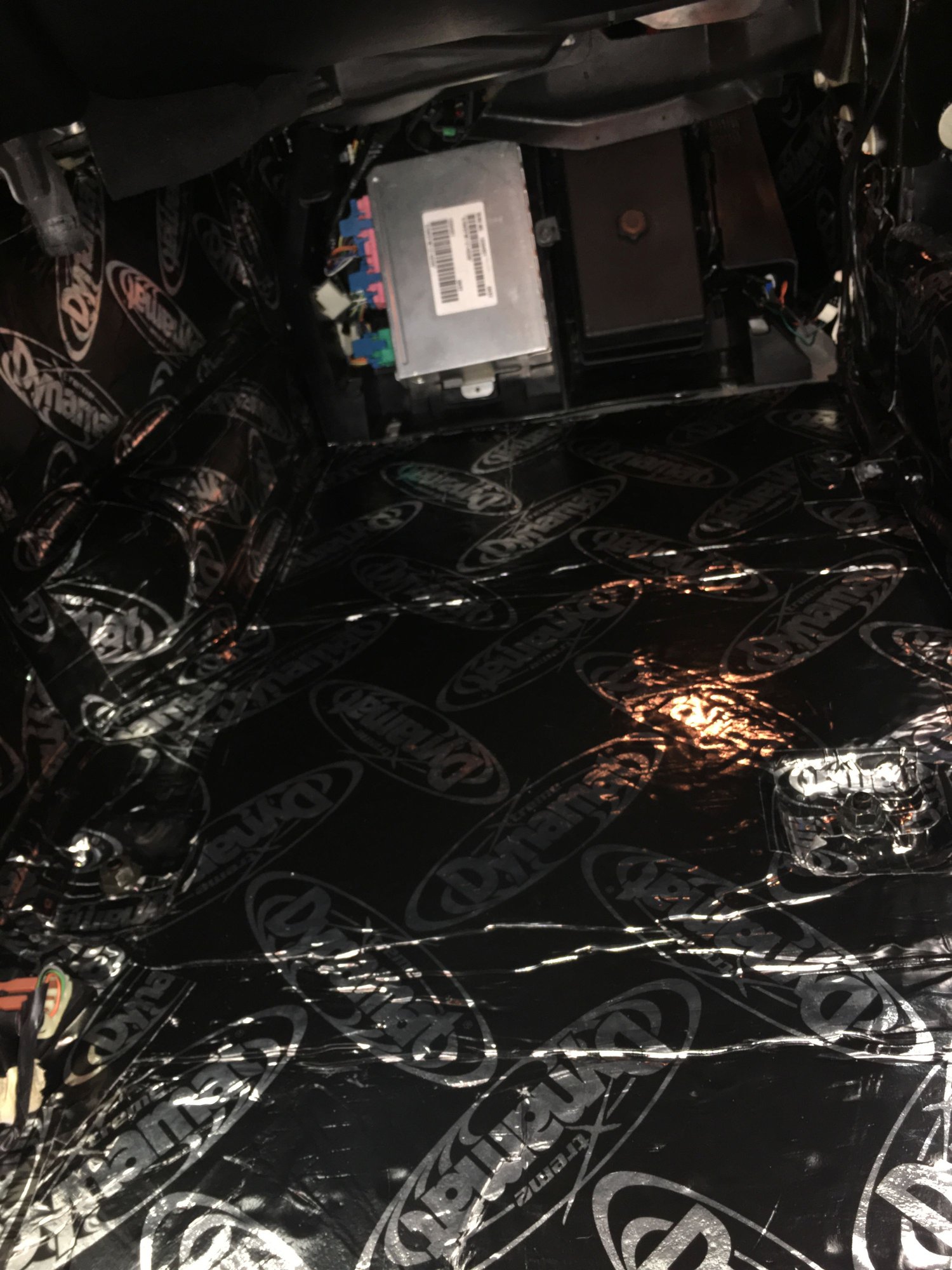

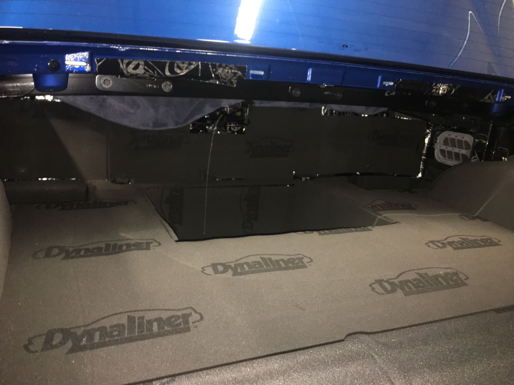

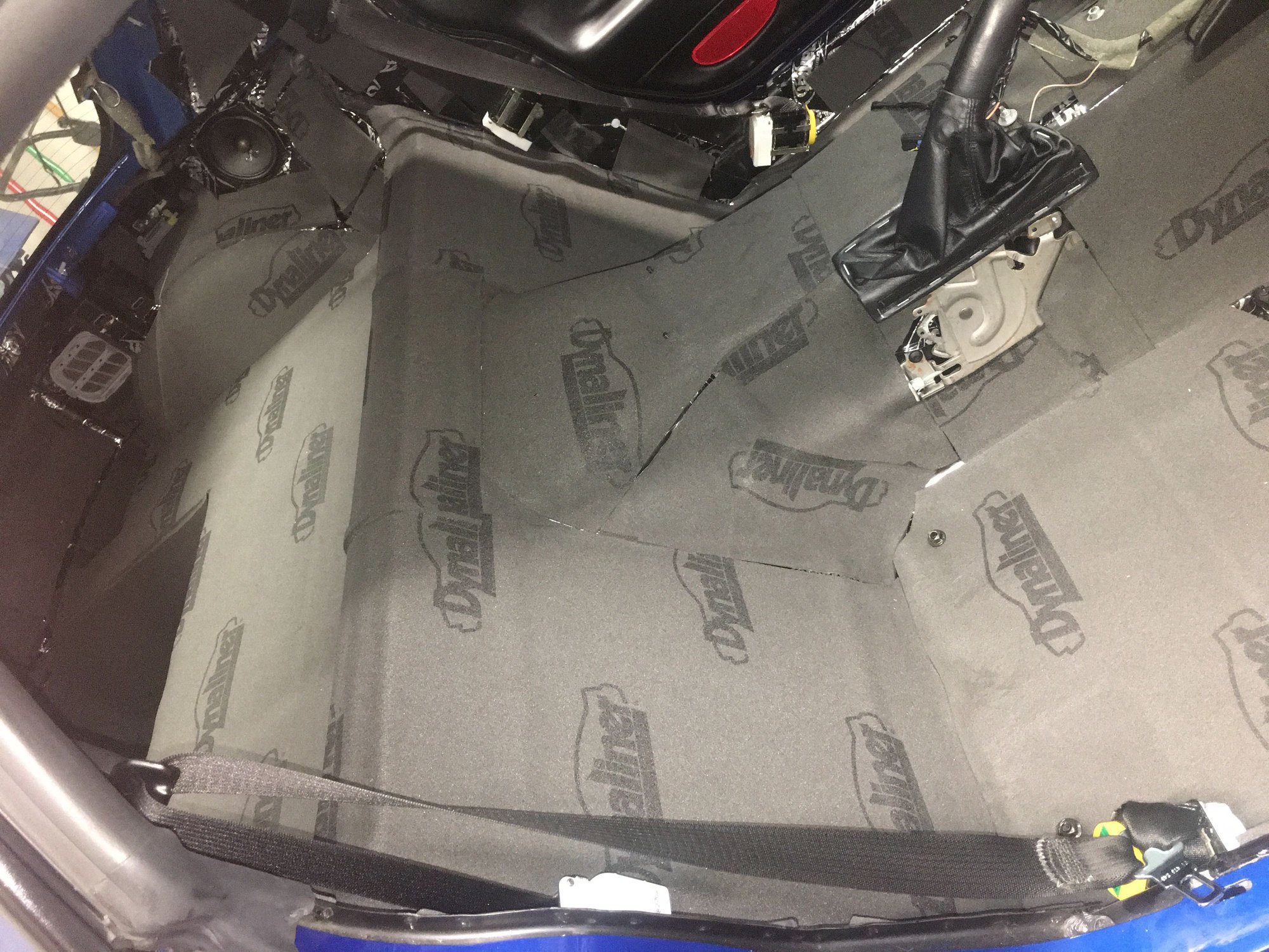

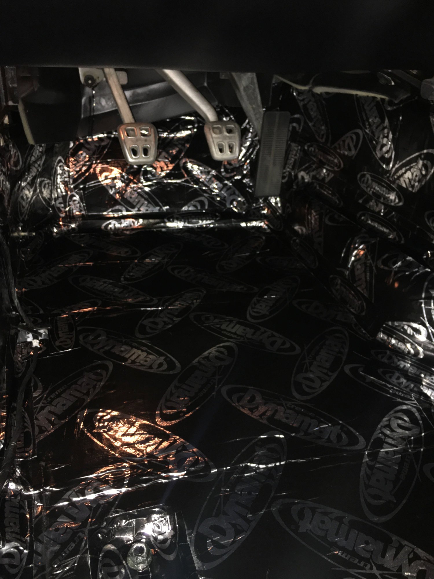

I wanted to make a post of my recent install on my 2002 Z06 EB 32,000 Miles stock. I installed Dynamat Extreme on every inch of the interior and then covered it 100% with 1/4" and 1/2" Dynaliner depending on the location. My main concern was just overall interior noise along with a little heat as everyone knows from the center console area. I also added the compartment divider. This is my first post so I am new to this so bare with me.
I ordered the products from Walmart online and used 3 bulk packs of Dynamat Extreme exactly. The install was very easy and I was very happy with the quality and ease of use/install with Dynamat. The interior is extremely easy to remove and if you haven’t done it there are forums with the steps to do so. When installing the Dynamat Extreme there was not a spare piece left over. I used 3 pieces to cover each door and everything else went to the rest of the interior.

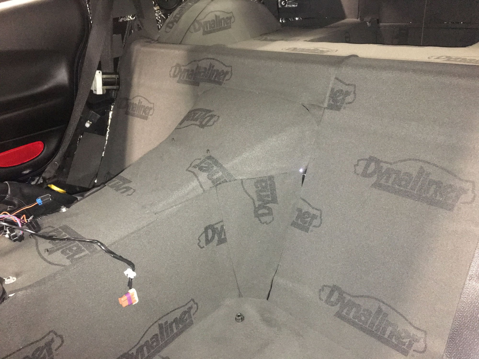

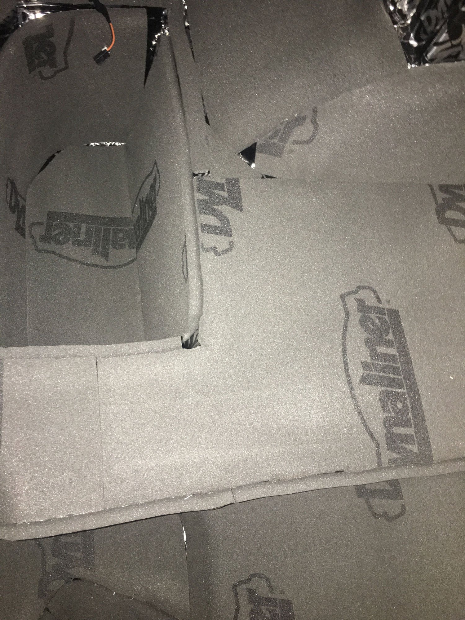

I used the 4 boxes of the ¼” Dynaliner to cover the front half of the car waterfall or behind the seats forward and then used 3 boxes of the ½” in the rear or trunk area. I was nervous about the fit and finish of the carpet going back in with the ½” but everything went in snug for sure but it fit very well with no deformities to the carpet. The main issue I had was the compartment divider that I ordered was all foam and it was a little scrunched which I had no issue with as it would make a better seal. Although it did leave a little imperfections in the carpet as you can tell from the picture. I am ok with it as I know it is a snug and secure fit.
I noticed a big difference from the Dynamat and Dynaliner. The inside road and exhaust noise was greatly reduced and the heat radiating in was slim to none. The compartment divider did an ok job and did help but It seemed like a cheap piece of high expansion foam that didn’t do as much as I was hoping in terms of sound reduction. The car audio was greatly improved and it was much easier to have a conversation in the car.

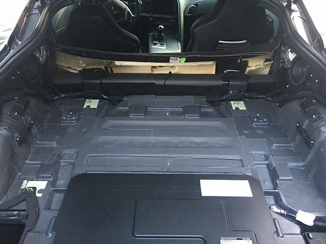

I may in the future make my own compartment divider with that one as a template with better materials and see if that helps.
Overall it took about 2 weeks but that was on and off and the car is not a daily driver so I was in no rush. I was more concerned with getting the job done right. It did add some obvious weight with the Dynamat Extrme. I would say maybe 60lbs. However the Dynaliner was a dense compact foam and did not weigh hardly anything which made me go ahead and add it everywhere as well.

More Pictures

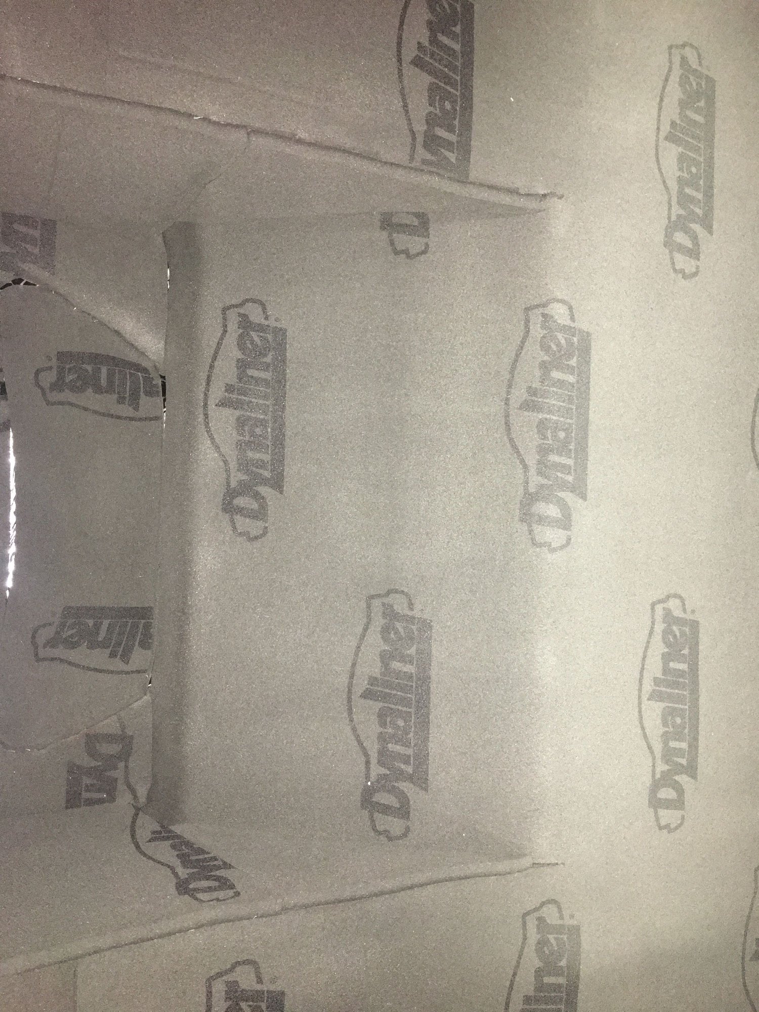

Dynaliner

What I used
