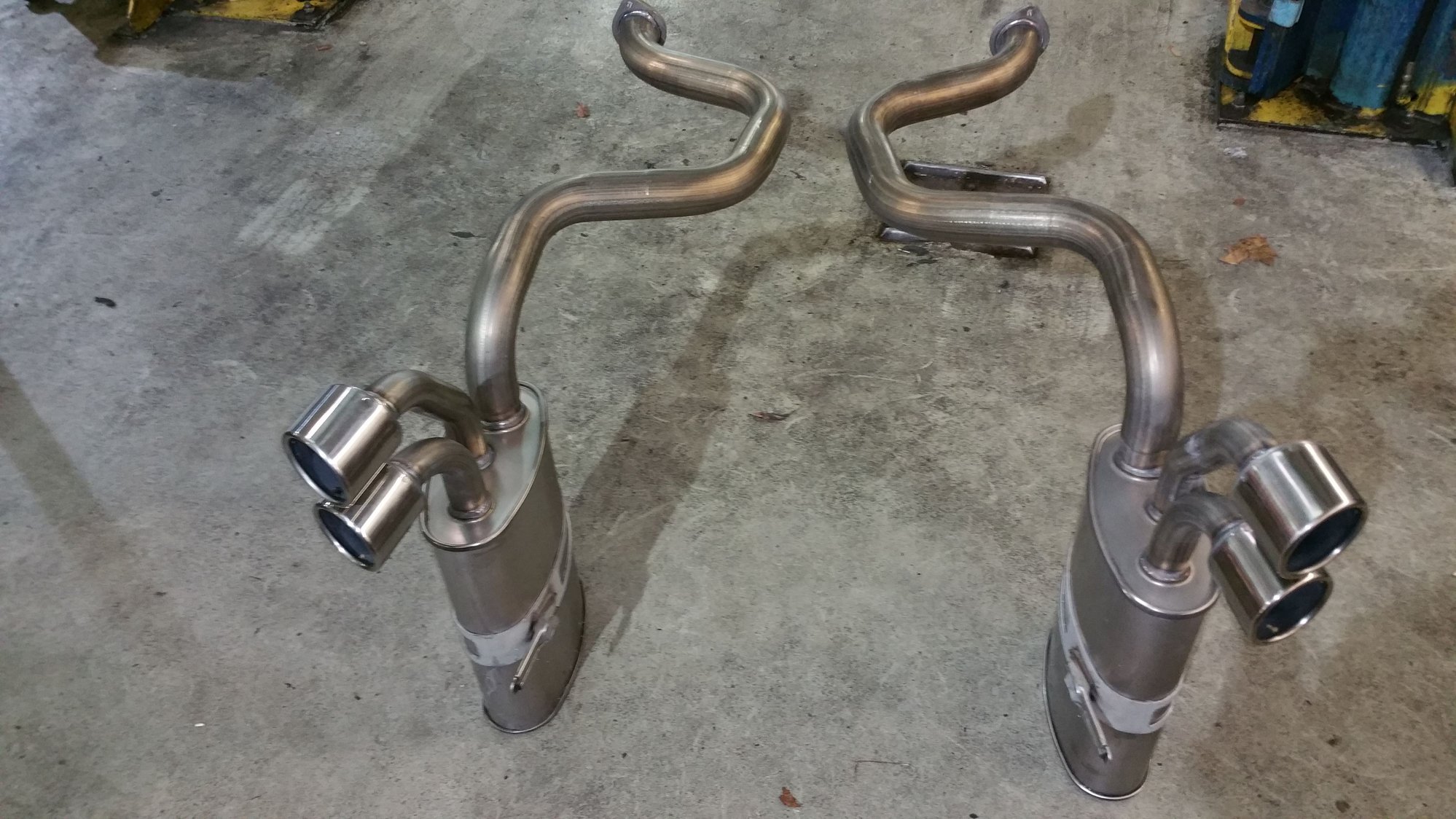

Factory Ti(tanium) with the Ti mod. With headers and other mods; perfect and cheap. The Ti mod is a bypass pipe that's welded between the two inlets into the Ti muffler, thus bypassing the muffler partially. You need a welder and a short piece of 1.75-2" Ti pipe for both sides. This will cost less than new systems, but more than the XS Chinese one. I bought two catback systems used for cheap, and SS will last foreverish. Two tip Stingers cost $250, and they were perfect. I also bought a Magnaflow syster for $500. Made money reselling both. Stuck with Corsa Pace Cars.

I just may luck out the daughters boy friend is a welder. Not tig. So I'll have to ask him if he could take something like that on.
If you had the Ti system I'd say maybe leave it alone. Sell it, buy another; almost a $ swap.
With a base system (standard aluminized steel instead of titanium) you can do the same, any welder or exhaust shop can do it for little money. And if you don't like the results, they're pretty much worthless, so sell or toss them if/when you end up aftermarket.

I see...do the "Ti mod" with the standard catbacks. Never heard of anyone doing that, but it's a great idea.
Well honestly I wondered why so many people cut apart the Ti system when:
-they are somewhat valuable/sought after
-the base systems are pretty much free
-both are 2 1/2" thru, so with a bypass should flow and sound pretty much the same
​​​​​​-any shop can weld the base unit
