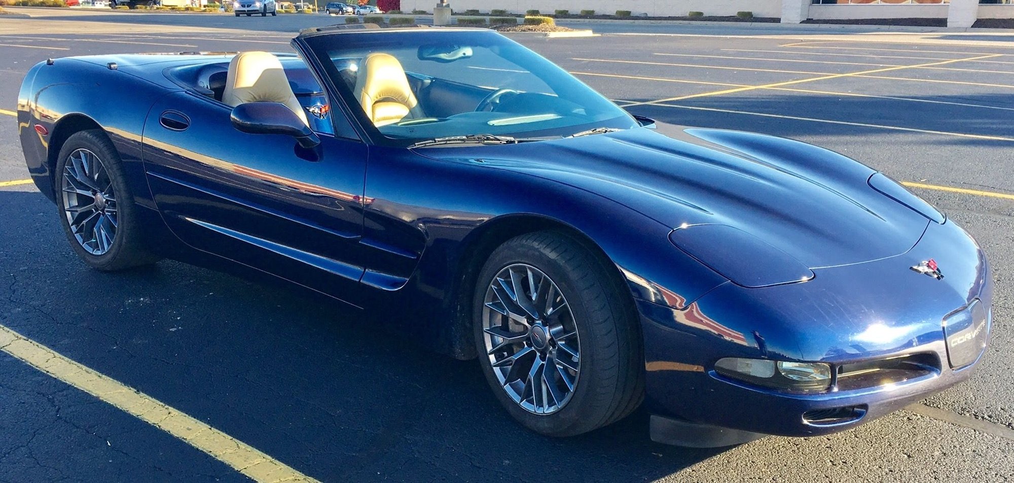

I bought my 2001 vert last year on its original wheels and tires. 33k on car. Lots of shaking in the steering wheel that I originally assumed to be 15 year old dry rotted tires.
I replaced the wheels and tires and the completely shot sway bar end links. I've checked over all other suspension pieces front and rear, no other visibly obvious issues.
Car still has a shake in the steering wheel.
This is my 3rd Vette so I know it's in their nature to f with their owner for no reason.
Any suggestions?
