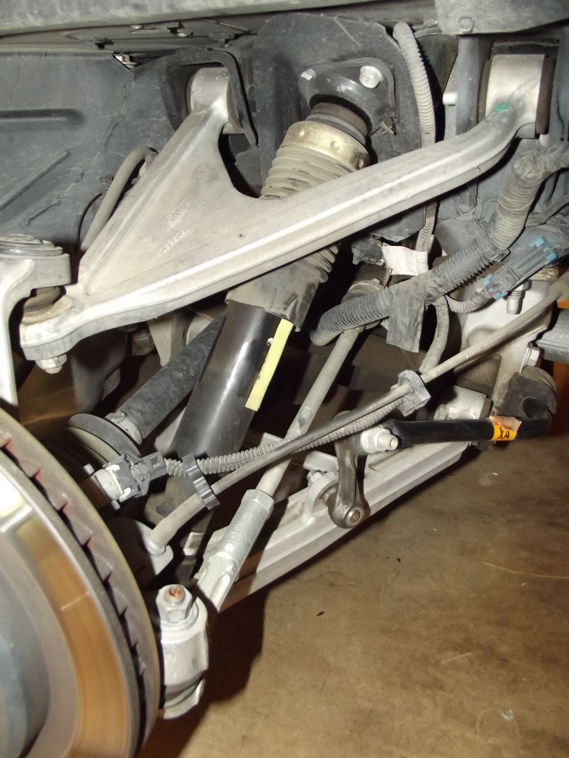

Under the car yesterday and happened to notice the "yellow tabs" hanging down out of the rear shock boots. The dealer who prepped the car for delivery failed to remove the "shock stuffers" installed at the factory for transport. The front ones had been removed which I had inspected when I first bought the car about 18 months ago and assumed the rears had been removed also. Have never been pleased with the ride over sharp bumps and now I know the reason why. Completely changed to ride of the vehicle and the magnetic ride control actually works splendid now. I believe 2003 was the first year this ride option was offered, so if you have a 03 or 04 with this ride control option, make sure you check your shocks. I guess this delivery prep was overlooked by a lot of dealers. You can search the forum on additional info on this.

Happened to me as well.
Bought my 03 last year with 27k on the clock, I am the third owner. Noted the harsh ride when I drove it home from SoCal to Oregon. Checked the shocks and all four still had the damn stuffers installed. Can't imagine that the two previous owners never looked at their shocks after experiencing such a harsh ride.
FYI,
TSB #022003 --
VEHICLES ARE SHIPPED FROM THE FACTORY WITH THE SUSPENSION TIGHTENED DOWN UNTIL JOUST BUMPER CONTACTS A TEMPORARY PLASTIC STUFFER IN EACH DAMPER OR SHOCK. THE STUFFERS MUST BE REMOVED DURING NEW VEHICLE PREPARATION. *TT (NHTSA ID #10002564, FEBRUARY 20 2003)

Well, I can only speak from my single experience on my 03 but the difference was nothing short of amazing.
Driving it home from SoCal up PCH the Vette felt like it had no suspension travel at all because it really had only about 1/2" of travel. Every single bump or change in the road surface felt like the entire car was bottoming out and the jolt went right up my spine. I feared the worst having read about the F55 mag shocks springing leaks and failing. But the car only had 27k on it and otherwise was in superb condition. I should have just pulled into a garage and checked the shocks but at that time I had not heard of the "shock stuffers"
Was so glad that all it took was jacking up and removing each wheel and there were the bright yellow removal tabs hanging loose. Just a quick pull and they popped right out.

Howdy AEG
No dinner required , just happy to help a fellow Vette owner anyway I can. Many CF members have helped me in countless ways over the last decade or so. Pay it forward.
Jim
This is what to look for.............
