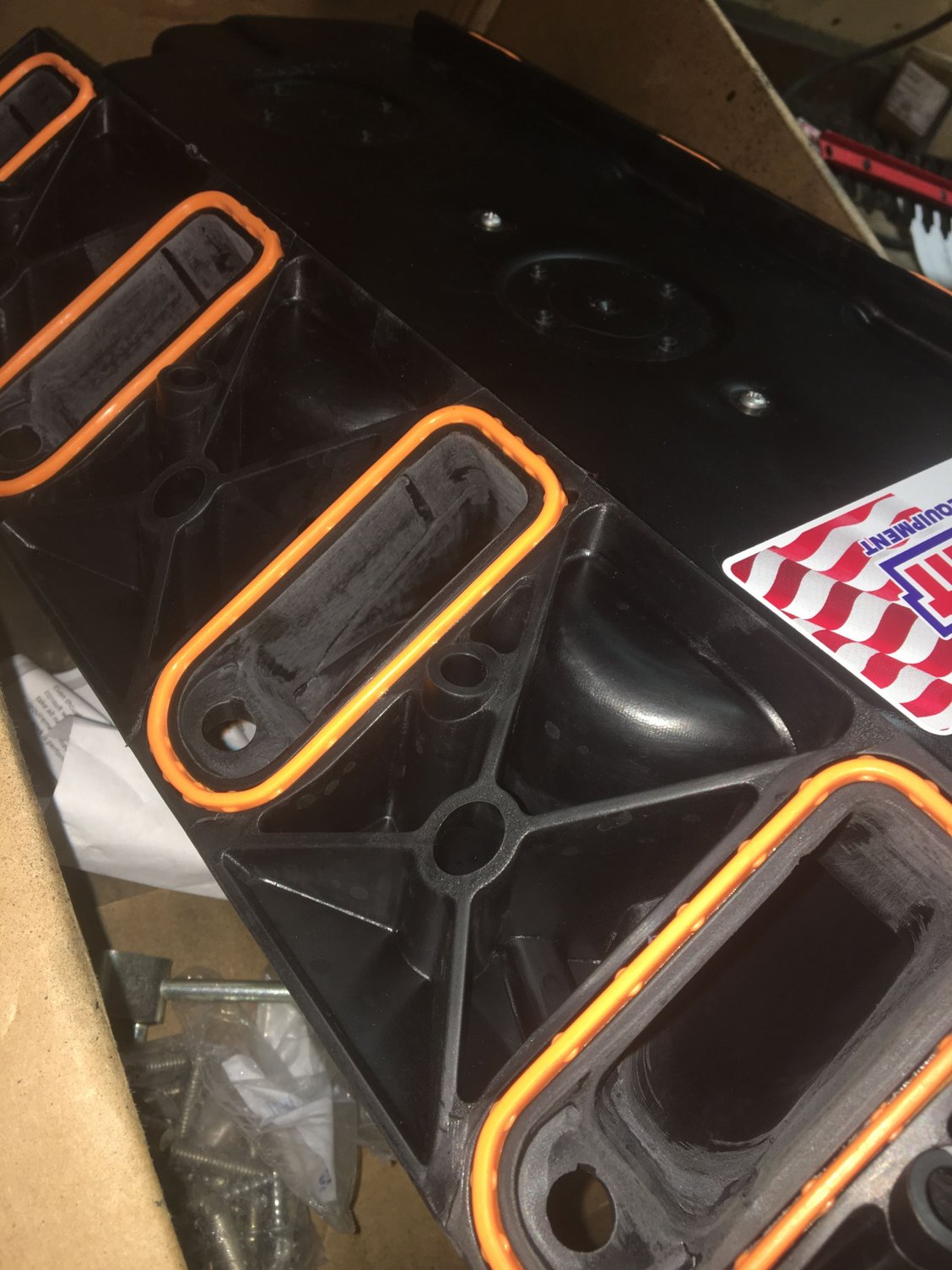

Got it in and looked it over, it's actually Made In the U.S.A.!
Anyway, yeah, the ports are pretty rough....even with an employee discount it was still pretty expensive, but way cheaper than a F.A.S.T. unit.
I wouldn't mind seeing a flow comparison with an OE unit though.

dorman uses a fast 78 version lower shell for this manifold . Lots of potential . Guys on ls1tech have tutorials on porting them . The snout is only 73 mm so that needs opened up as well to match your throttle body . The wedges need ground out of the intake windows . Summit racing sells these for a little over 300$ .. tgatvsure beats 900$ for a fast intake or 450$ for a used ls6 manifold that is twenty years old with the possibility of hidden stress fractures .

I went ahead and bought this intake . I smoothed out transitions and radiused all inner edges .i ported the flaws and wedges in runners and opened up the throttle body opening to 76 mm . Looks far superior to the ls1 intake ( much more volume.). I will be installing in the next week or two and will give my Sotp impression after.
