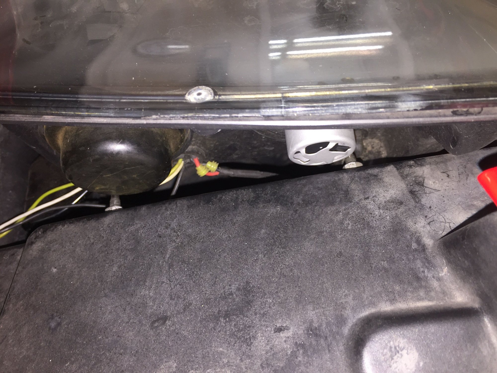

Here's a few installed iPhone pics and pics of the units themselves (via eBay)
They do stick out a bit from the rear:
Shitty frogeyes:
Passenger side:

The fans do make noise when the lights are actively running but nothing you'd notice while the car is running.
Not bad for $20 shipped.

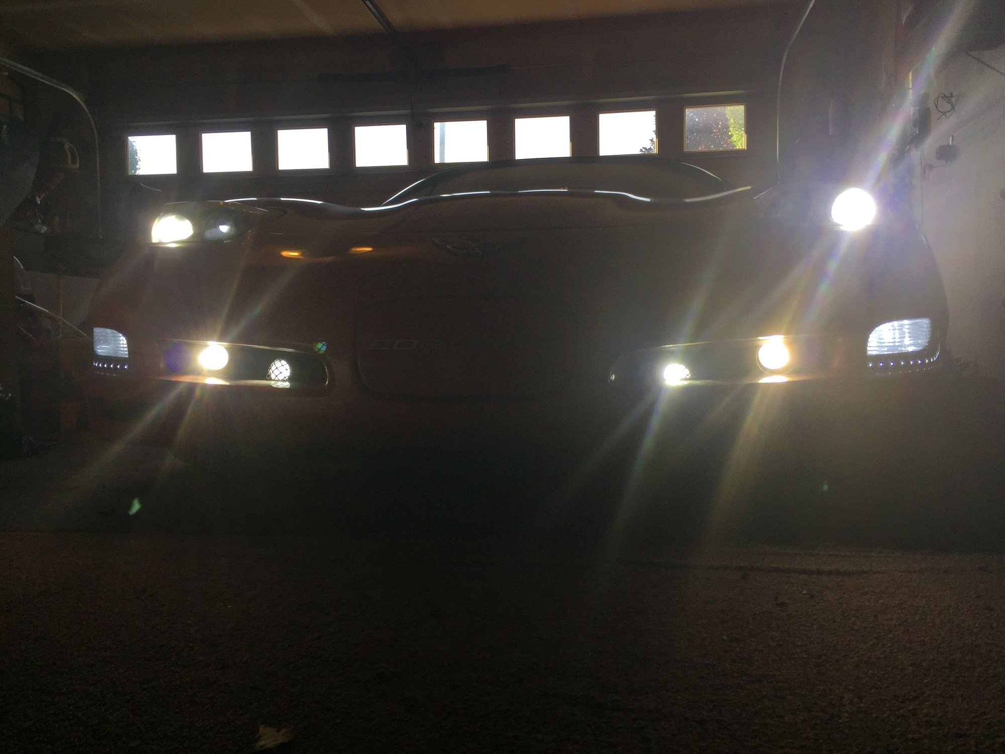

Anyway I managed to snap a pic last night which can show the intensity of the low beams but there is some reflective glare from the LED fog DRLs that I have wired to turn on with the headlight/parking lights and they cannot be turned off independently from the headlights...so try not to mind the extra scatter that is above the cutoff.
Here's another pic I just took with everything on. Stock projector fogs with hid kit, secondary led white "DRLs" (are inboard), white corner switchback LEDs with led strip & of course the new LED low beams as posted above.
Again the new led low beam light output is *excellent* I just hope they last a long time with having a motorized fan and all.
