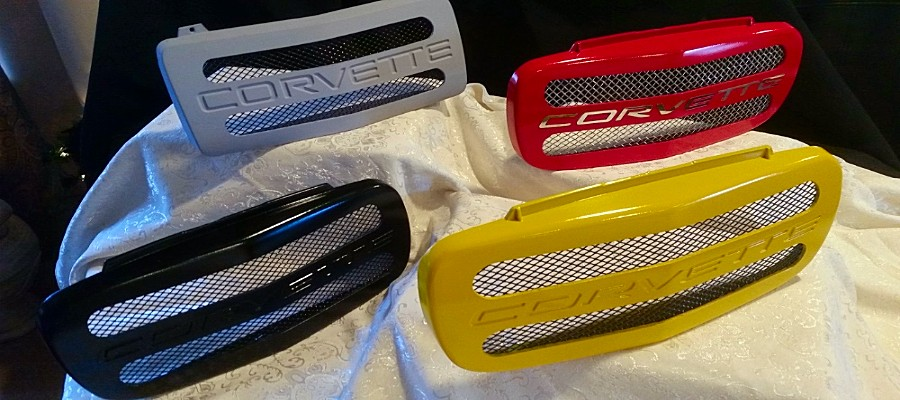

I like these the best to get air to the intercooler and therefore the radiator.
Do not remove upper cover over the radiator, it is there to force the air through the radiator.

^ Who sells those?

Originally Posted by AE Guy
^ Who sells those?
http://www.corvettesolution.com/

OK everybody. Thanks for all the advice. I'm going to go with drilling out the area at fog lights. I'll drill at top side since it is curved and let the bottom side scoop the air up and in. And since I still have the original plate cover (had it stored all these years and is the right color) I'm going to cut it out (have someone do it that is good with that kind of fabrication) and add screen. If I get stopped I'll just put the plate back on. I don't remember ever being stopped years ago. Anyway, I'll go from there and report what happened. That place that sold them already made was nice, but $185.00 was crazy. I don't care if it said corvette. My car says corvette. I'll let you know.
