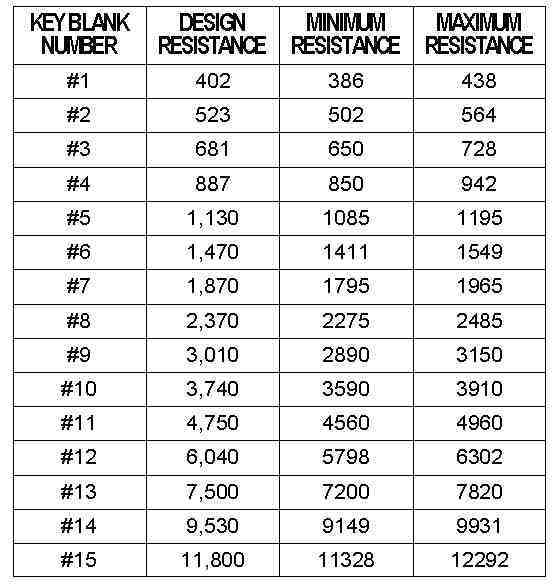

My '02 vette came with only one key and key fob. What would be the best process to get an extra key and key fob remote?
Old Jun 21, 2017 | 12:01 PM
ArmchairArchitect's Avatar
ArmchairArchitect
Banned Scam/Spammer
Joined: Sep 2016
Posts: 4,004
Likes: 3,929
From: Philadelphia PA (Birthplace of the USA, UNESCO World Heritage City)
Ebay....new fully functioning aftermarket keyfob is around $7 shipped. And then you can program it yourself.
As for the key, you need a multimeter to measure the resistance (ohms) on the chip portion of your existing key. That resistance will correspond to a "VATS" number (most ebay listings have the VATS chart to look it up). Then buy a blank key for $9 shipped on ebay (make sure to get a key with the VATS # that corresponds to your existing key) and have it cut at the Chevy dealer.

VAT Key Codes and Resistance Table
