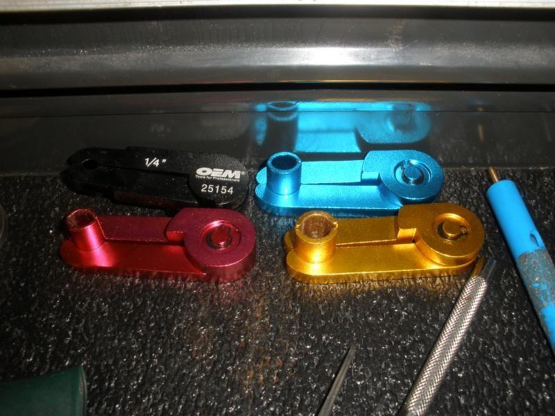

Do you have these removal tools? Not sure which size will fit off hand.
