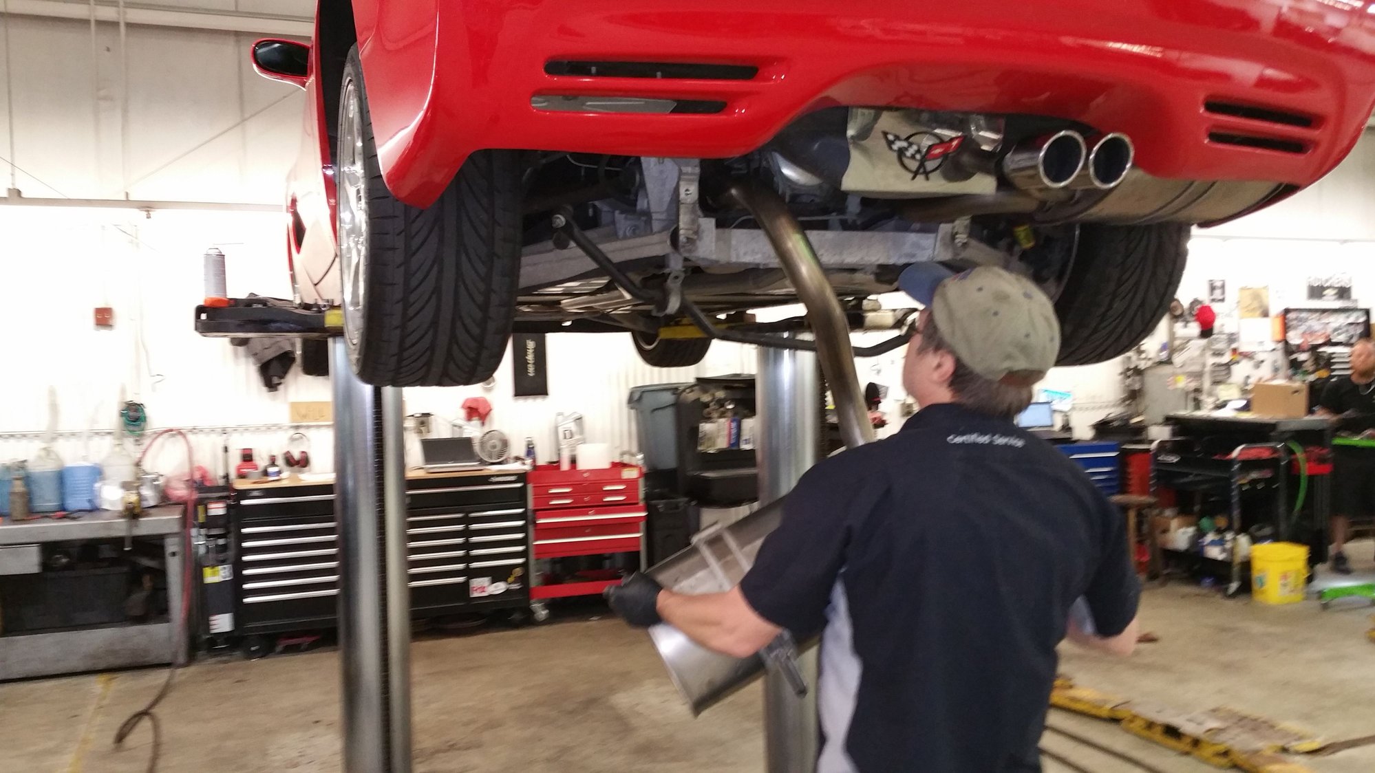

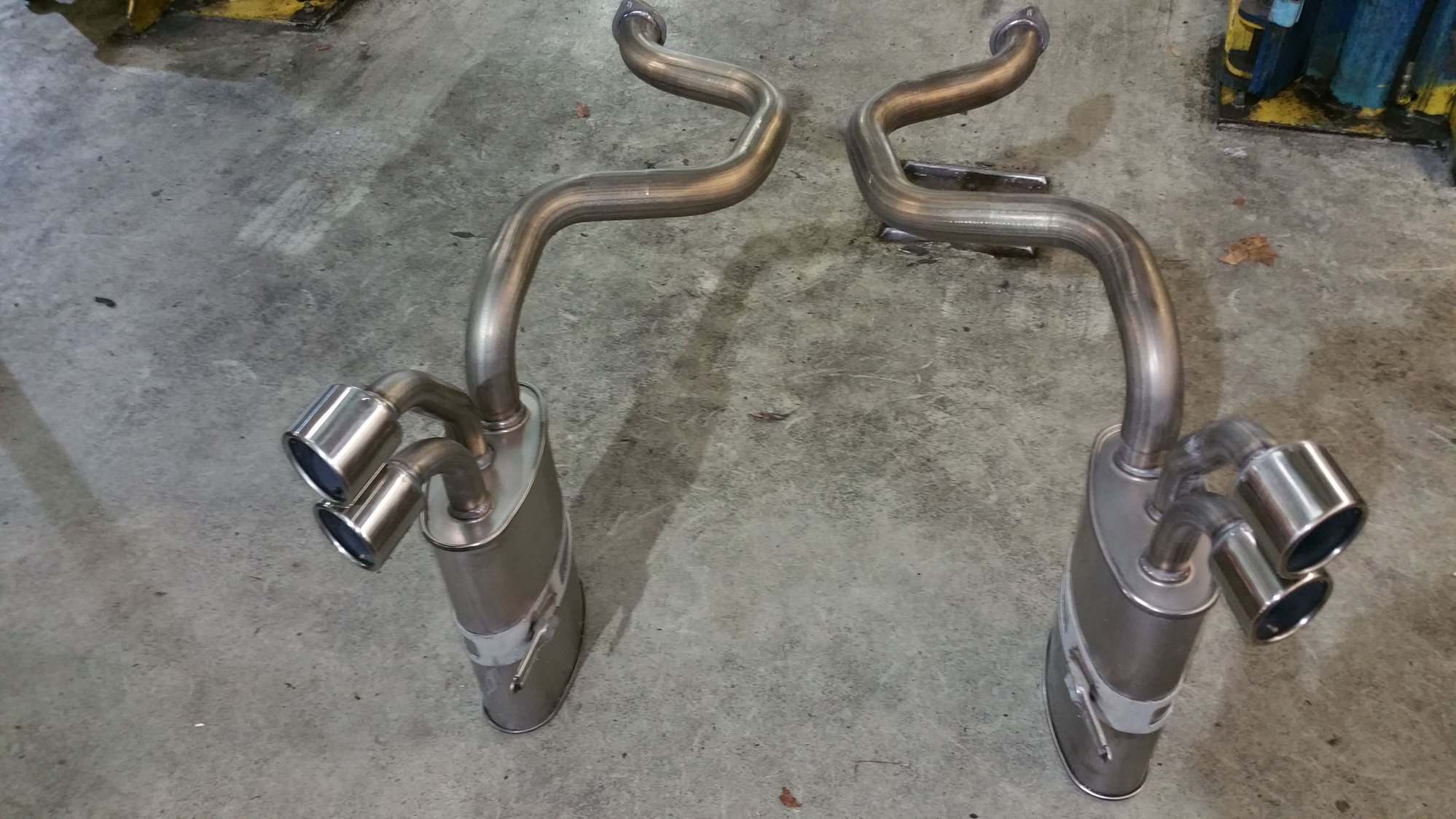

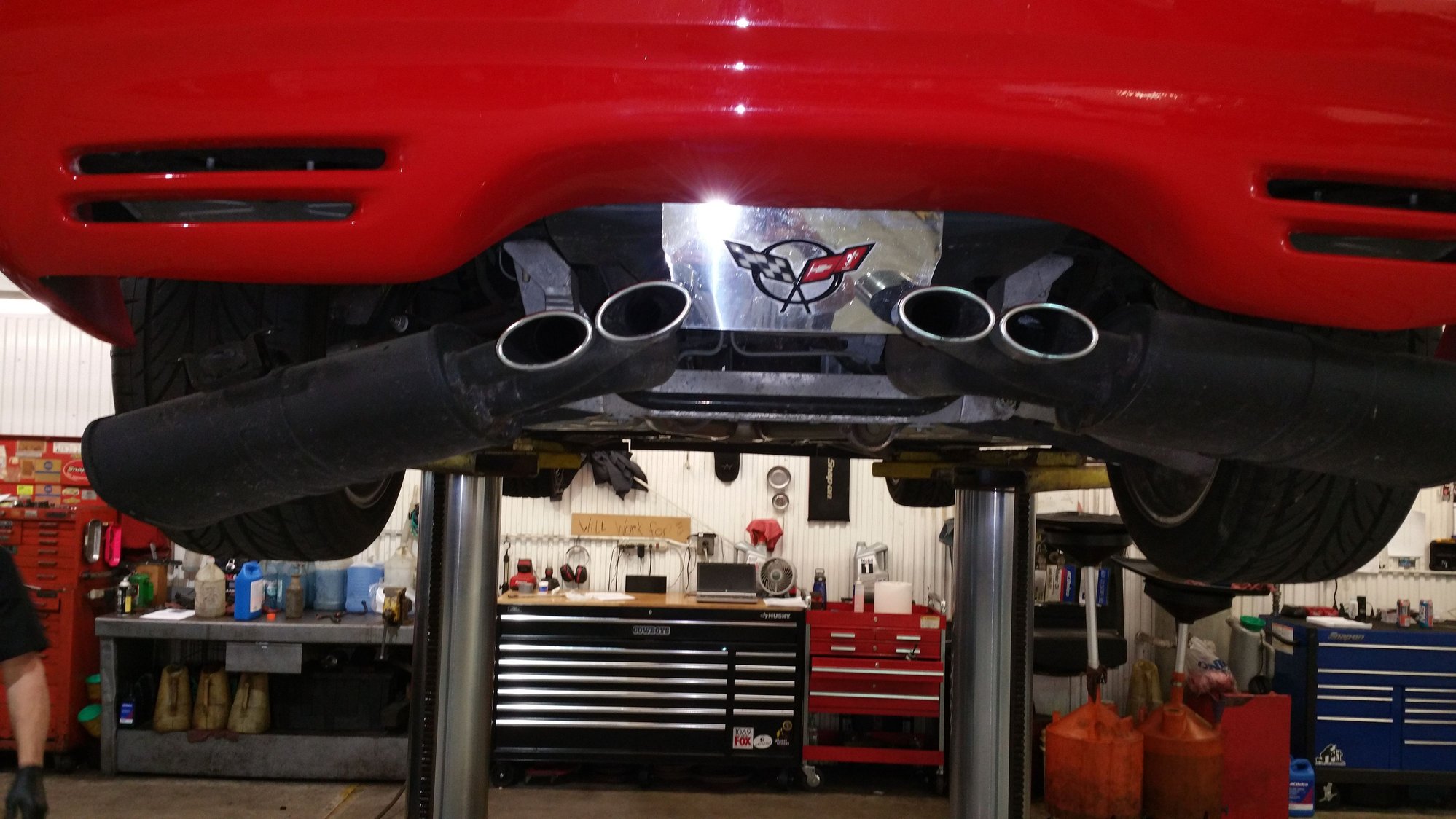

Wasn't worth my time...took it to the Cheby dealer and for $68 they did it in 30 mins...it took a lot of twisting even up on the rack...glad I did not try this at home...especially with the new Ti unit from a Z06...eh...
Original Z06 Tis with 11K miles...off a garage queen
