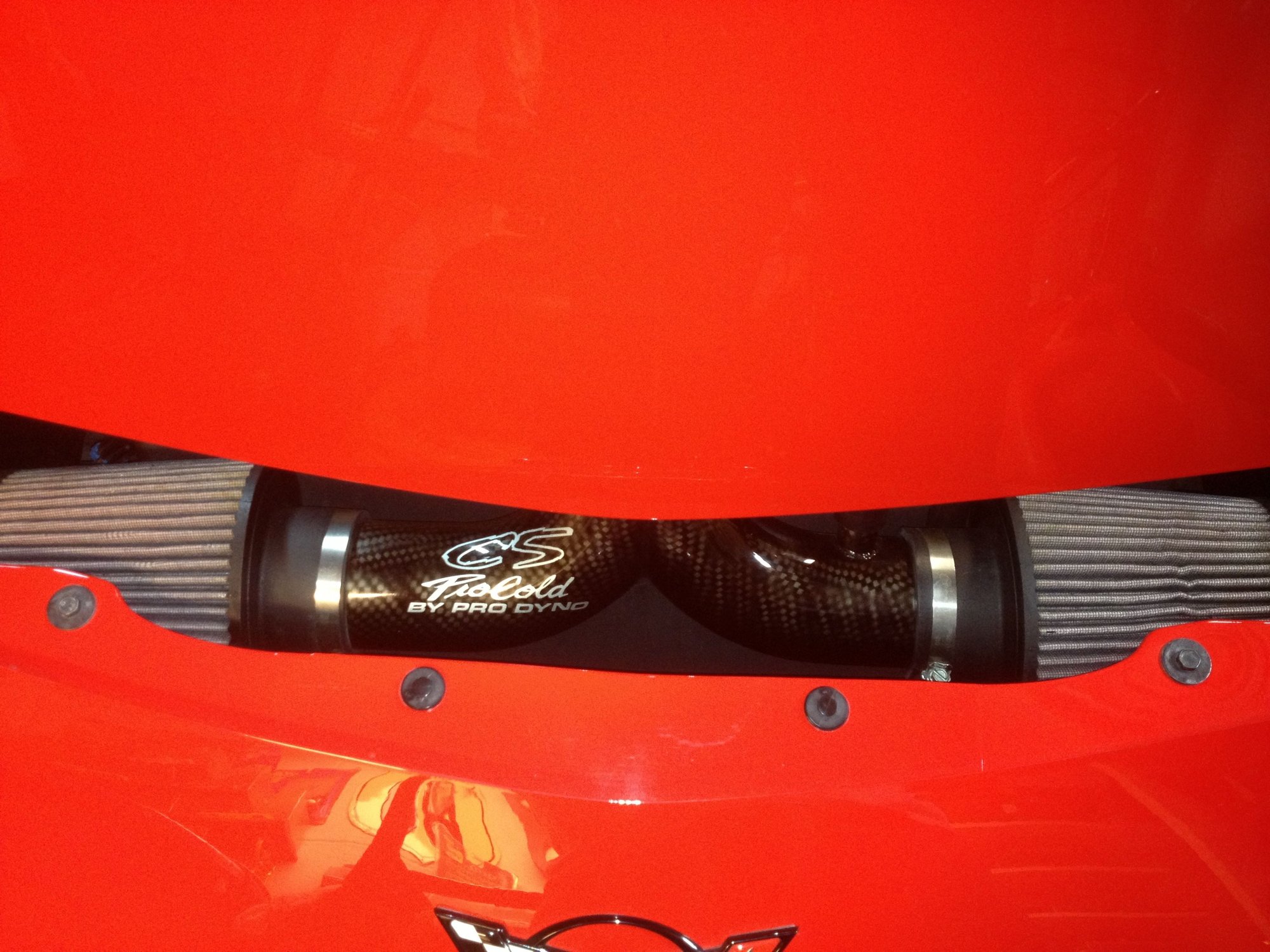

I'm here to learn so preach on!! They changed them in the 01-04 models, still, I've read where the C6 box is a good upgrade. I've got a Vararam on it now and they are junk as far as fitment is concerned. If you tighten the hose clamps up good and tight, it collapses the plastic tubes, that and the air filter box itself doesn't fit very well either. They claim to have improved them, but in my opinion they went to market with them way too soon and were way over priced for as junky as they are. They should have used better plastic instead of the budget stuff......way too soft and squishy.
This is what i put on my car in early 98. At the time there was not a lot to choose from. It is an improvement over stock. These are life time K&N filters and they are 19 years old. I have gone too the LS6 intake, LS6 MAF, larger tunnel ram over the rad. and B&B PRT cat back exhaust and a tune with a cooler thermostat.
That is really what I'd like to do. I have the Magnaflow exhaust. My car runs good. I can't beat a C6, but I can hang close...kinda like a stock C5 does against me. I expect a little power loss with a change to the stock intake, but that's O.K. with me.
