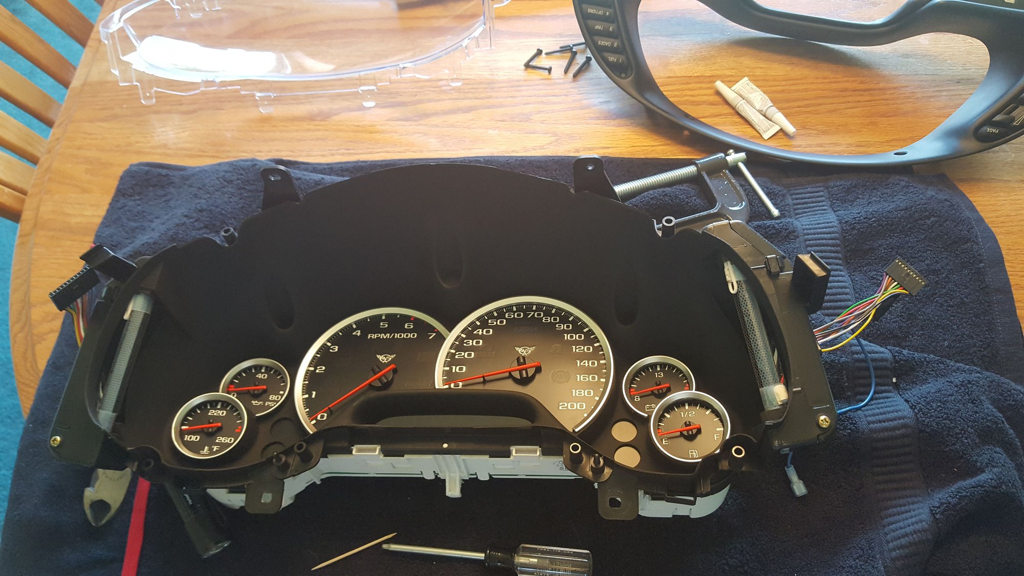

Glued with Gorilla glue and ready to go.

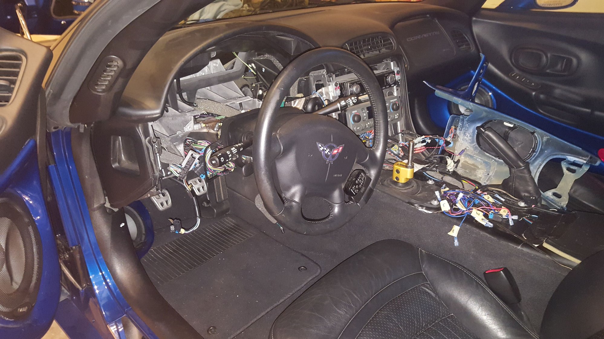

Car ready to be put back together.
Mostly put together, just got the center console to put in (which isn't easy with all those connections)
[COLOR="blue"]
Looks good!
What's the C-clamp for?
Old Jul 26, 2017 | 01:01 PM
knewblewkorvette's Avatar
knewblewkorvette
Joined: May 2003
Posts: 14,137
Likes: 2,984
From: Iowa
Originally Posted by unlvrebel
Looks good!
Thanks
I used it as weight while the glue dried

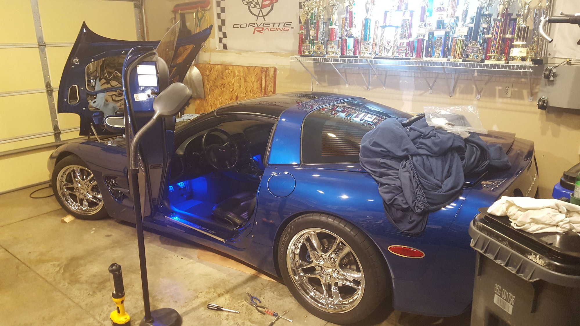

Got everything back together and speedometer works, all the LEDs in the gauge cluster work
BUT...
Now my hood LEDs don't work, the under seat LEDs don't work, and the just the driver's side foot well LEDs don't work, passenger side works fine. WTH? I know what I'll be doing the rest of the day
