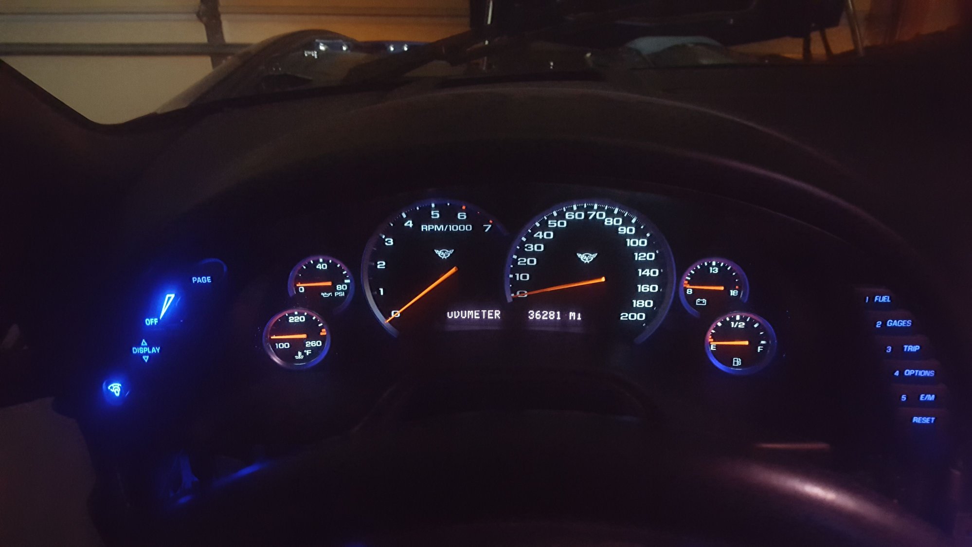

Not sure what you got against LEDs as they do last longer, they'll out live the car. The gauge cluster light bulbs are not hard to change, but you have to do allot to get to them. I just did mine this winter but change to blue LEDs.

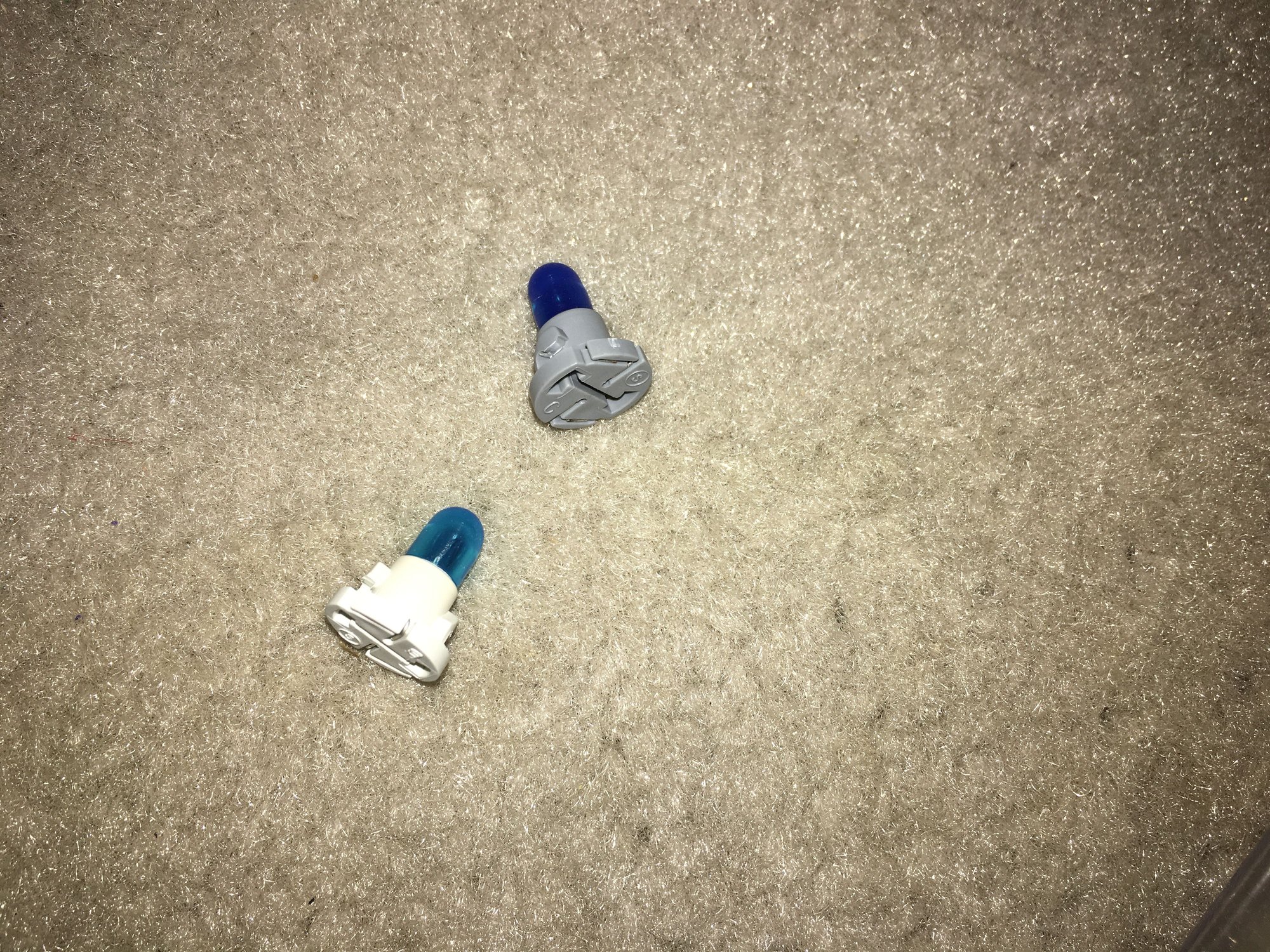

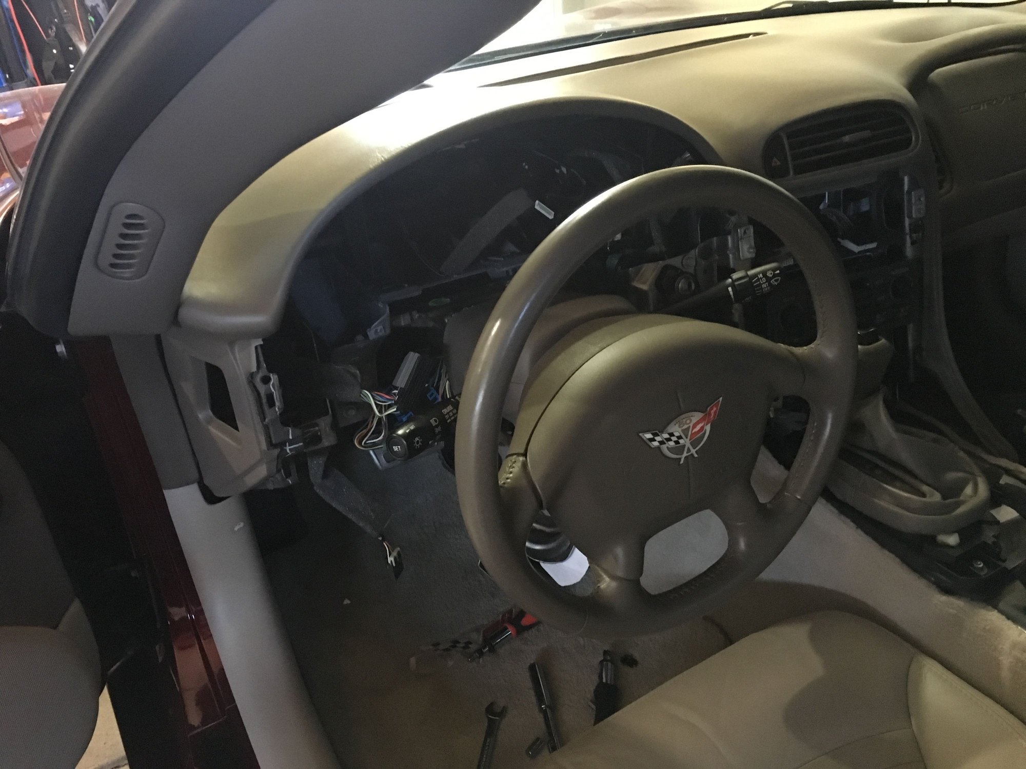

Well for me it went something like this -
This -
These -
Then Finally, this -
Like blew says, you have to do allot to get it done. But well worth the effort in my opinion.
