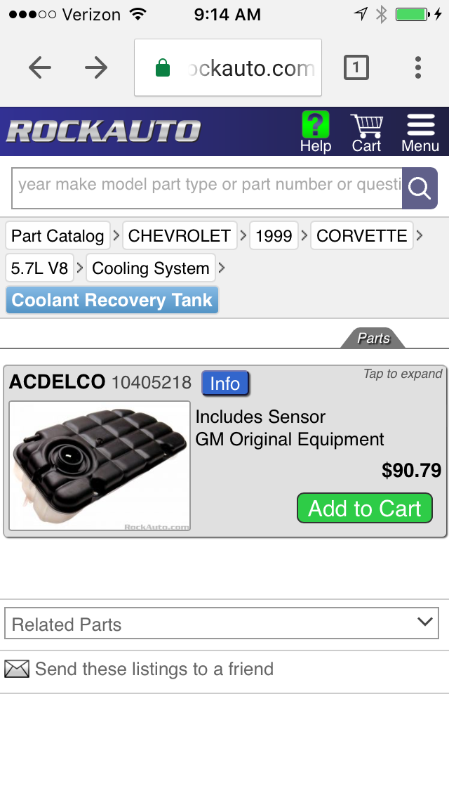

I think the Dorman will work, just jumper that harness.
Or for 90.79 plus shipping rock auto has the AC Delco tank with sensor, maybe I should just get it.
Yep...unless you want to do what I did and save $50 by opening an Amazon Charge card no fees involved and get an automatic gift card for $50...it makes $ sense
