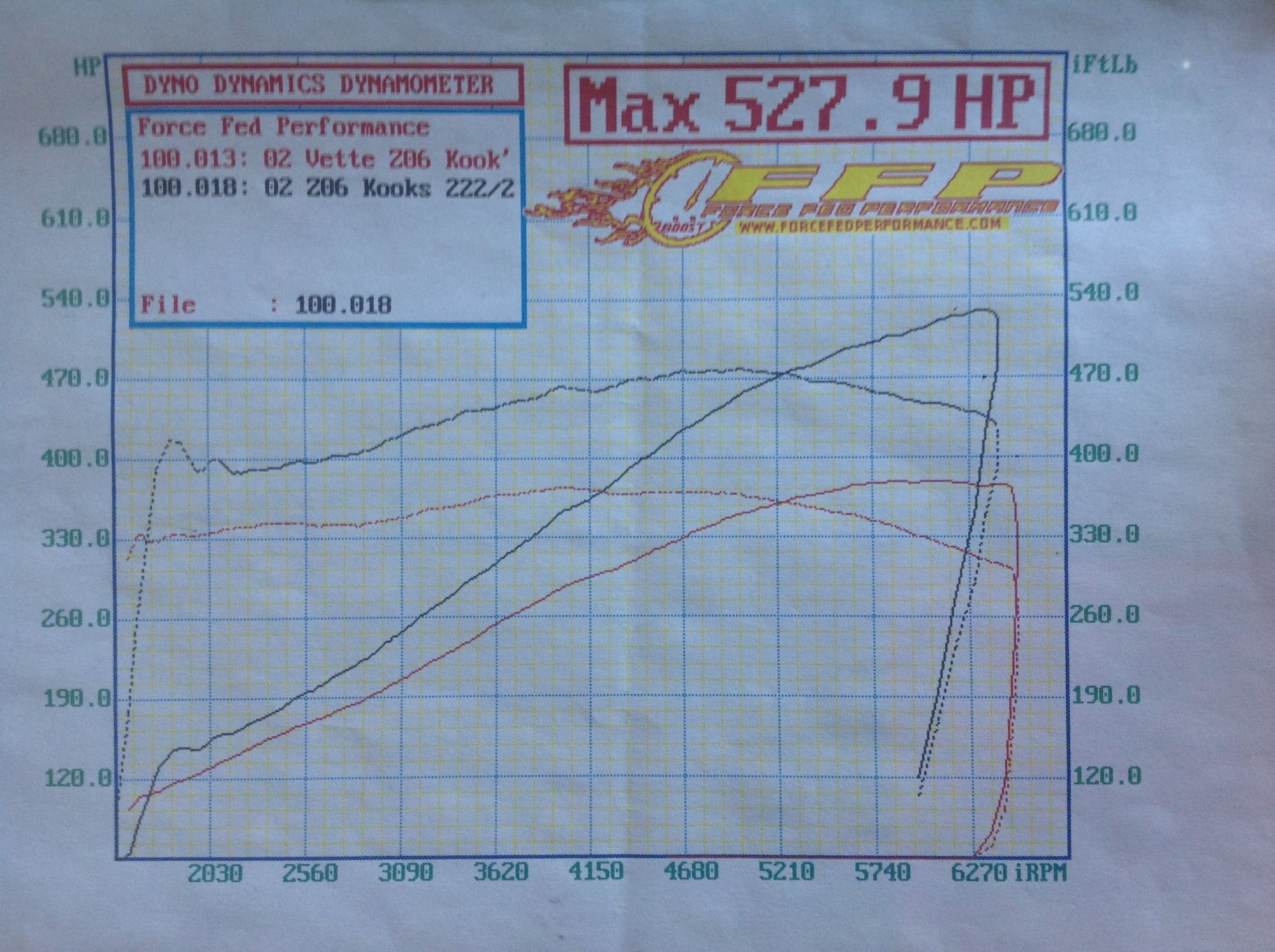

Are they in HP or WHP ?
Got a sheet along with lots of paperwork on A new to me car.. It's from the shop that did all the mods to it.. But not sure what it relates to in terms of power reading?
Thanks

most likely whp. Upload it

Here you go.... Thanks

must be supercharged. Looks like a good graph.

yes its supercharged ... bit confused by what's on here... what is torque figure? and is this WHP on the graph?

looks like the red lines were pre supercharger and the blue were after. Torque looks like just over 470. Yes it's whp. Looks like a fun car. Just make sure you a/f ratio is in check.

ah OK Cool thankyou.. guy said it was 600hp so it must be about that.. to be fair I'm happy with it.. and over here in the UK you do not get these type of things on the road! ..
when you mention about A/F that's Air / fuel ratio ? .. how do you check that out?

If it's making 528 at the wheels then yes that would equate to roughly 600 at the motor. These cars have a roughly 15% driveline loss. 1.15 x 527.9 = 607.08.

thanks for that... good to know.. gone form bolt on auto 99 C5 maybe 390 area.. to this!!! is pretty mindblowing
