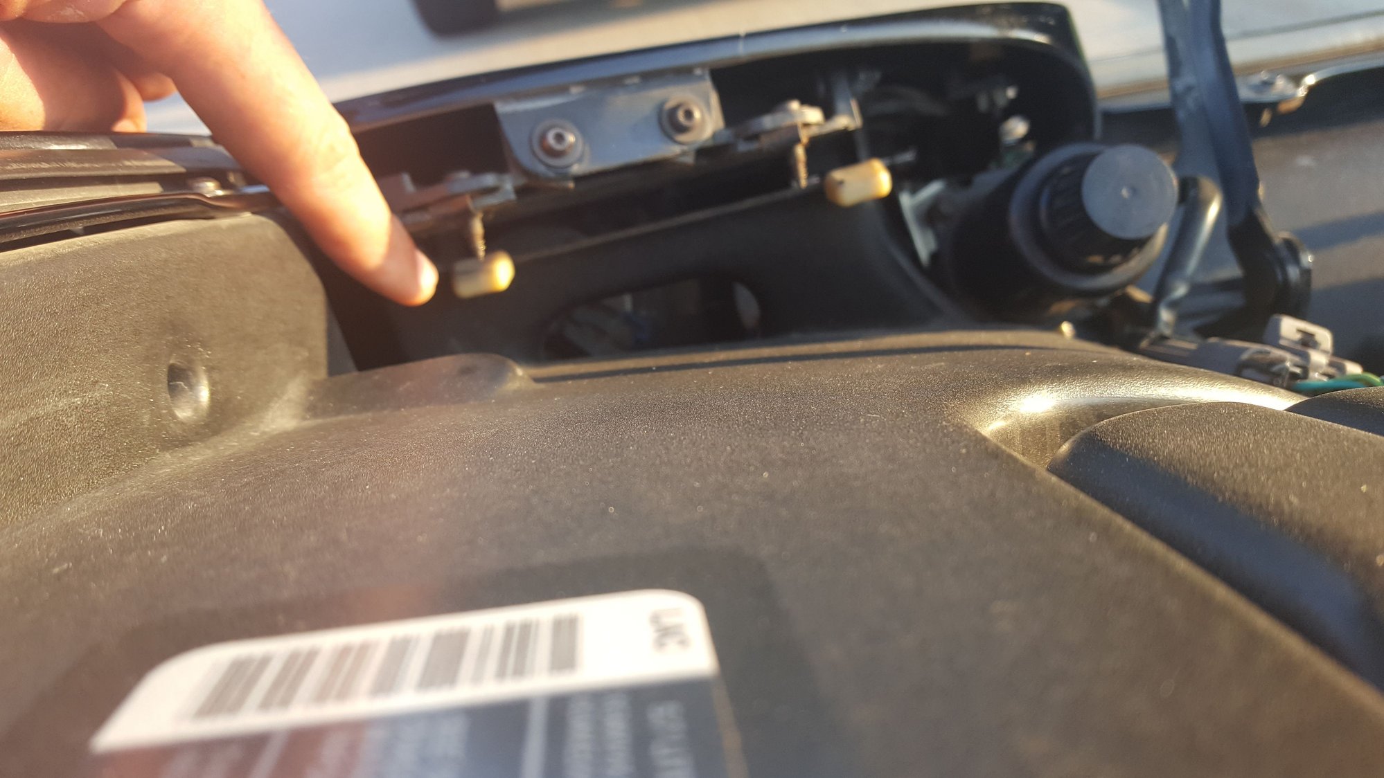

Anybody got a picture of these bumper stops? Are you talking about these?
Yep - those are them...there should be four of them. You can get them at RodneyDickman.com

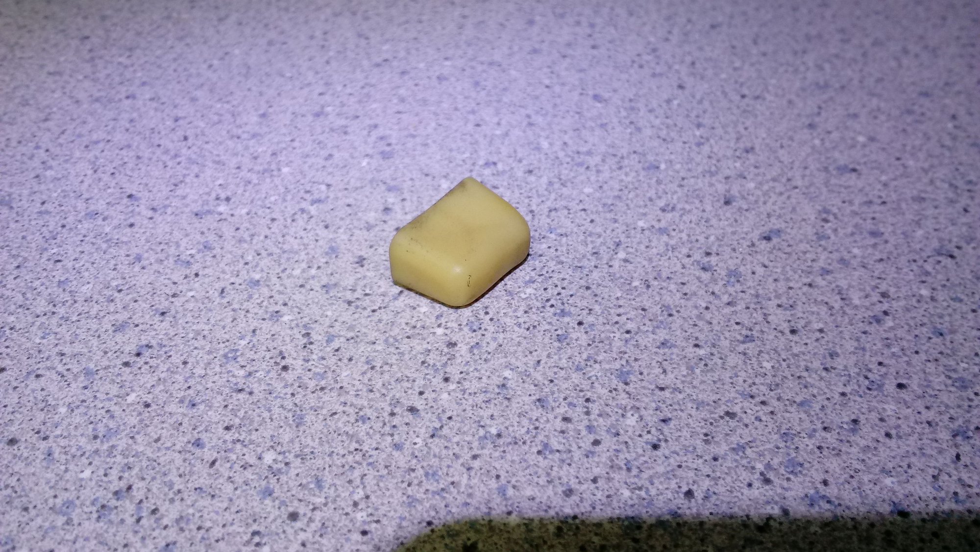

Rodney ships fast, got the four new bumper stops in 3 days. He also was nice enough to send the requested instructions on how to remove headlight assembly. Lucky for me, I didn't really need them because once I got the plastic headlight cover off (the one held on with 3 phillips screws), I could reach in there and grab the one bumper stop I could see with a dent in it. I could have just flipped it, but it fit loose. So I put a new bumper stop on (it fit tight) and plugged the headlight back in. Voila, headlights work as they should now.
The indentation was less than a 1/8".
