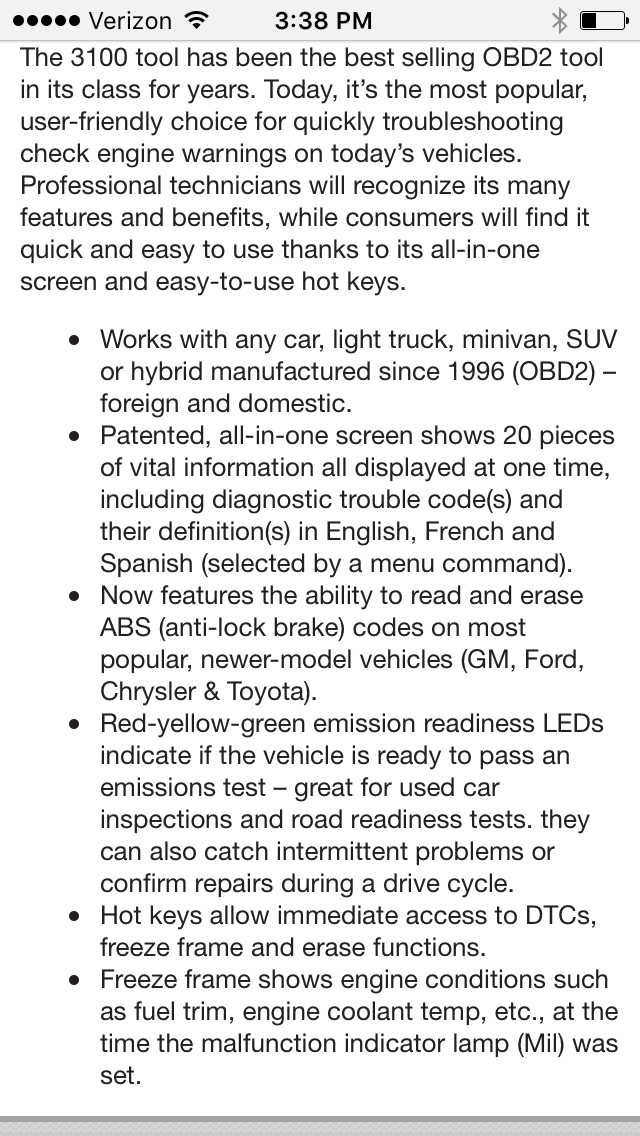

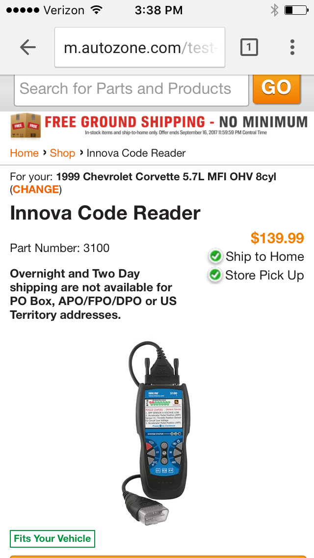

Can use this tool from autozone's loan a tool program, buy it then return it. I like the idea it tells the OBD2 Ready status.

I ended up buying a new battery at Costco, a Interstate 1000 amp 800 CCA and 110 reserve capacity, exactly the same as the AC Delco.
82.99 plus tax
Then got that scanner at autozone.
Will try it out.

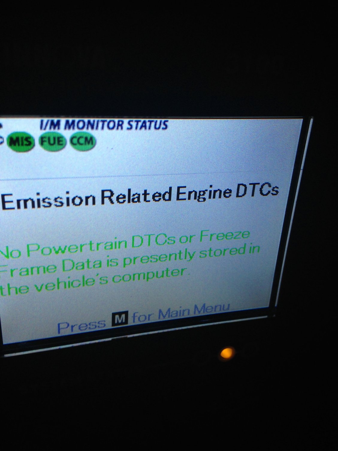

So it pulled the same code and had a red light, cleared code now it shows a yellow light.
Apparently green light means ready, yellow means not all systems ready, and red means a fault.
I will put in the new battery and try driving it tomorrow and see what color light it gives.

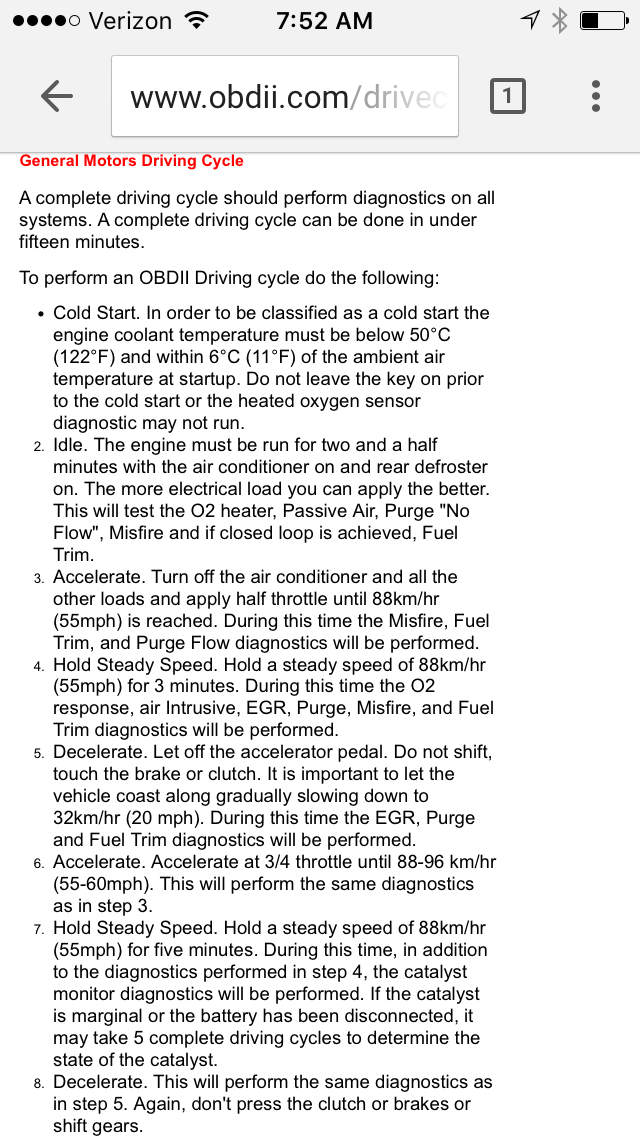

Dropping from 55 mph to 20 mph by coasting in gear sounds like a bad idea unless there was a place where other vehicles would not be driving.

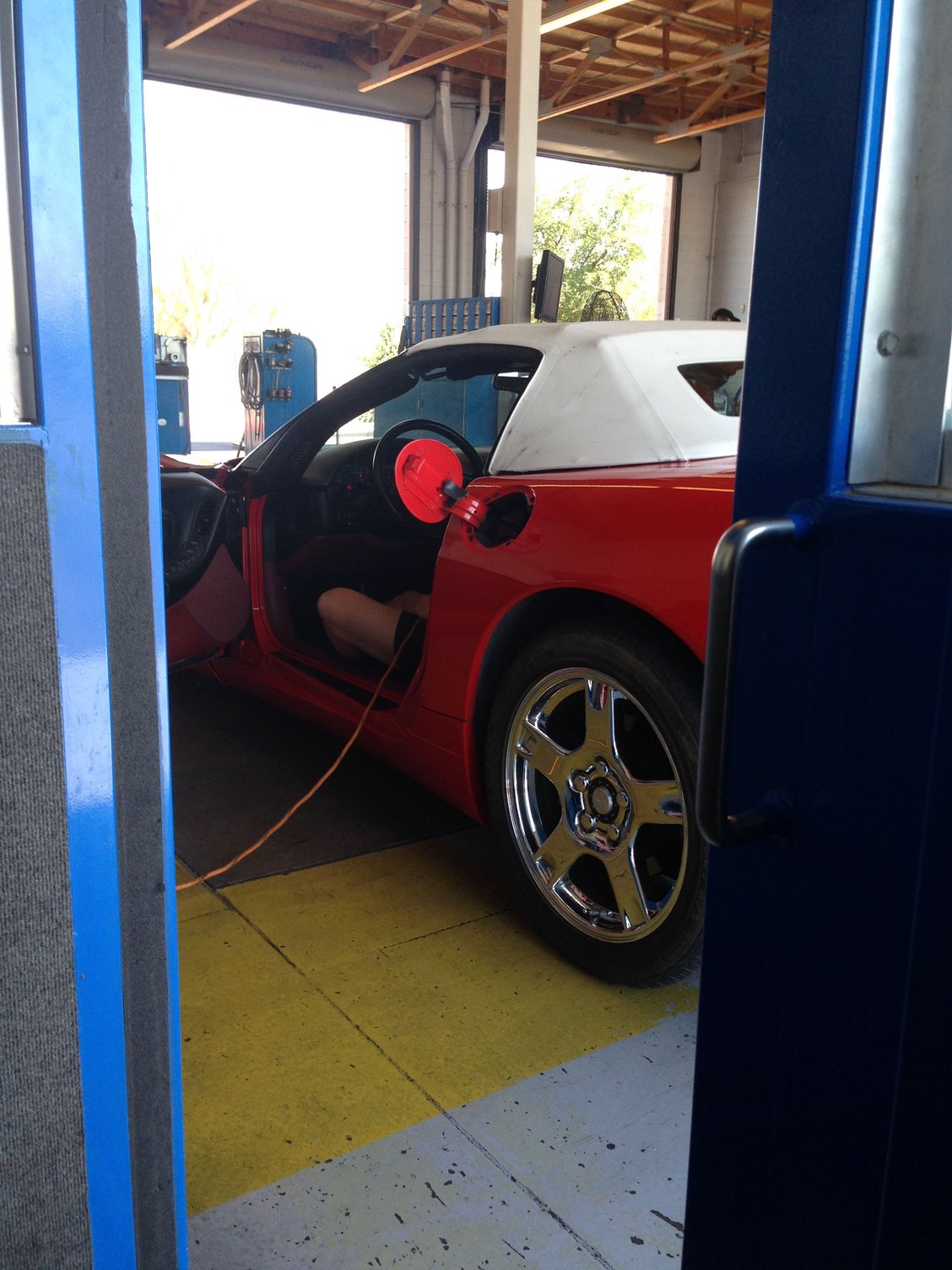

So it failed the OBD test as it wasn't ready, they didn't charge me, and gave me the option of pulling into the roller bay to do the tail pipe sniffer test.
I did, 2 people had trouble trying to get it going, grinding my gears and stalling it, then another person asked if it had traction control and I said yes and turned it off for them.
They raced it for a short time and then tested the gas cap, passed the sniffer test!

This was in the bay where they do OBD test.
Took video of car on rollers, but don't see a option to upload a video.

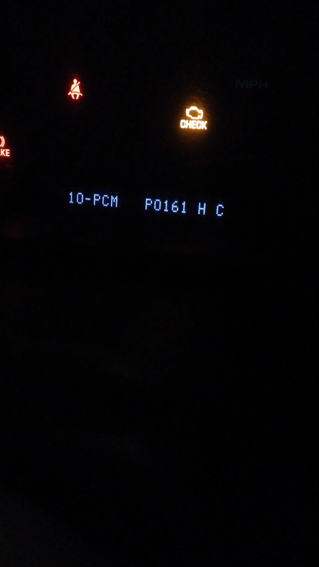

So I charged A/C on Saturday and took my gf for her first ride, then on Monday cycling the distilled water through the block and radiator I tried turning on A/C and the light on button flashed again, probably leaked out after 2 days, have yet to put gauges on it.
Tonight took gf for 2nd ride, only with top down, gas tank full, topped off on Saturday'a ride and gauge read 3/4 as I was backing out of garage.
It then went back to full, check engine light came on.
Going to go pull code now.

So, I guess it's that oxygen sensor after all.
Will hurt to drive the car on my road trip like that? I want to fix it but not sure I will have time.
Will it make the car run rich?

The engine will most likely not be as efficient as it should be when its in closed loop cursing.
So, YES, it will most likely be richer than it should be. Use the scanner and look at the O2 sensor PRIMARY Bank 1 & PRIMARY Bank 2
Compare the outputs of both sensors. If they are both oscillating high low high low,, you will most likely be fine.
If the one with the failed heater is cycling less, then it cant properly do the fine tuning on the AFR for that bank.

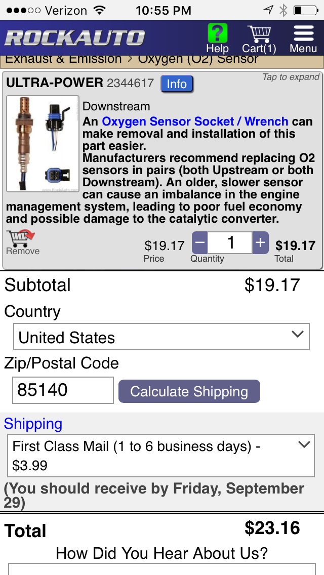

From: Chandler AZ
I returned that scanner to Autozone, it was the loan a tool program.
Should I still feel to see if the sensor gets warm with key on and other tests?
Found a cheap sensor at rock auto for about 1/3 the price range at autozone.
