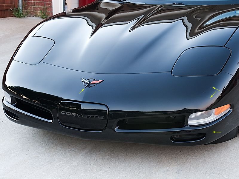

Not sure there is a "definite" answer as time depends on so many factors. I will say that I applied a clear mask to my front bumper and headlight covers on my factory paint after a few years. One of my headlight masks got a minor scuff a few years after that and I decided just to remove the headlight masks and recover with new material and the removal process destroyed the paint on both headlight covers - so bad that they had to be sanded down to be repainted. We tried everything from heat gun, steam to at least 8 different solvents (including the $30/can 3M adhesive stripper) to get the adhesive off the paint after the film was removed and nothing really phased it. Took almost 8 hours to get it off the headlight covers.
I am sure it depends on the brand/type of mask you used, but mine was 3M and I would say it was permanent in my case. Bumper still looks like new after about 10 years as a DD. This shows mask applied to all 3 panels...
