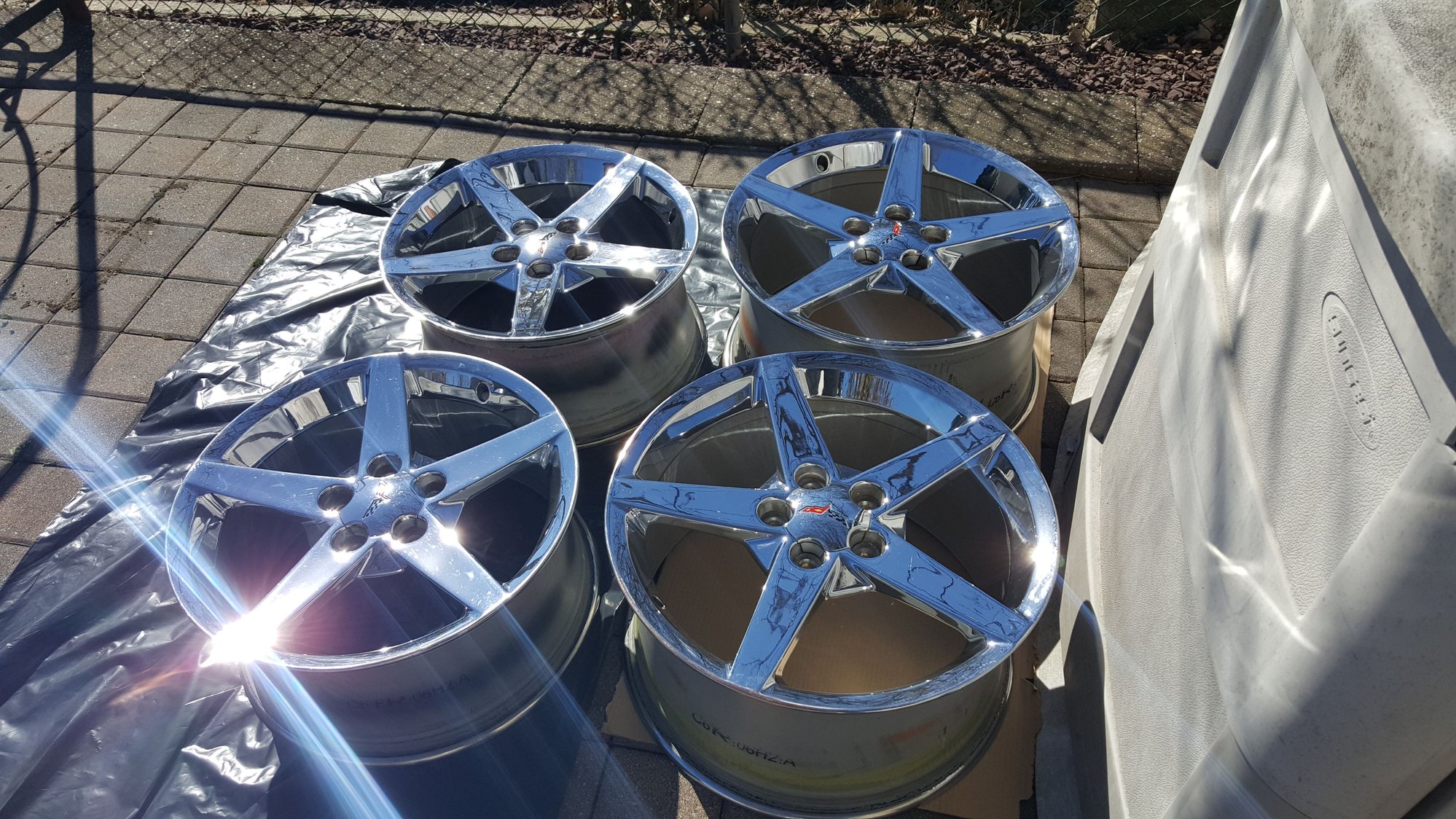

I just got these C6Z ones. I like the C7 cup style a little better but $$, Trying to keep my car in budget.
