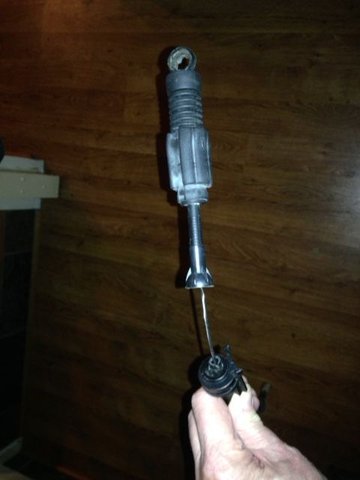

Here is what happens when you bend it too far

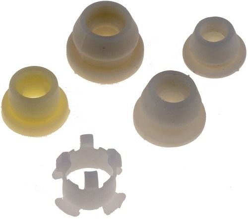

Yes indeed. Mine broke at the shifter end like yours, but I changed both as a preventive measure. I'm glad I decided to do that because the other end's bushing basically disintegrated when I tried to remove it.
All you need is the
<b>Dorman 14057</b> Dorman 14057
kit and it costs just a few bucks. Use the white bushings (the orange ones are for Ford):
And
shows you how to do it.
Dorman 14057 is an exact replacement and includes 2 bushings to replace both ends of the cable at once.
Dorman 14041 is an assortment, and only 1 of them is the right size. To do both ends of the cable you will need to buy 2 kits.
