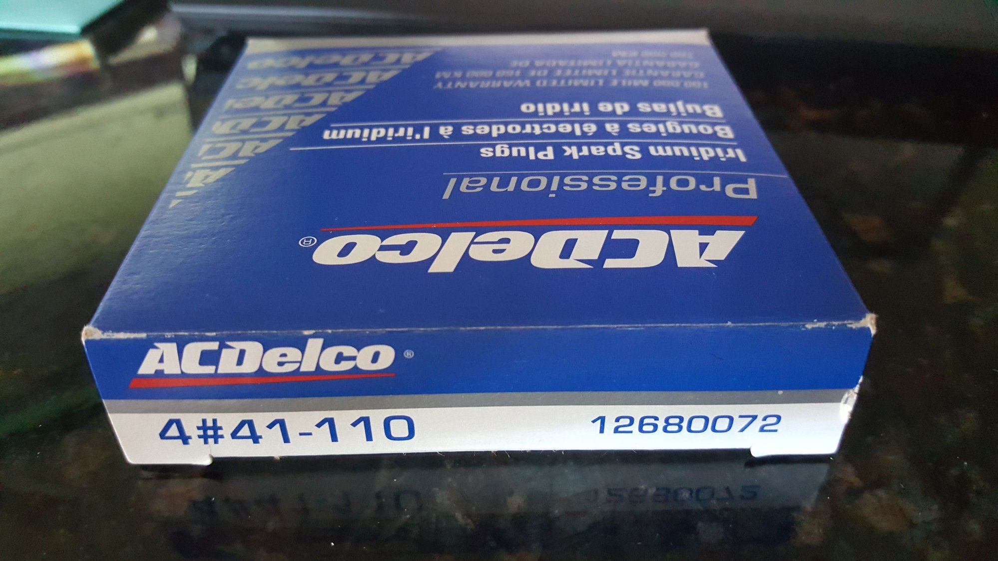

Just ordered these from the guys over at CULTRAG Performance - they were super helpful and got them to me in 2 days. I got the wires from them too - if you need more info - just PM me.

OEM spark plug is AC Delco 41-110 Iridium, pre-gapped at .040
11 ft. lbs torque, and a small dab of anti-seize on the threads.

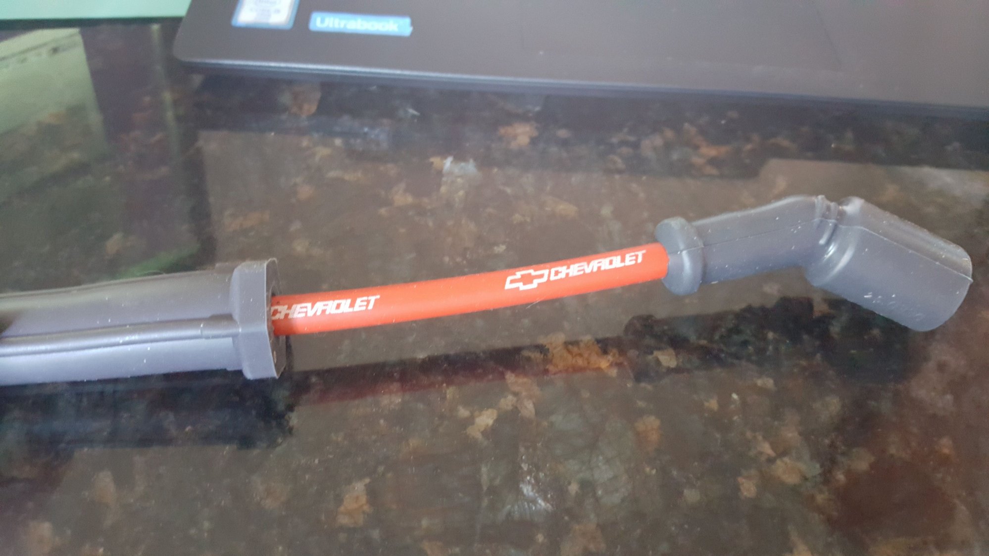

Red wires? All the ones Ive seen are black. happen to have a part number?

They are GMPP wires. Here you go:
