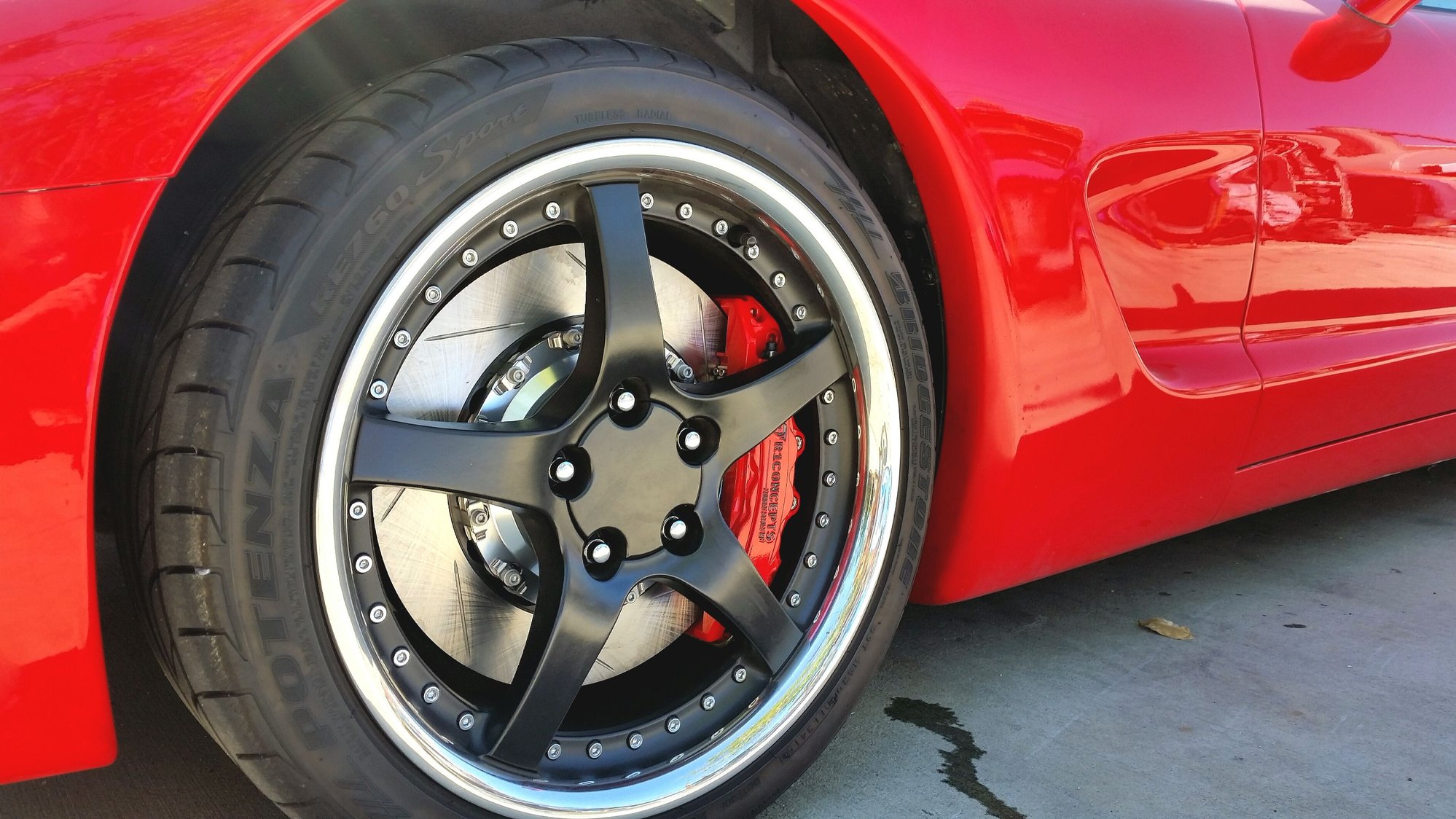

R1 is owned by family, but they really did design an incredible BBK. Martin gave me **** for using a Stoptech kit on my mustang but decided to give their kit a shot on the vette and I'm glad I did. Easily the best BBK I've used at the price point.

Nice brake set up. They look expensive.
I went the cheaper rout. I just wanted better street brakes that might see the track.
I ordered the one piece rotor kit. By the time they wear out, carbon ceramic rotors may be more common and affordable. If so it will save on some of the rotating mass.
The C6Z wheels are already substantially heavier.
