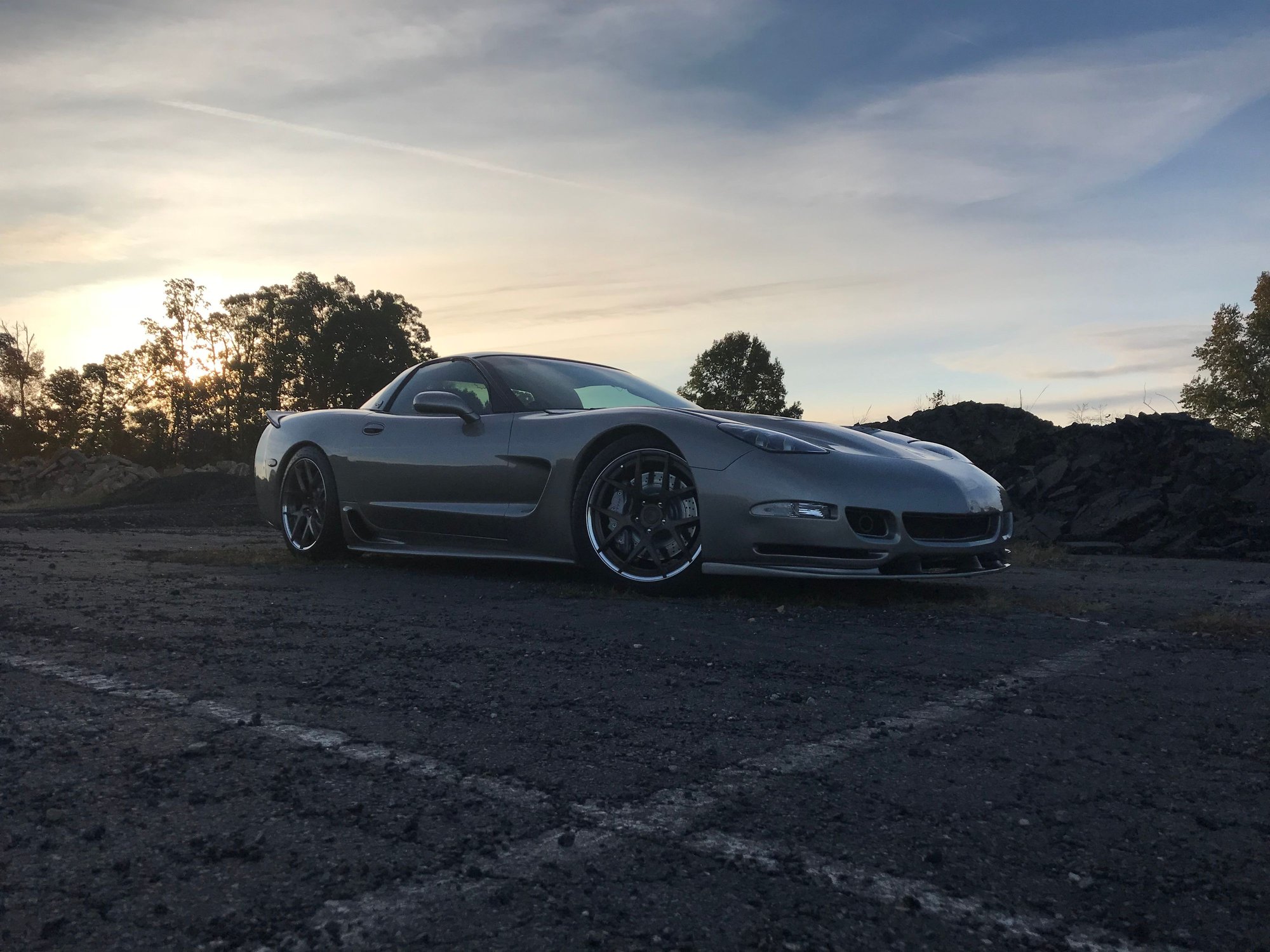

I was out this morning for a drive and got some cool shots...
