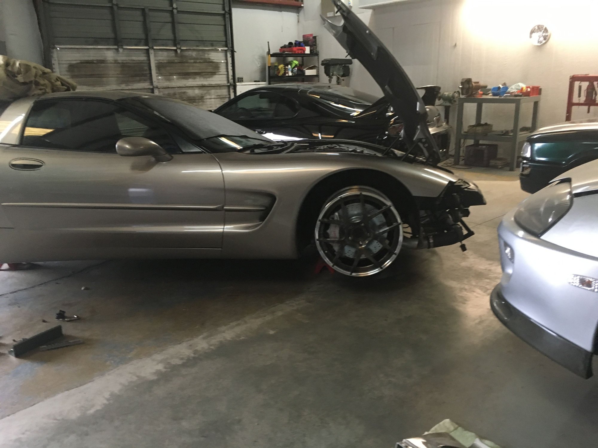

The guy that did all the work on my car is in Rock Hill, SC. Taking the old lights off is the hardest part, the RF's go on pretty easy. They are a bit of a pain to aim, but the connections are pretty strait forward, and there is so much more room to work without the headlight motors and gears.

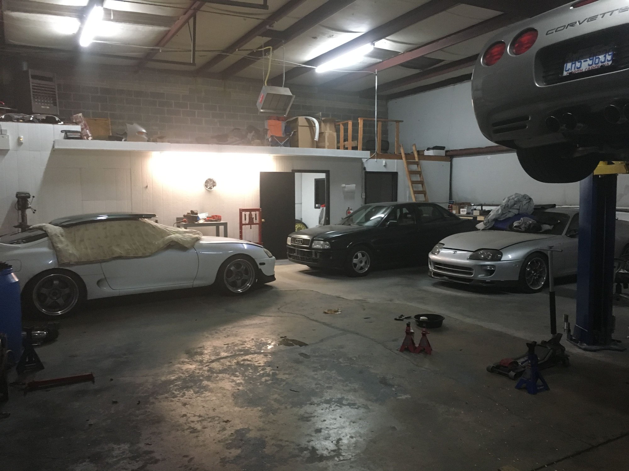

Bryan Ferranti. He has a full shop, but that's not his full time job. He specializes in Supra's, he did a lot of work on my brother's car. His personal car is a street legal 2000 whp Supra. He's really meticulous which is why I used him for my car. I'm as finicky about the appearance of my engine as I am about it's function. I hate wires all over the place, mismatched clamps, etc... He's also very reasonable. The only down side is turn around time. Like I said, this isn't his full time gig, even though his shop is huge, which is another thing I like, all cars are parked inside.
