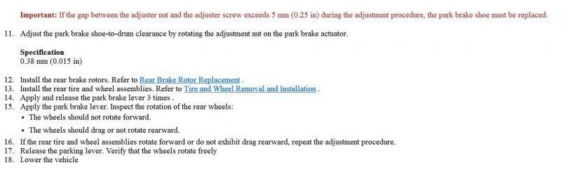

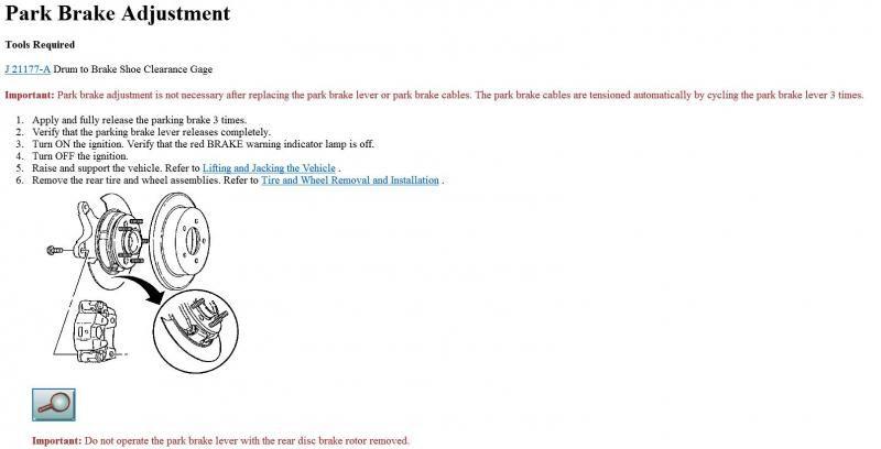

04 C5 Auto
Handbrake needs adjusting, won't hold vette. Tips? Suggestions if shadetree can do? Average cost if done by reliable shop?

It's easy, there's a very detailed thread somewhere around here with pics. Basically take wheel and rotor off and a adjuster thing to spin to adjust. Need to lube up the adjusters, that's probably the hardest part, getting them free.

Cycle the park brake lever three times in order to obtain proper park brake cable tension....taken right from the manual
On the other hand, this will only take up slack in the cable to a degree. In order to properly adjust the E-Brake you'll have to adjust the E-Brake shoes via the star wheel adjuster.
Here is a useful tread on the subject.
https://www.corvetteforum.com/forums...ustment-3.html
