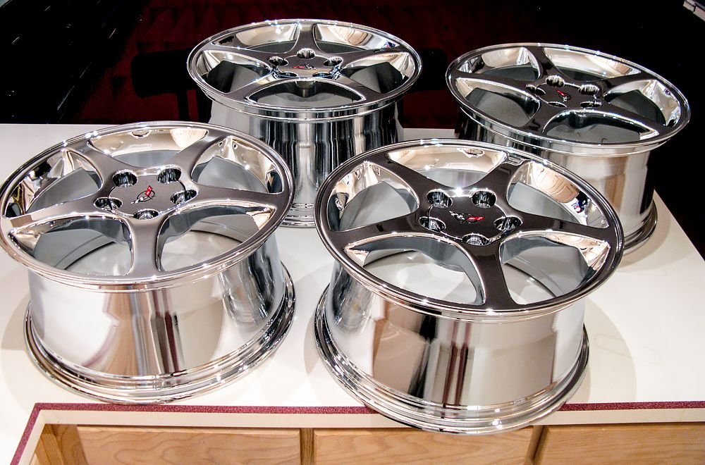

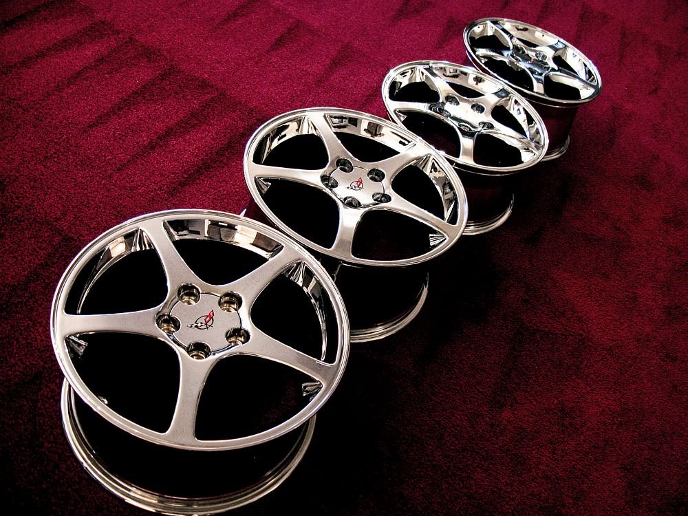

When I first bought my C5 new on 9/23/2000, the first day I went Discount Tire and they had a Chrome swap-out service for C5 thinspokes - for a price they would take your new factory wheels as cores and replace them with a chrome set from another core donor. That is what I did and they still looked like new after 14 years of daily use.
However, they happen to be my favorite wheel for the C5 (thinspokes in chrome) and I was getting fearful of maybe getting one damaged and be up a creek for a replacement and I did not want a set of Chinese repros. So after a couple years of searching, I saw that House of Wheels had one full set of GM Made in Italy Speedline Thinspokes left - just like mine - already 3rd party chromed which he sold me at a fair price. So I installed that new set 3 years ago (pictured above) and kept my 14 year old set as backups, just in case, since they still look like new!
