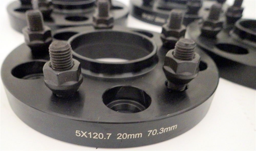

Short and simple.....No, that is if you plan on buying 18/19's with a C5 offset. If you plan on using C6 18/19's then Yes, one small issue.
Only thing is, because of differences in offsets with the C6, the rear wheels will be tucked inside of the wheel wells and it won't look right. Most of use use adapters to push the rear wheel out to where it should be.
Several months ago I installed 07 C6 5 spokes on my car. Added a 20mm thick adapter to the rear. Looks good IMO.
These are the adapters
Link with pictures on the install :
https://www.corvetteforum.com/forums...-cat-back.html

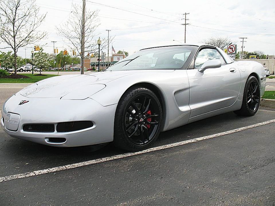

No problems, either. These are by Ruff with standard C5 offset.
