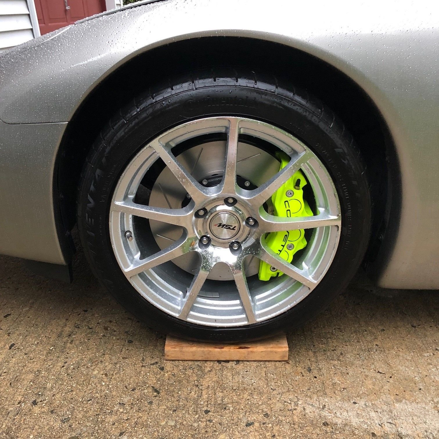

Surprised nobody has asked... are there ABS compatibility issues with these Cadillac calipers? Looking at the specs on the Wilwood calipers for the C5, they specifically mention their caliper cylinder volume is compatible with the C5 ABS controller and master cylinder.
Old May 15, 2023 | 05:16 PM
'Shifter's Avatar
'Shifter
Joined: Oct 2006
Posts: 20,393
Likes: 431
St. Jude Donor '08-'09-'10-'11-'12-'13-'14-'15-'16-'17
NCM Member '09
C6z's work just fine with C5 master/ABS, I'd imagine the Cad stuff would be the same.
Old May 17, 2023 | 08:58 AM
Kubs's Avatar
Kubs
Joined: Oct 2007
Posts: 9,700
Likes: 3,469
From: Akron Ohio
2024 C5 of the Year Winner - Modified
2023 C5 of the Year Finalist - Modified
St. Jude Donor '09-'10-'11
The Cadillac calipers have larger piston bores so the volume is larger than the stock C5 or C6 calipers. This will result in slightly longer pedal travel, but the ABS should be able to handle it.

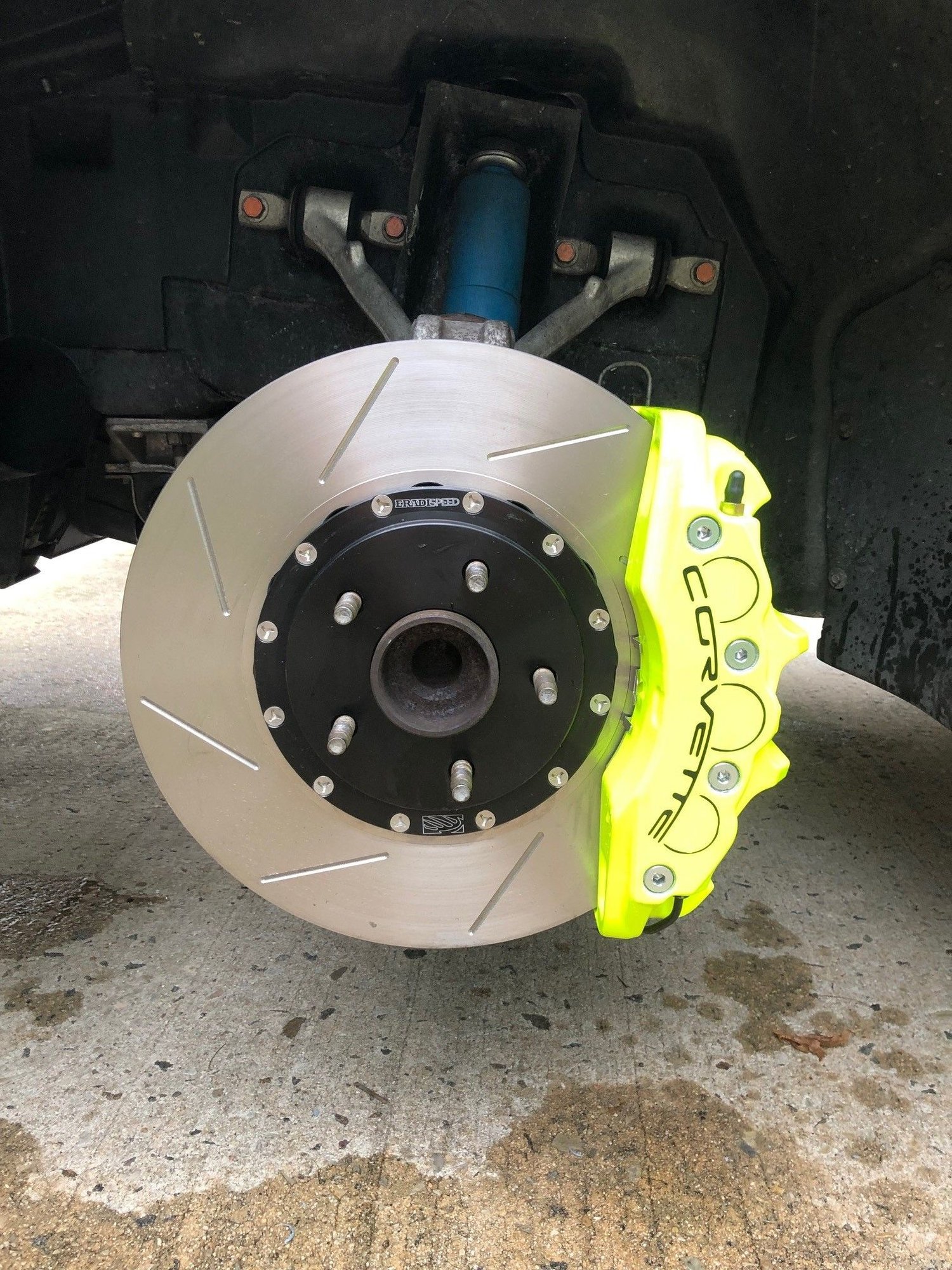

Originally Posted by TiRider
Clarifying this will help me for my next mod...'00 'Vert, base model. A years back I upgraded to C5 Z06 brakes, new calipers, rotors, braided brake lines, etc.
Just bought a set of C6 Z06 calipers having read on here a few times it was a rather simple swap. But I'm wondering now if I also need to change out the rotors?
Will my current rotors work or perhaps the better question, what is the minimum diameter rotor needed for these C6 Z06 calipers?
It can turn into an expensive project - C6Z powder-coated calipers, 2-piece rotors, new 19 + 18 wheels and tires - $4500 easily. I was told the factory C6Z front rotor weighs a ton so I bit the 2-piece bullet....
