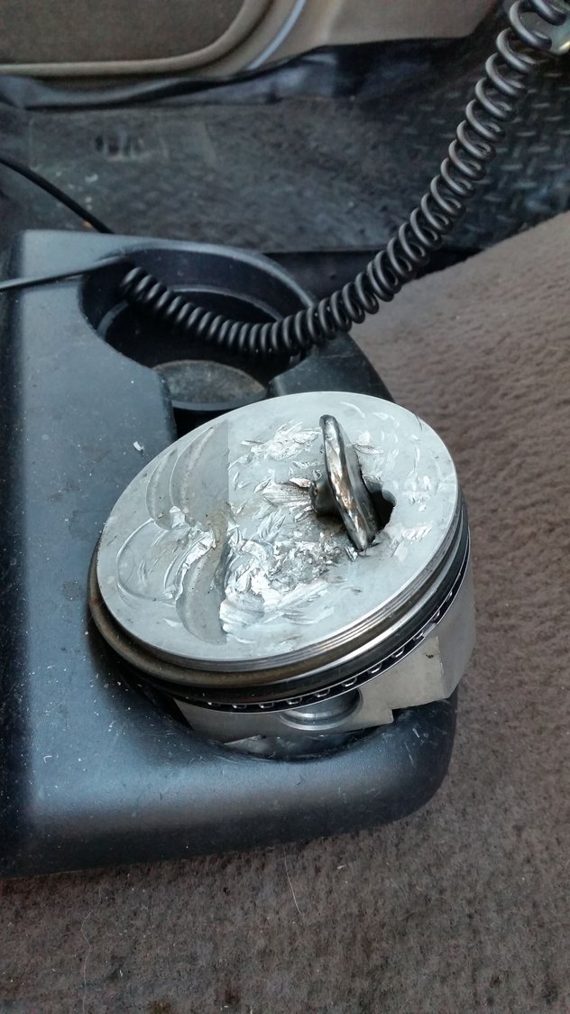

If it makes you feel any better...
Mine was worse!
Mine was worse!
Attachment 48230086
Psh
Mine was worse!
Attachment 48230086
What was the cause ?
If I had to guess, injector failure or other type of hydrolock situation.
I bought after it had been hydro-locked. Some water got into the intake, got into cyl 7, and the weakest link broke.
Water doesn't compress. It doesn't take much either. A few shot glasses maybe.

Originally Posted by Shaolin Crane
Psh
And what was your cause ? Did your engine eat a bolt or something ?
Keeper failure
