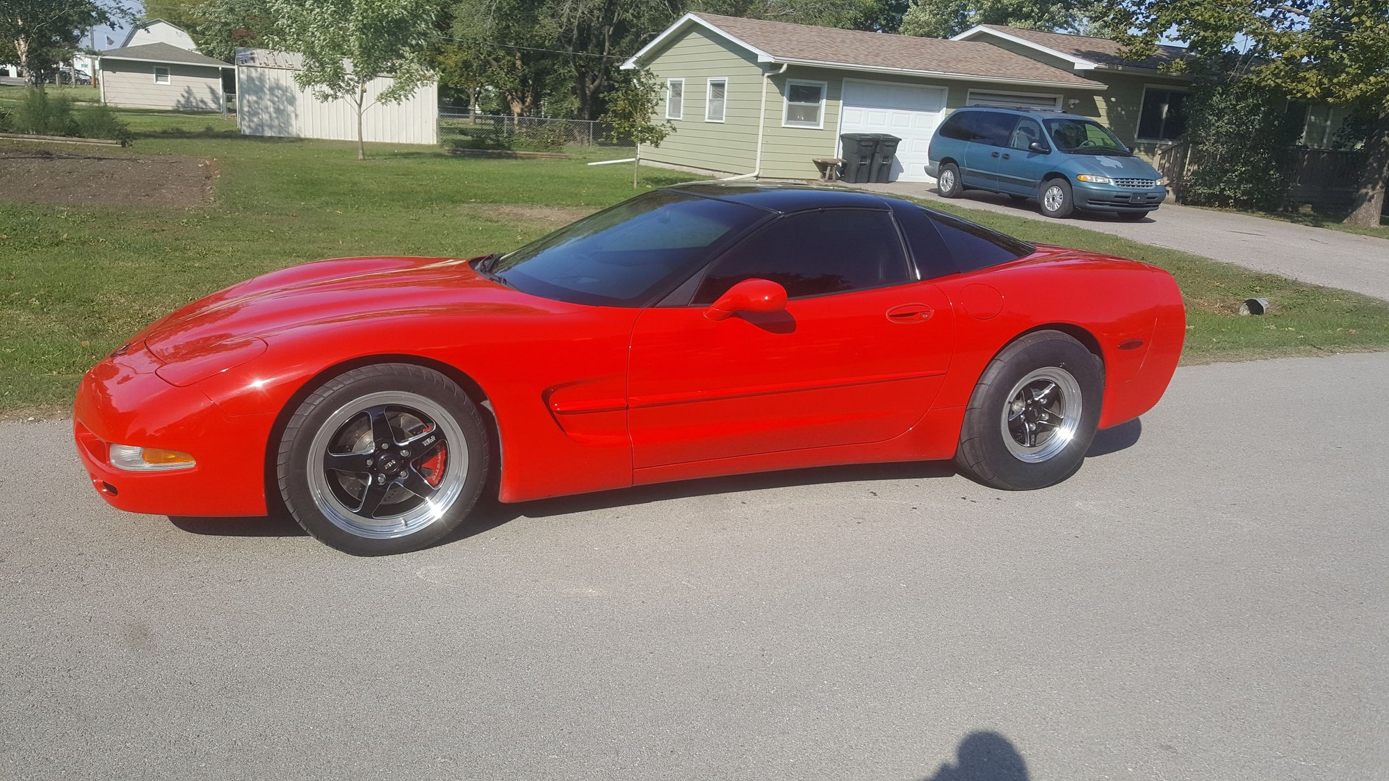

They are actually the same wheel. I had the non beadlock until this weekend. I'm thinking about polishing the ring to make them more like the front.

What width and offset fit your calipers and rotors on the rear ?

Wheels are 15x10 with 7.5in backspace. I did Carlyle spindles and brakes. I could have massaged my factory caliper but I figured this was the better way to do it. Had to clearance the lower control arm still.

I like the rear; but the fronts just look out of place now. Needs something much more aggressive looking to go with a beadlocked 15.

Difficult to tell from the pics, but looks like a standard wheel package up front and not skinny's?

is that a staggered 17/13 set up? I have never seen 13 inch wheels on the back of a Corvette...

you probably never will, those are 15"

Fronts are 18x5. Looked at running 15s on the front. Takes a little work. U basically run the rear brakes on the front and have to use a little spacer. I didn't want to mess with it.

Wheels are 15x10. Tires are 275/60r15

The black beadlock does make the wheel look smaller. I was thinking of polishing it. Still on the fence though

why do your rear wheels/tires stick out so much? I have the same setup but mine are even with the fenders, did you use a c6z offset? It could be just the way the pic is taken also. Needs a 17in alumastar upfront now for sure.
