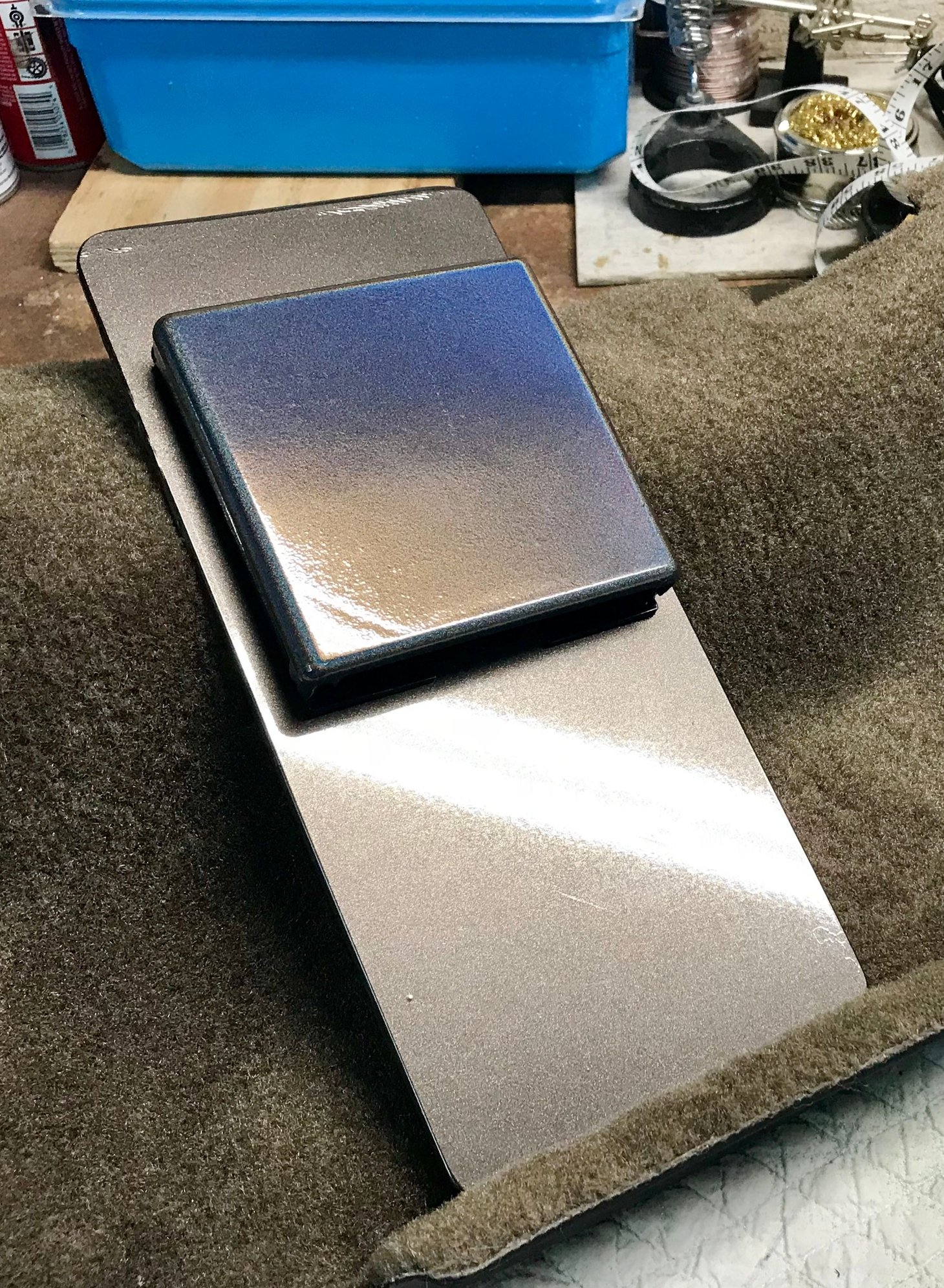

I made my own like this one. Cost $5.

My lower interior is completely out, so this is a bench shot.

chasboy , Looks great !

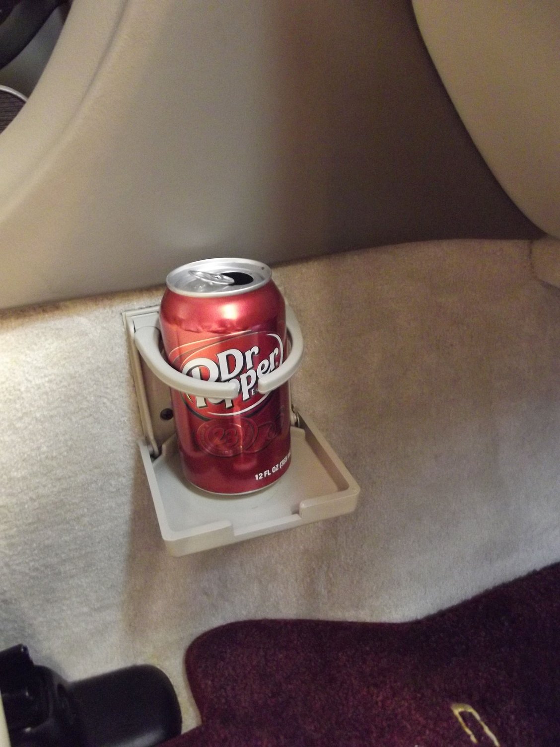

Yep, that is the style I have used for over a decade in several cars. But I don't use the flat piece to mount mine. I just slip a piece of 1/4" plywood the size of the cup holder behind the carpet and screw the cupholder to it through the carpet. Works great for us.

Thats a great idea! My only concern about using a wood or sheet metal screw is if the vibration of the car causes them to loosen?
Since I’m putting in new rugs, I might want to switch to that method!

Mine have never loosened in several different cars and thousands of miles.
I use short, countersunk, wood screws so they just break through the back of the wood behind the carpet. The stock felt pad that is between the tunnel and the carpet is not damaged.

The same size as the square cup holder back plate...size varies with different cup holder models.
Or use two strips of wood, one for the top and one for the bottom.
I have used thin plywood as well as wood paint stir sticks.......but they can split if a pilot hole isn't pre-drilled
