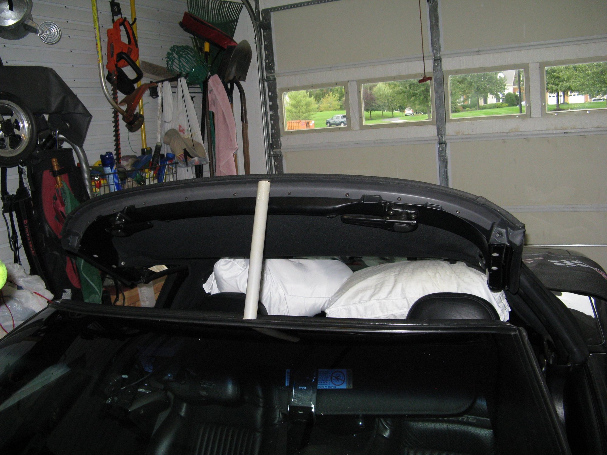

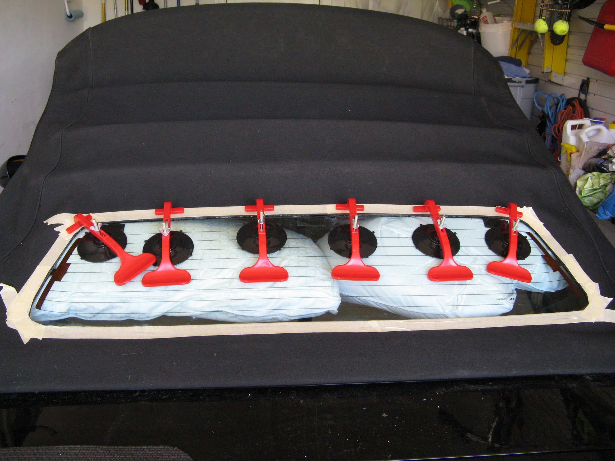

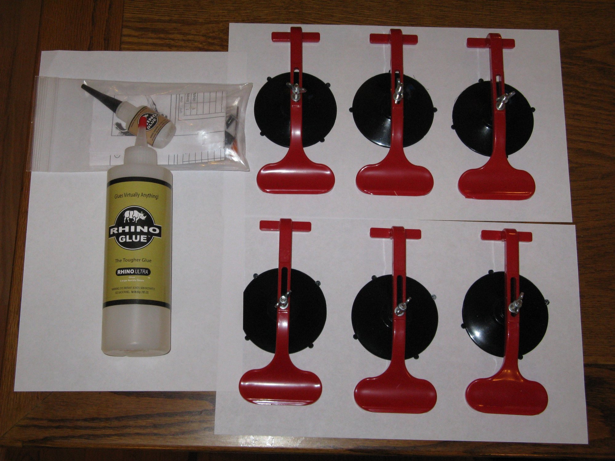

In my previous post, I mistakenly attached the same process that Vettman jack did. Here is the info I wanted to convey.
I used RINO Glue -ultra and a package of 6 Universal Vacuum Clamps for Convertible Glass Repair that I found on Amazon.
I partially opened the top to relieve fabric tension. I stuffed pillows against the glass.

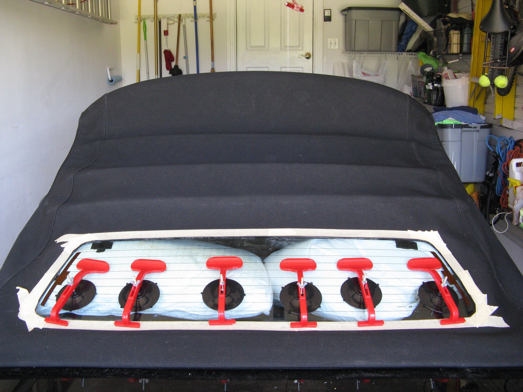

I first removed the old glue stuff from the glass using a glass scrapper followed with glue removal liquid. Then I masked the outside of the top to protect it from any glue after application. I applied the RINO Glue first at the top of the glass and used all 6 Vacuum Clamps leaving them on for at least 8 hours.

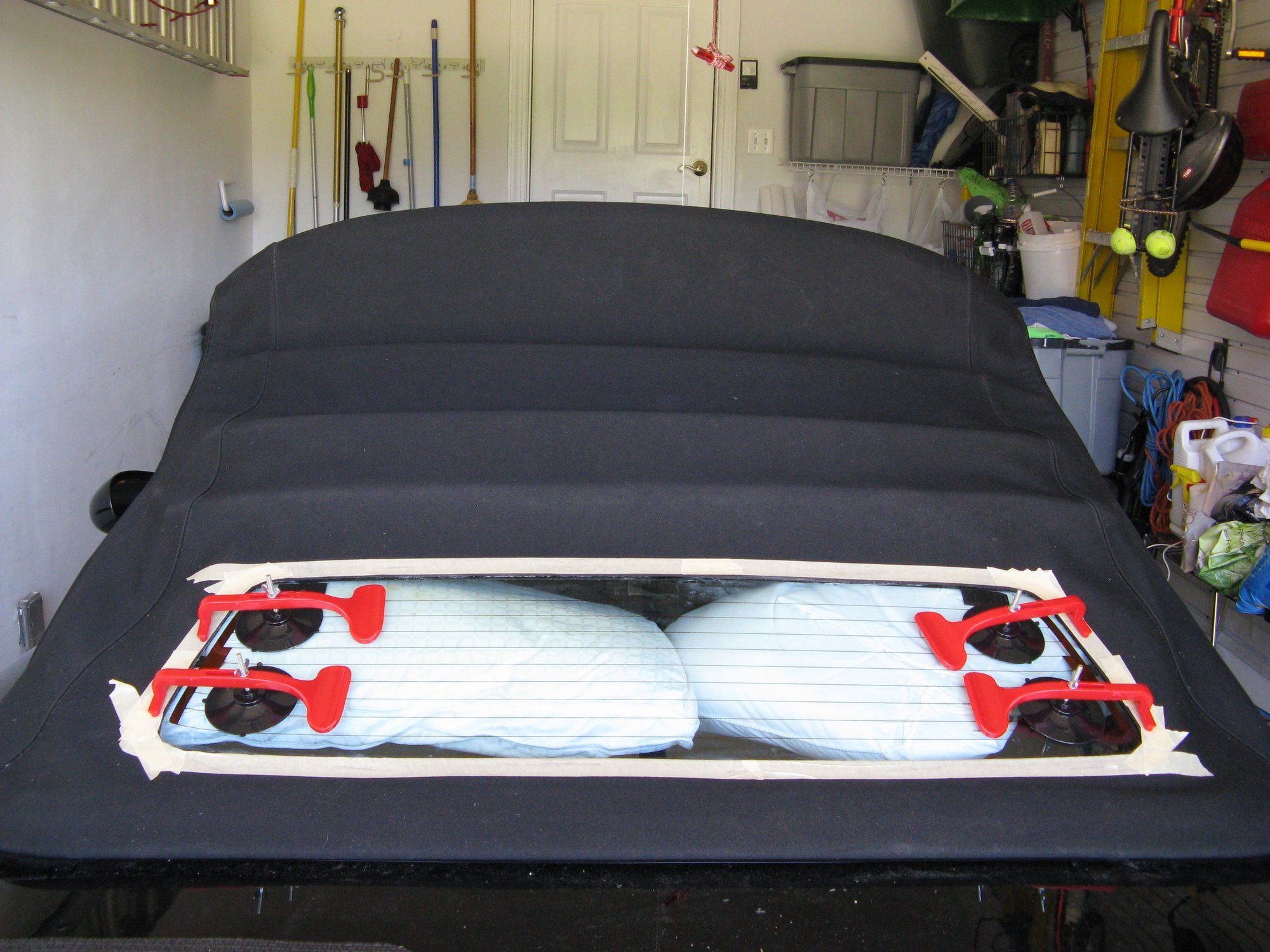

I then glued the two sides at once leaving them clamps attached for at least 8 hours.
Last I glued the bottom and left the clamps attached for at least 8 hours.
Did you apply the glue to the glass or inside of top? and how long has it lasted so far?
BTW...Thanks, great job
Old Feb 3, 2018 | 08:07 AM
rrwirsi's Avatar
rrwirsi
Joined: Nov 2014
Posts: 3,399
Likes: 1,339
From: Havre de Grace Maryland
I applied the glue to the glass. Make sure you clean both the glass and the fabric from all the old glue stuff before applying the new glue. I did the glass/top August 2017. So far, the glass is holding.
