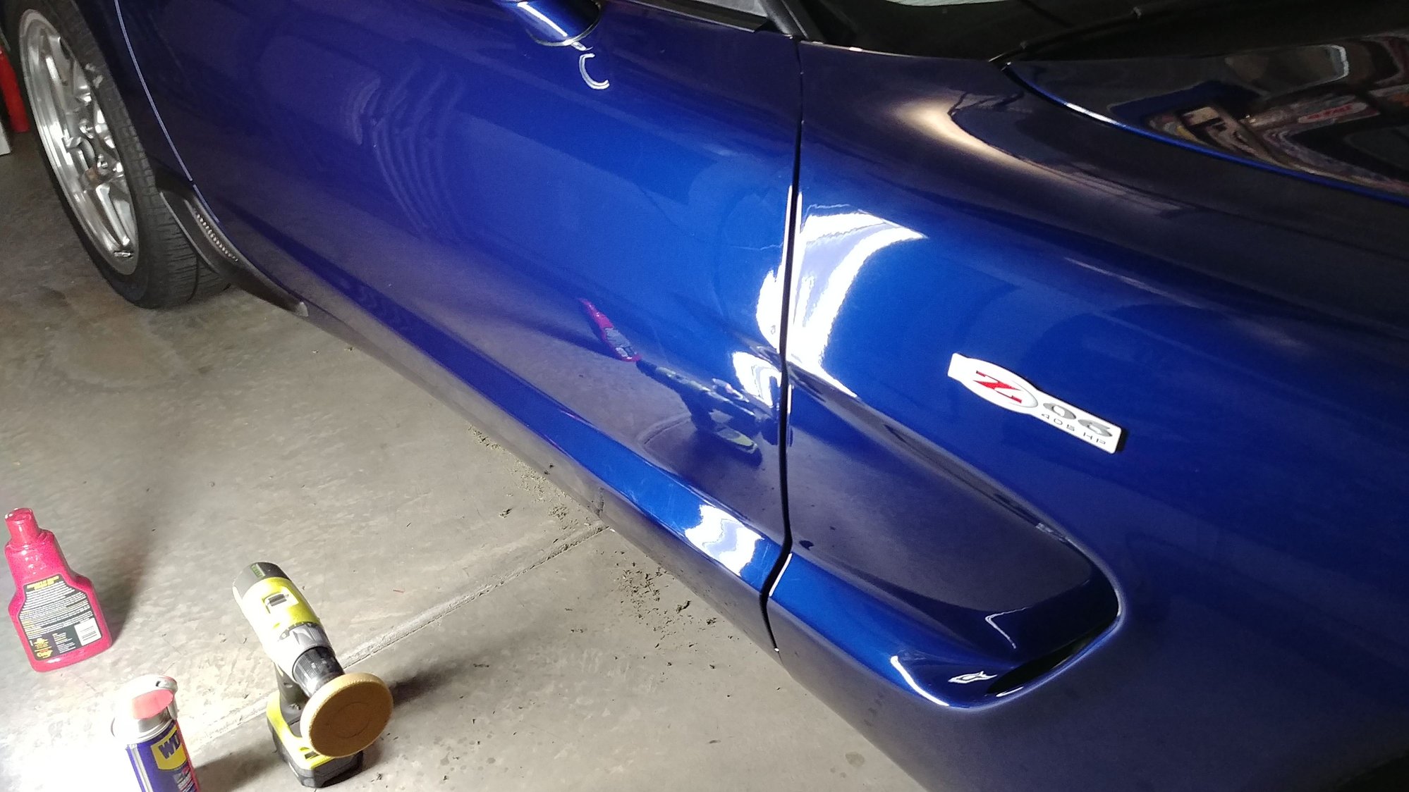

I removed mine starting with fishing line. Then I used an eraser wheel to remove the remaining tape residue. Works great, I had never heard of an eraser wheel, but they work great and didn't leave any scratches. Cheap on Amazon as well.
