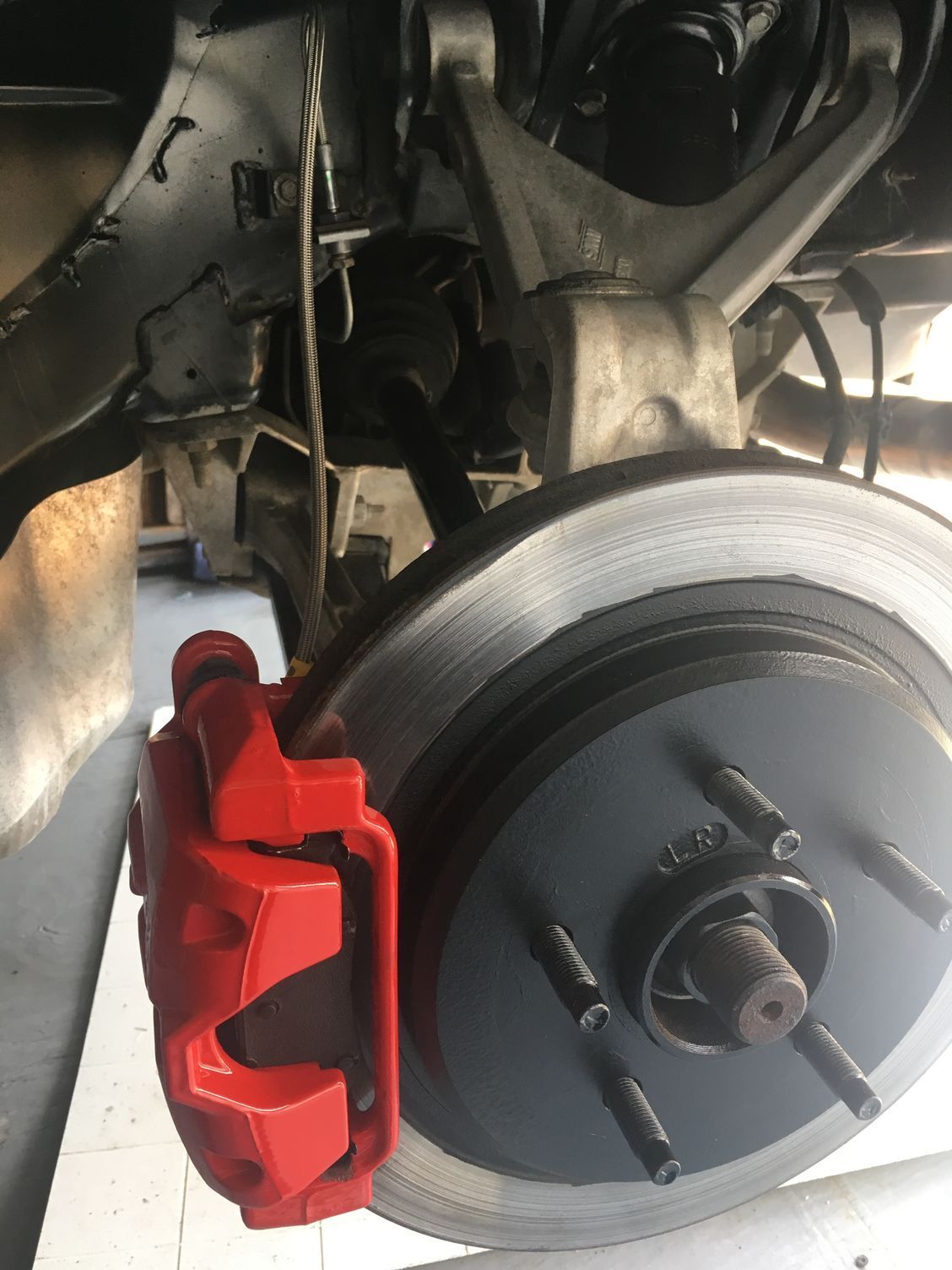

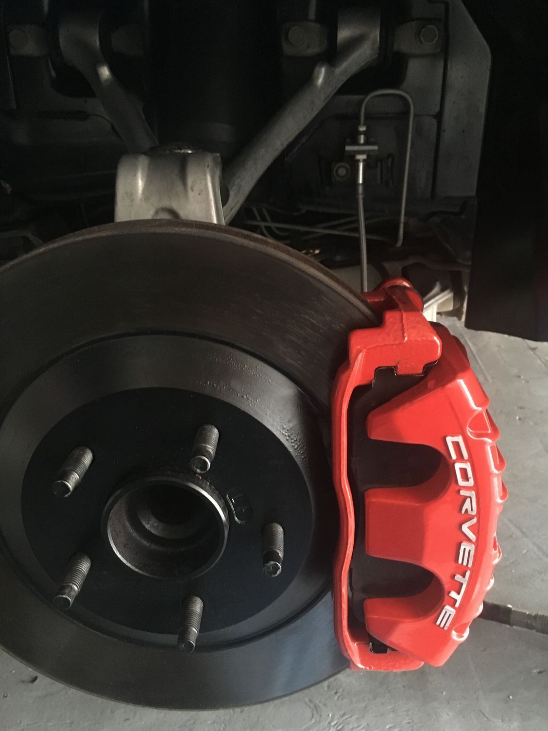

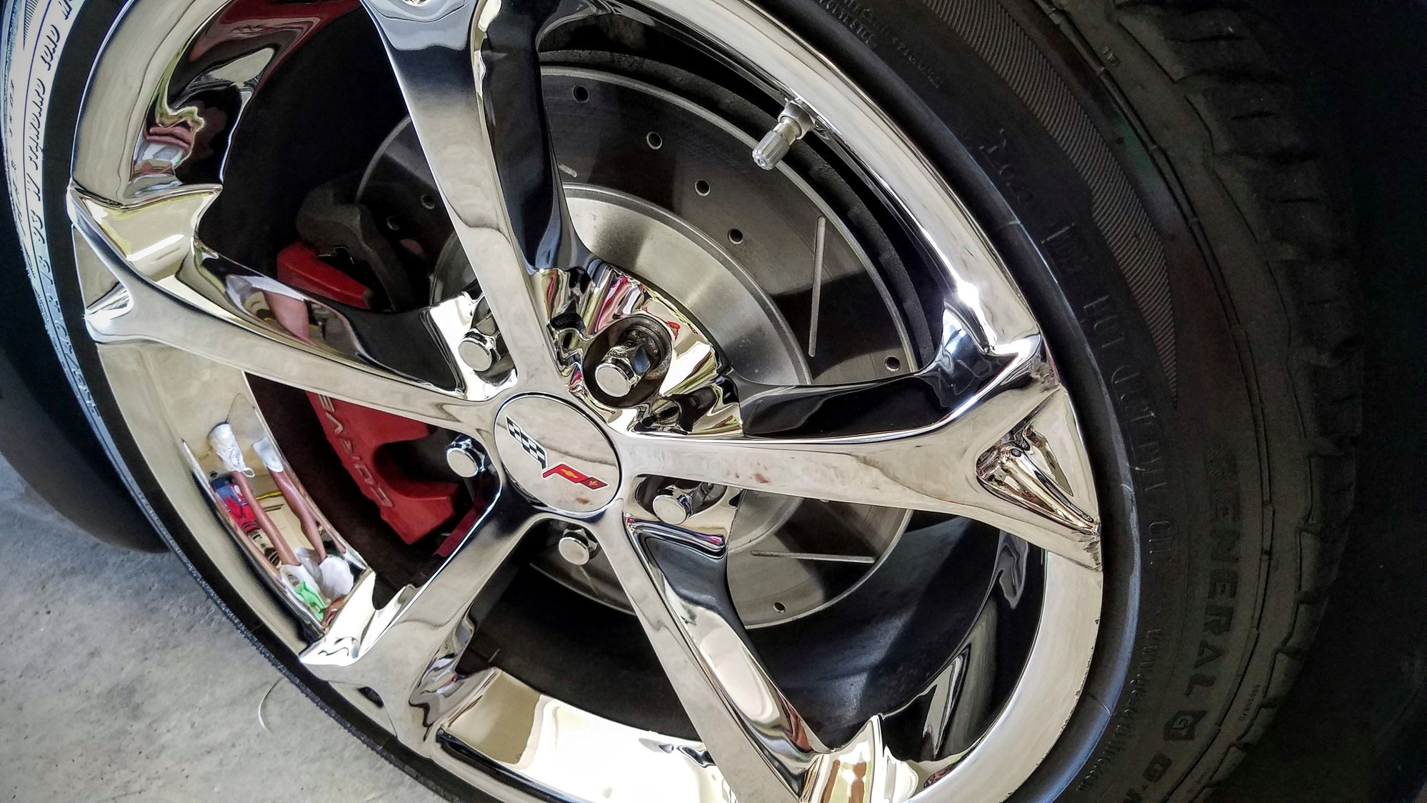

I just had mine powder coated, got this done by a forum vendor TPS

Nice. The calipers look great.

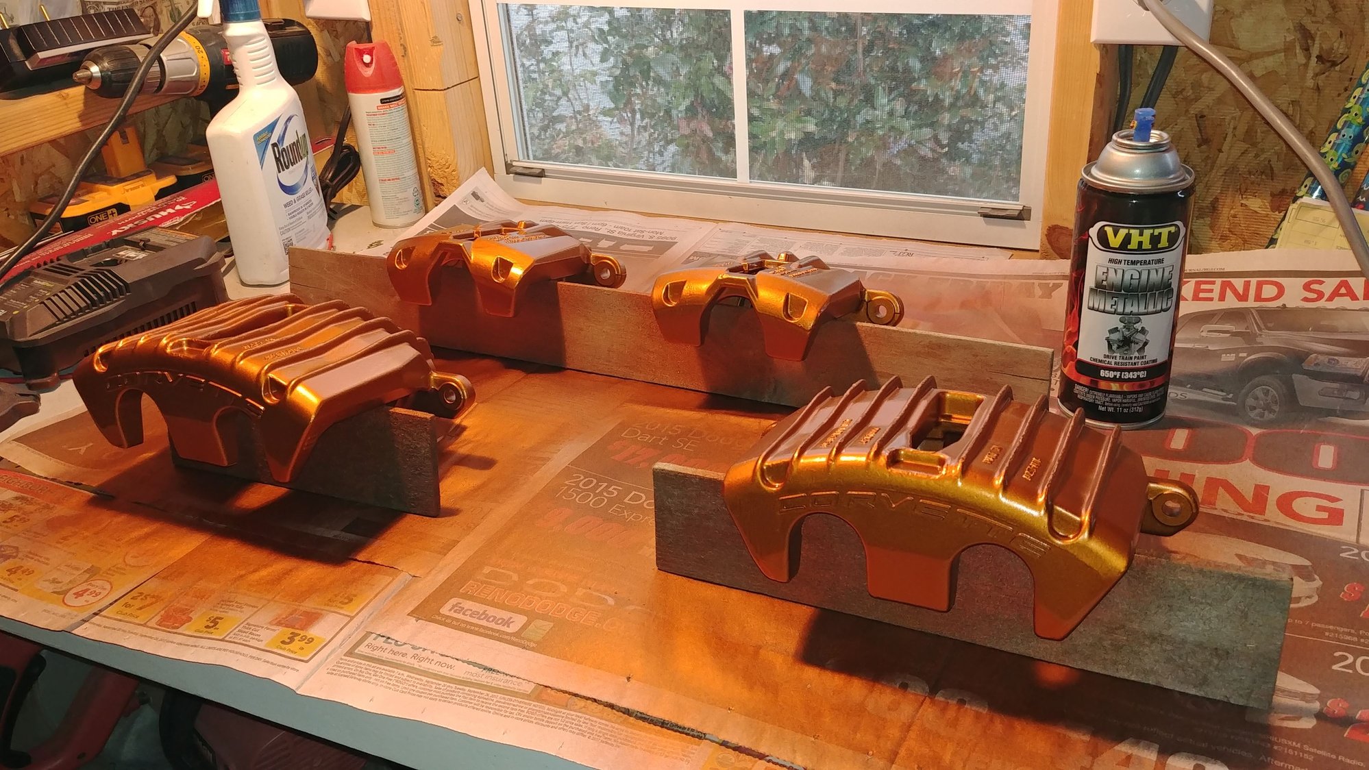

Originally Posted by mrmagloo
Those look great! I assume you have a millenium yellow too. How well does that color match the body? If pretty good, do you have the pn? Thx!
The caliper color is burnt copper, a VHT engine color. Car is lamans blue, I was trying to match the Nissan GTR caliper color. I've only had the calipers painted for like a month so I can't say for sure how they'll hold up, but with past cars it hasn't been a problem, but no heavy track days. The engine paint is rated to 650° so should be fine, brake fluid will be boiling well before that.
I used the gold on my wife's Mazda, held up fine for many years. Copper is on the right.

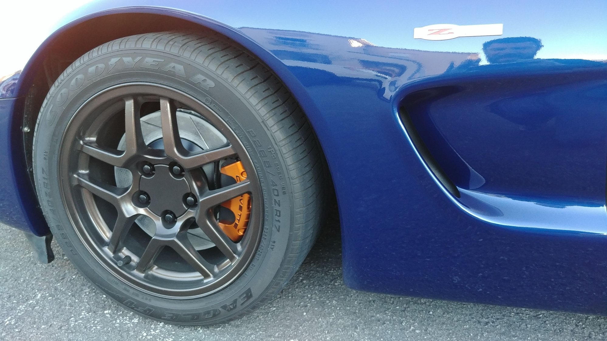

How did you apply paint to the lettering? What method did you use? Were the calipers already painted when you started?
I cleaned my stock red calipers really well, then just painted them, no scuffing, or primer. To do the letters, I sprayed high heat black spray paint into the cap so that I could dip a small paint brush into the paint and use it that way. Used my kids water color brush. Just painted over the burnt copper.
Thanks! that first pic sure looked Yellow. Still look great!
