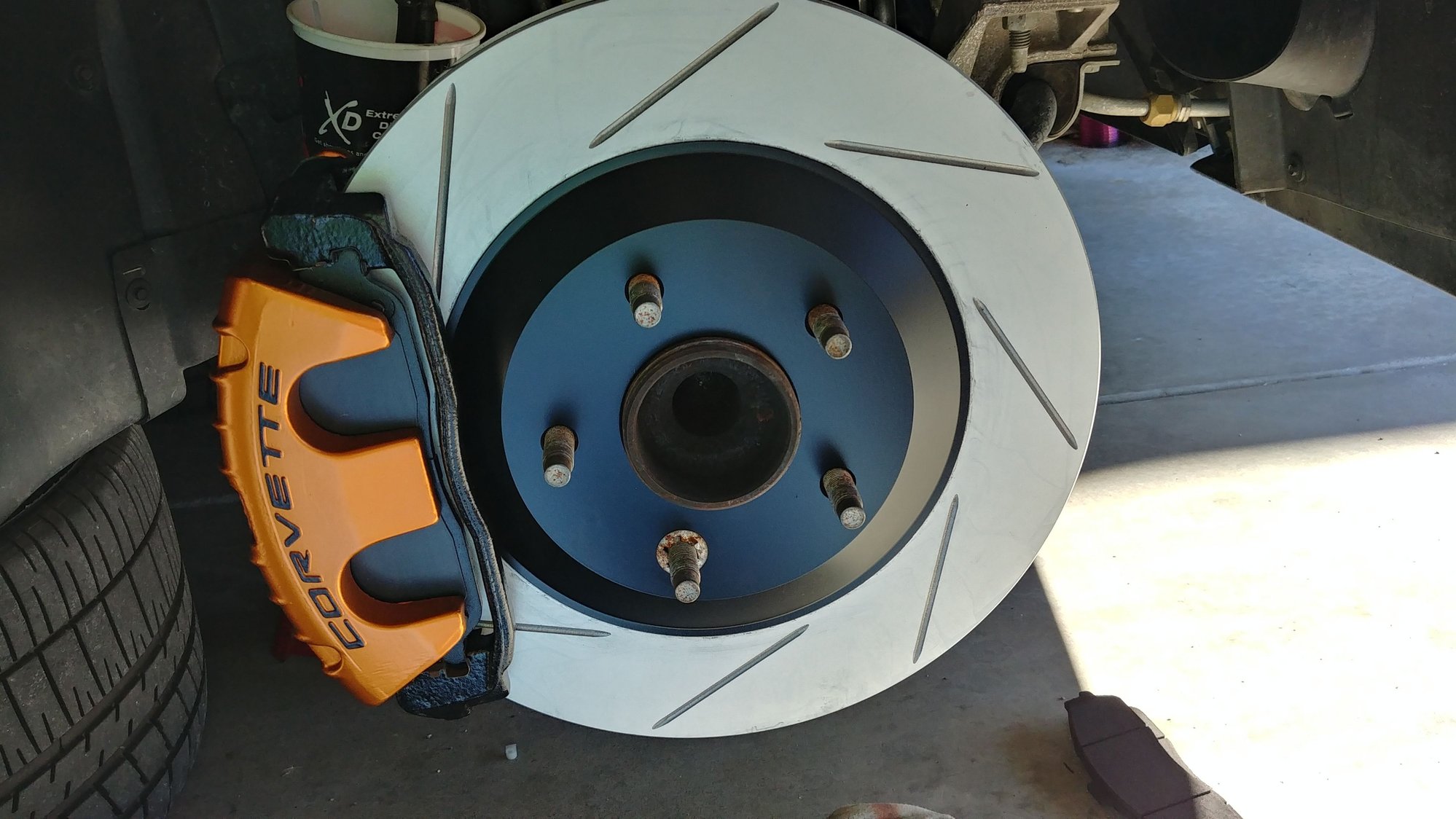

My C5 has factory painted red brake calipers. There are a couple spots where the paint is chipped off. If I choose to repaint the calipers:
• Will standard caliper paint work on top of already painted calipers?
• How do I get the Corvette lettering unpainted perfectly, or perfectly painted white?
I've included a photo a found on this forum. The photo is an example of what I want to do with my brake calibers in terms of keeping the lettering looking as good as the example photo below.
This is not my car but this is an example of what I am describing with the lettering on the front brake caliber.

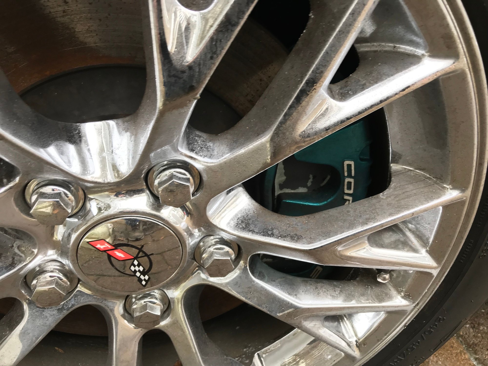

I used a single cut flat file to expose the letters. If one holds it perfectly flat against the letters, the single cut teeth leave a nice shiny smooth surface. My only concern with chapstick is if any gets over the side of the letters, and with painting, i found that a paint pen works better for me than a brush.
Please excuse the 3 months of dust and moisture, between the weather and reworking my interior we have not been mobile in a long while, or clean. BTW, the color is a Honda teal from the 90’s, and it’s just regular body paint that was made at a local body supply.

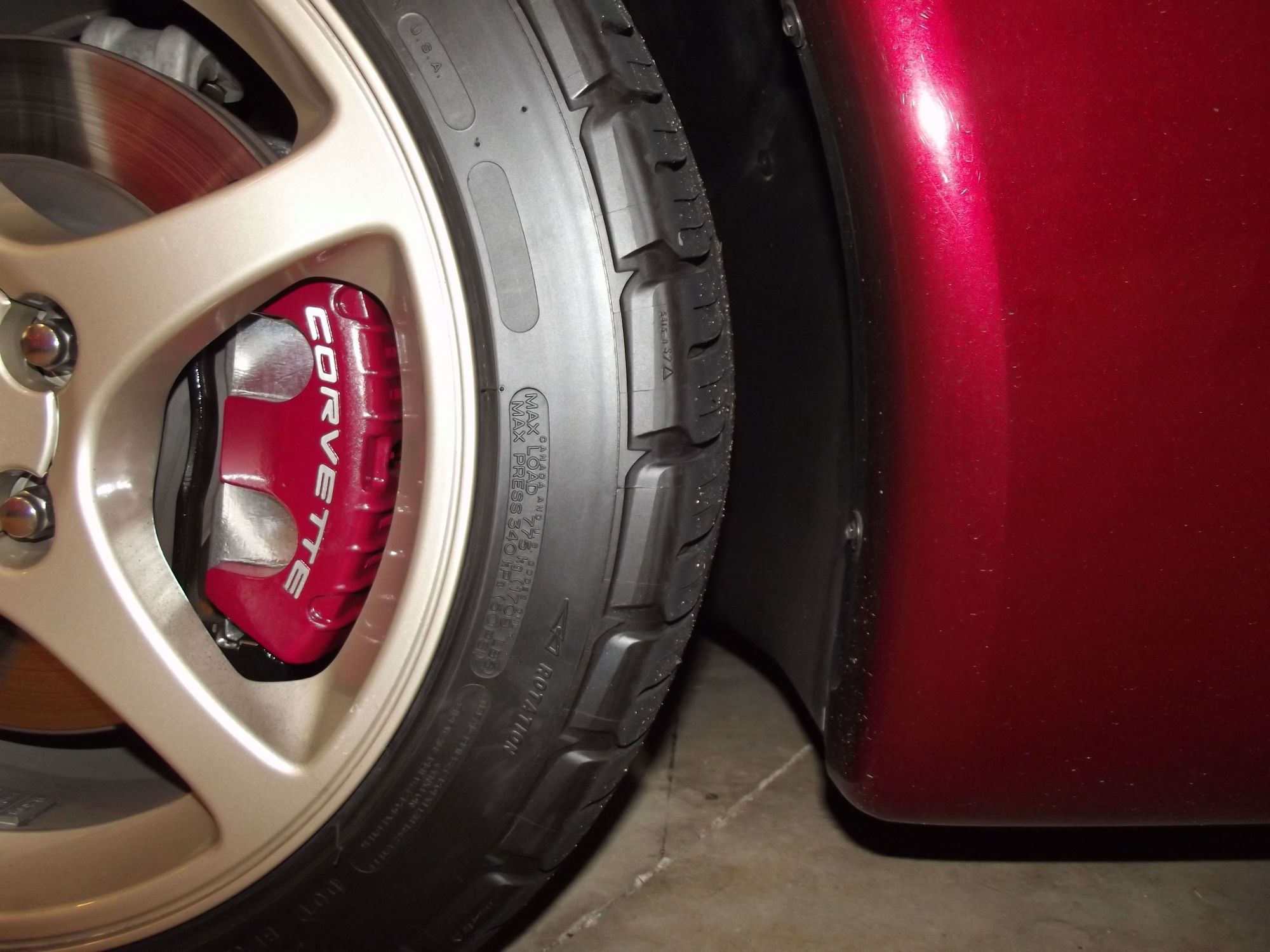

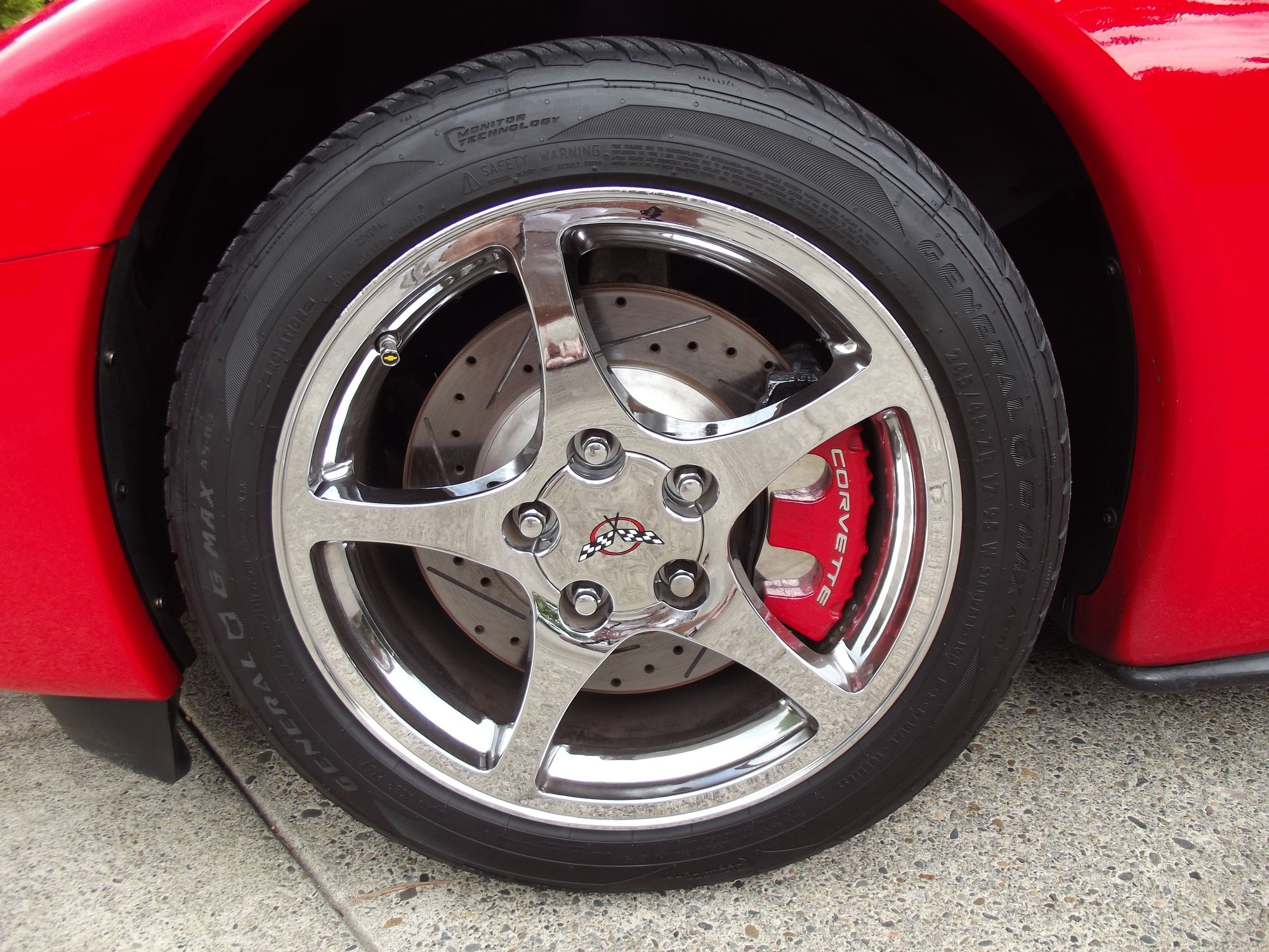

Unless your planning to track your car you don't really need to use high temp paint. I brush painted the calipers on my 99 with Rust-Oleum 7762830 Gloss Sunrise Red and it lasted for over a decade and 70k miles with occasional touch-ups. I didn't even remove the calipers, painted them while mounted. The 99 was Torch Red and the Sunrise Red matched very well on the calipers.
When I sold my 99 after buying and bought my 03 50th Anniversary I used Rust-Oleum 7768830 Gloss Burgundy on my calipers and again the color match was plenty close for calipers. Neither ever bubbled or flaked off in thousands of normal driving miles.
