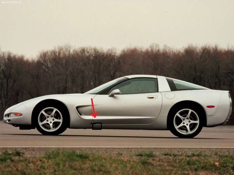

So i hit a ditch couple of weeks ago and got some minor damage Im going to start the repair soon.
I've started to remove the front and started on the side skirt.
But is the side skirt even removable?
Thanks!

My understanding is that it is quite a process to get them off and back on. They are glued in place.
This post might be helpful:
https://www.corvetteforum.com/forums...c5-before.html

Yes, the rocker panel (where your damage is) is glued on by the factory and is a bear to get off in one piece. Plus I do not believe you can buy an OE piece any more (I could be wrong on that though). If you can repair the damaged section with it still on the car, that may be the best way to go.
I had very similar damage on my rocker panel - I was about 4” br 6” of ragged fiberglass. I ended up just repairing it, you can’t see the patch with new paint.

I definitely would have repaired the rocker panel on the car instead of trying to remove it.

This is the complete one piece rocker panel, and is without a doubt one hell of a job to replace! It is indeed glued from the factory and often break apart when being removed. It's not impossible to do yourself, but you have to remove door, both fenders, trim etc!!! So it you have plenty of time, tools and a decent knowledge of how these cars are put together, it can be done. Goodluck!

I see...
Now that i know its glued im leaning towards patch fix. I will prob break and heat gun the **** out of this panel to come lose.
Thank you for this information.

It would have to be messed up pretty bad not to just to consider a repair. As stated above it's one helluva job to replace.. that's if you can even source the part.
