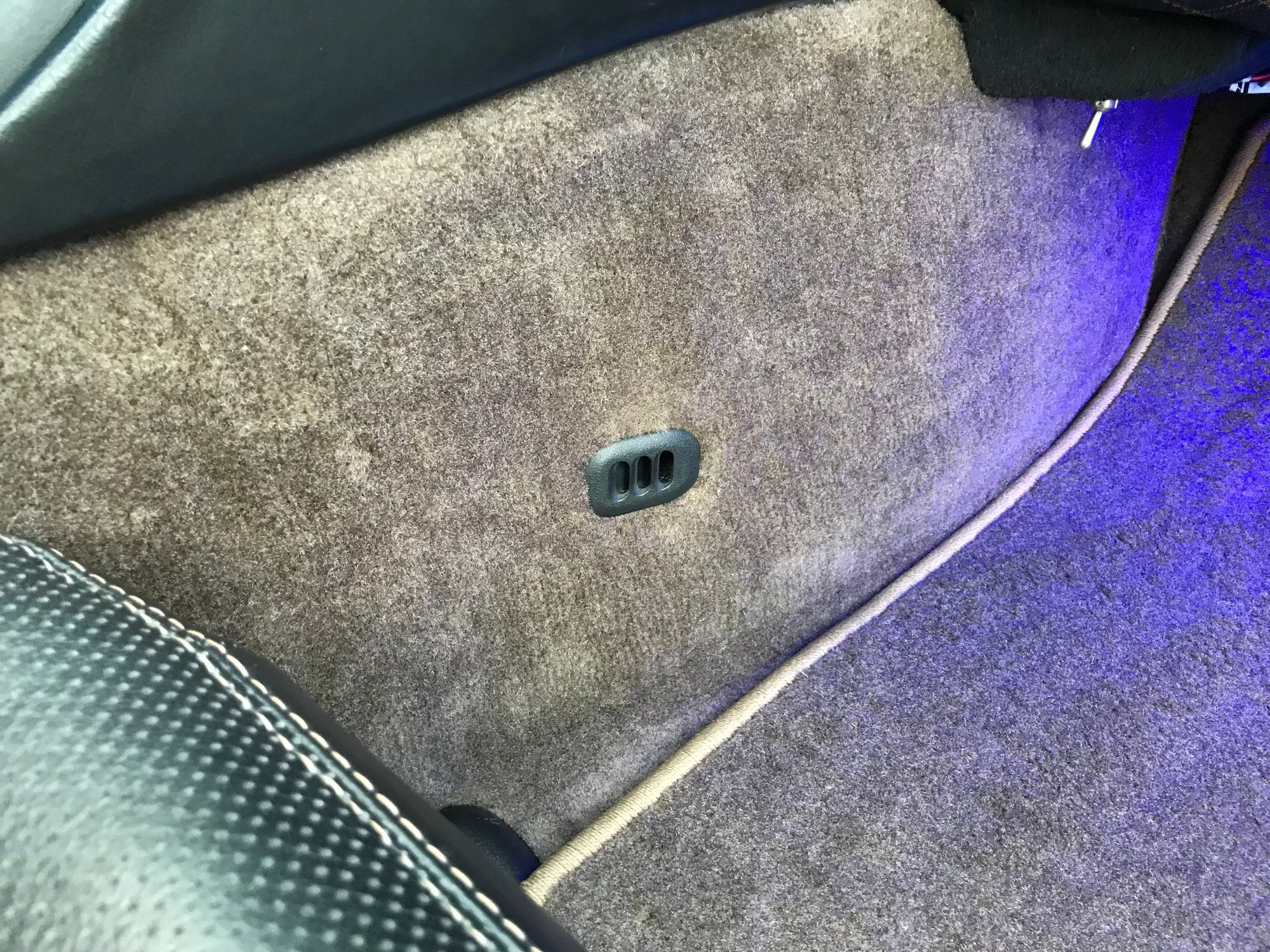

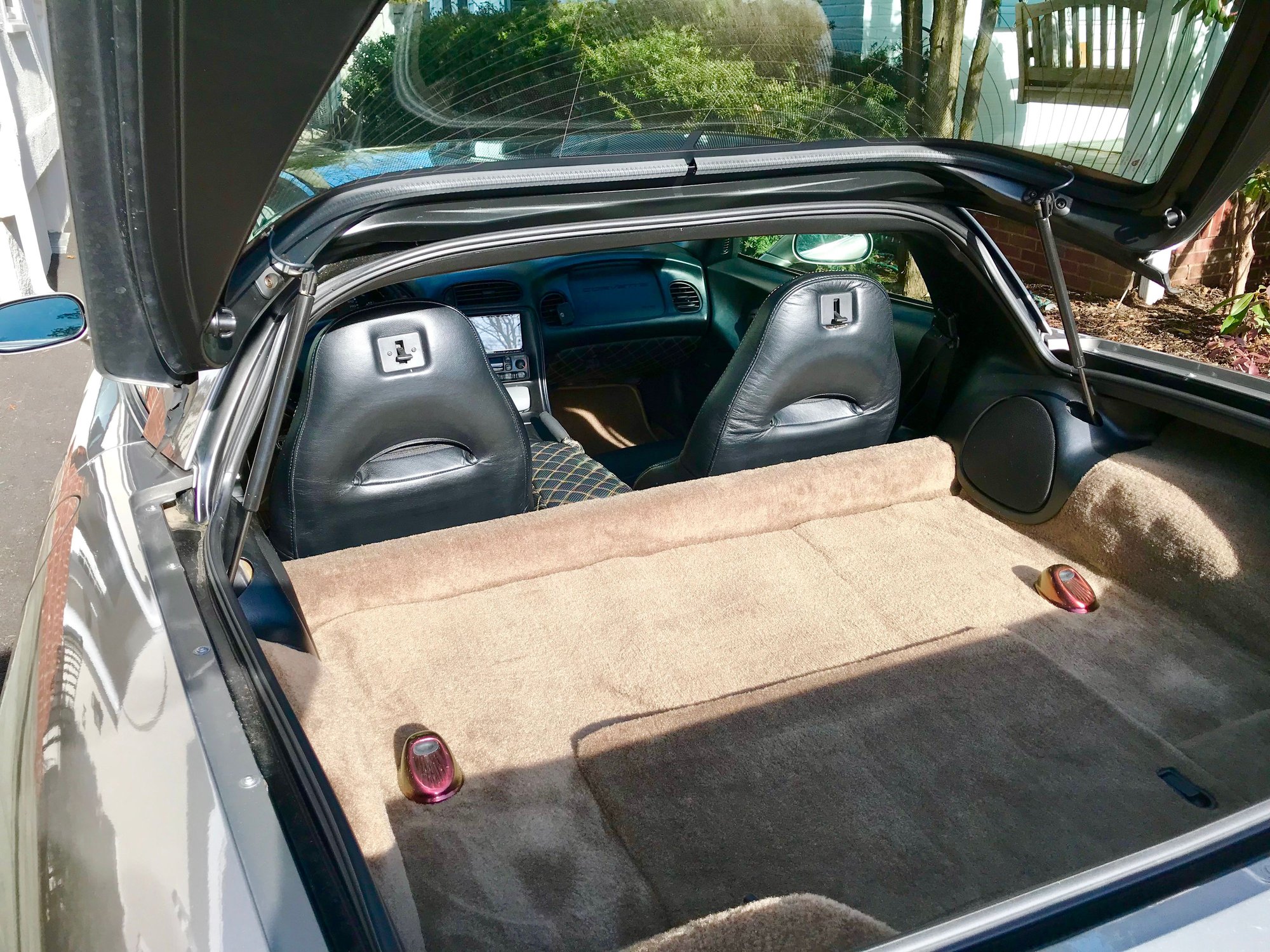

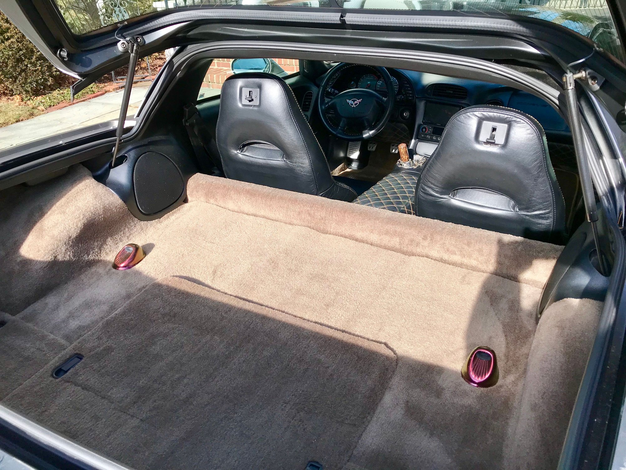

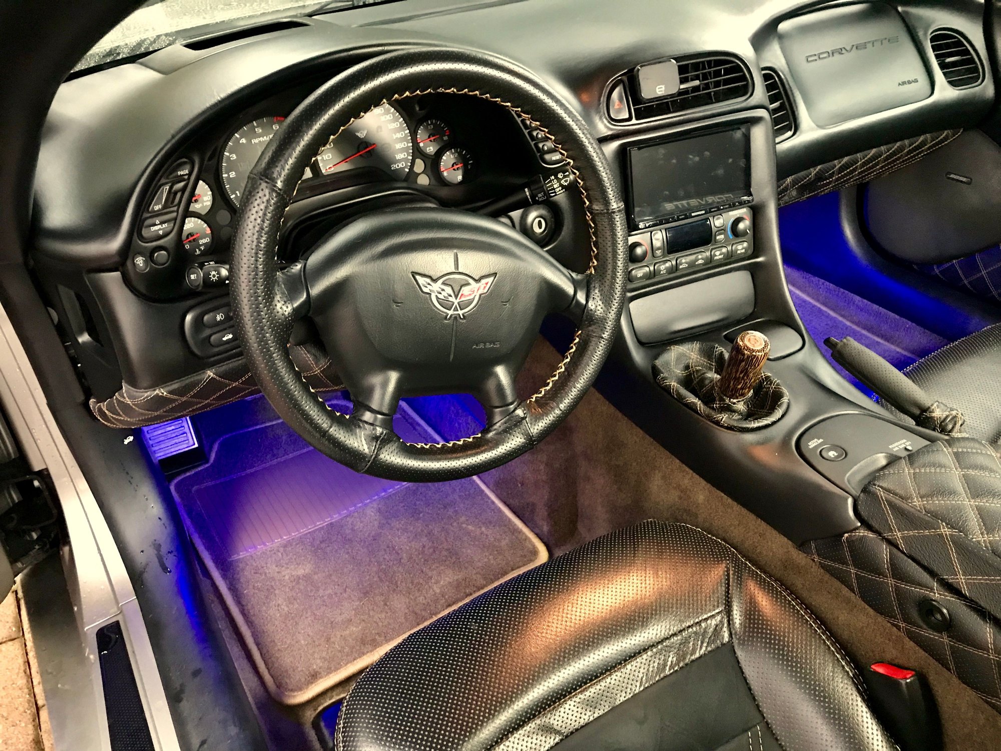

I just installed ACC carpet from Stock Interiors. I also went for the ‘massbacking’ which made them harder to wrestle with. However, I wanted new and NONstock color. Their molding process is primitive compared to stock, and there are very little reference points for the larger pieces that require trimming. Since I did this during a time where the weather would not permit driving, time was a non issue. It took about a week to do everything, and I spent a lot of time creating reference marks that could be transferred to the new carpet, in particular the 2 pieces for the front floor. The time was well spent, since I didn’t have to do any further trimming when I installed it all in the car. It looks gorgeous, my car is now unique and my custom black leather changes don’t sink into the black carpet, they pop. I think the binding on mine looks fine and very nice on the matching floor mats.
Jep, they have a number of greys. I went with a darker taupe to go with my pewter paint, but I don’t think it will show dirt like some lighter tans. I highly recommend them, and they responded to any questions either on the phone or email quickly.
Because of the additional stiffness from the optional backing, I used a heat gun or fabric steamer to ‘coerce’ certain parts into shape. I’d do it again in a heartbeat.
