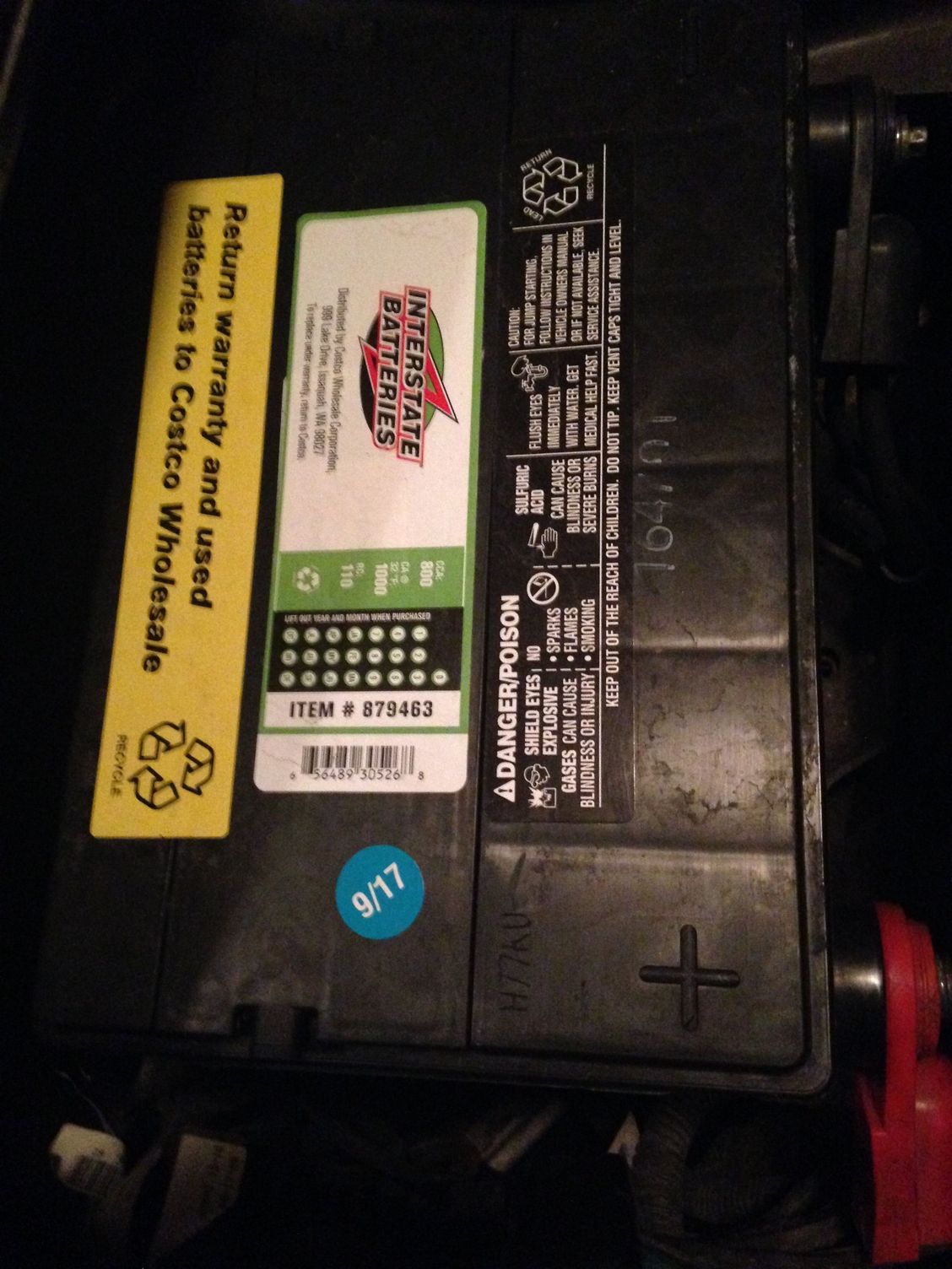

In September I replaced a AC Delco I bought from a Corvette Forum vendor in Arizona with a Costco battery with same specs for 79.99.
Has been great, I think I payed 140.00 for AC Delco battery, so 60.00 saved.
4th battery since having car from 2003, none of my batteries ever leaked, however I think the original battery leaked before I got car from looks of frame under battery tray.

I looked up Costco battery search for 2001, different battery and lower cranking amps and reserve capacity.
2001 must use a smaller battery?

If you zoom in on my battery pic it says 800 cold cranking amps and 110RC, same as the AC Delco I replaced.
I looked hard for 120RC both times battery shopping and this was highest I could find.

If the battery I bought will physically fit in 2001 Corvette (I'm curious why the 2001 listed a weaker battery, is it a space issue?) just buy the battery I got and say your car is that year.
I believe it has a 3 year warranty, that's it, no pro rating after 3 years.
Also I pulled the battery off the shelf myself while Costco tire/battery guy was helping ring someone up, I got the newest one, dug a couple of batteries back, made in September, same month I bought.
The others were June and July, maybe I'm OCD but I wanted the freshest battery!
Can anyone verify if 2001 has smaller battery compartment?
