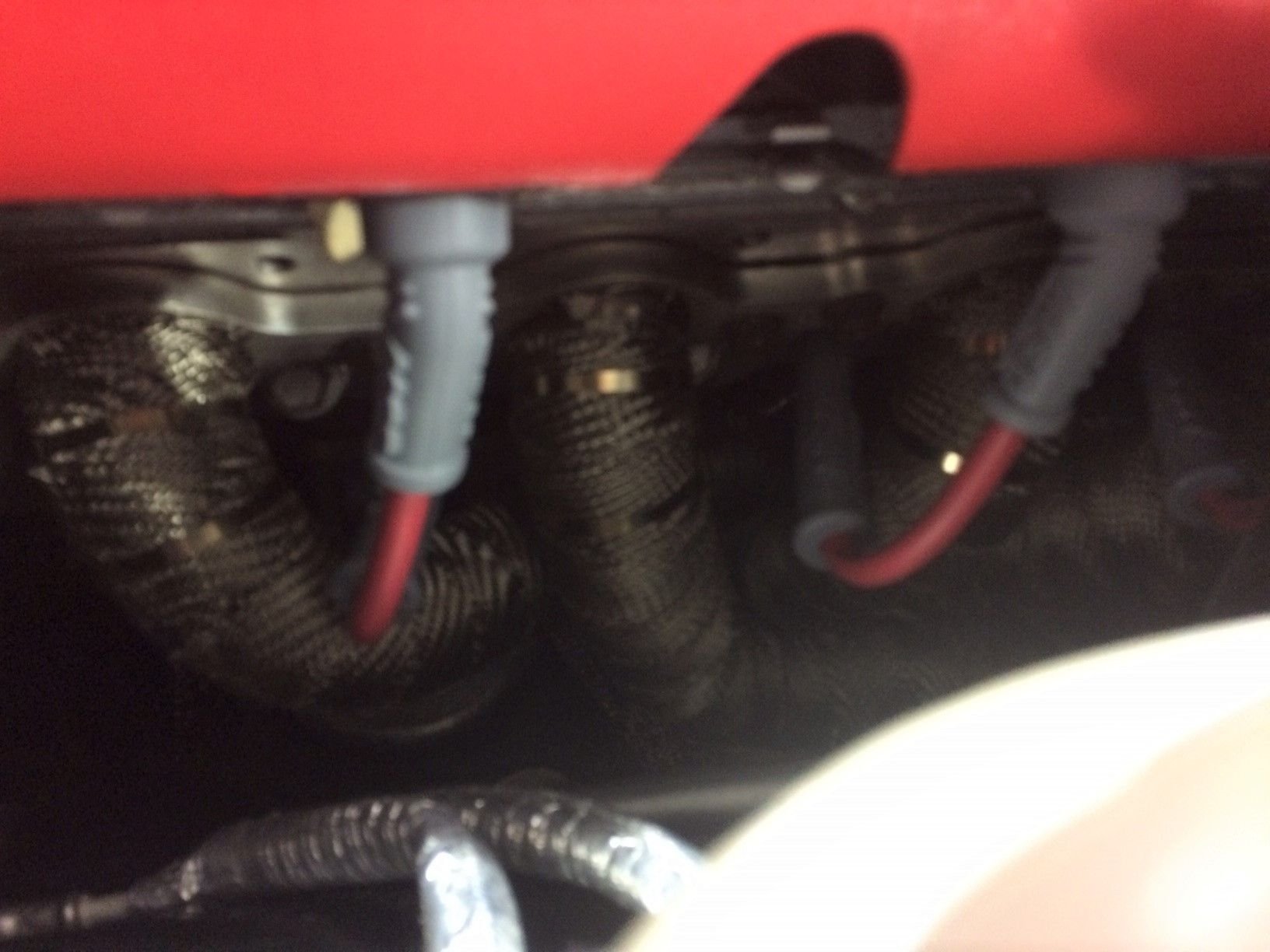

The car is still at the dealer but he sent me some pics I requested.
From my limited knowledge of computer cars with O2 sensors, all I need is a retune to include the sensors and a x pipe with some cats.
It sure is clean for 42,000 miles.
