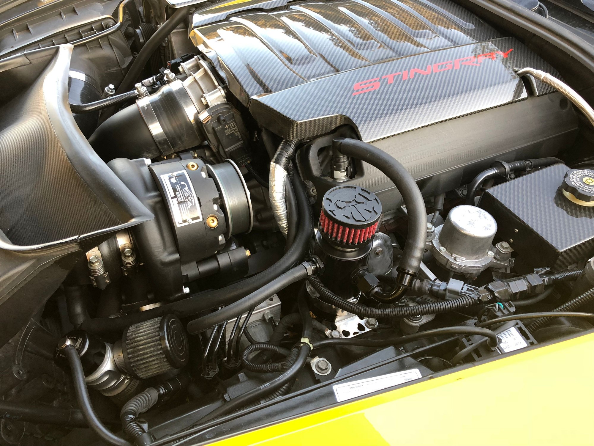

Obviously not a C5, but I have a Mighty Mouse on mine and the quality is very good.

Thank you for the input. I did check out the MM and noticed on big difference between the Mighty Mouse and Elite is that Mighty Mouse has a filter and is getting air from the outside, where Elite does not have this and is more of a closed system (for the lack of a better term).
Guess I will have to do some investigating as to why one has an open element while the other does not.
A catch can typically routes oil vapors back into the intake, which over time can coat the intake slightly with residual oil contained in the vapors (this is what your PCV does that a catch can is in theory supposed to reduce, except a catch can will reduce it to a much lower level) whereas a vented can lid will vent some of that vapor back into the atmosphere. The biggest immediately draw-back I can think of that will occur with a vented can will be 1) you'll likely smell vapors more as they'll come in through the HVAC and 2) you'll have another item to service down the road in changing out the filter.
Regardless per the posts above plenty of people run basic circulated style catch cans with no ill results.
