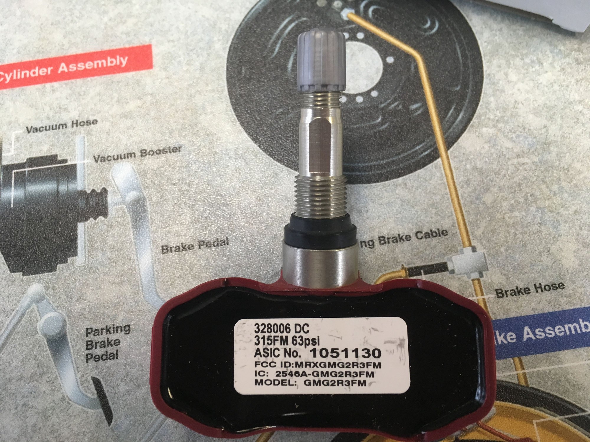

The early tpms were also Schrader, part number 28006. These are expensive from most vendors but I just bought four on EBay for $170.

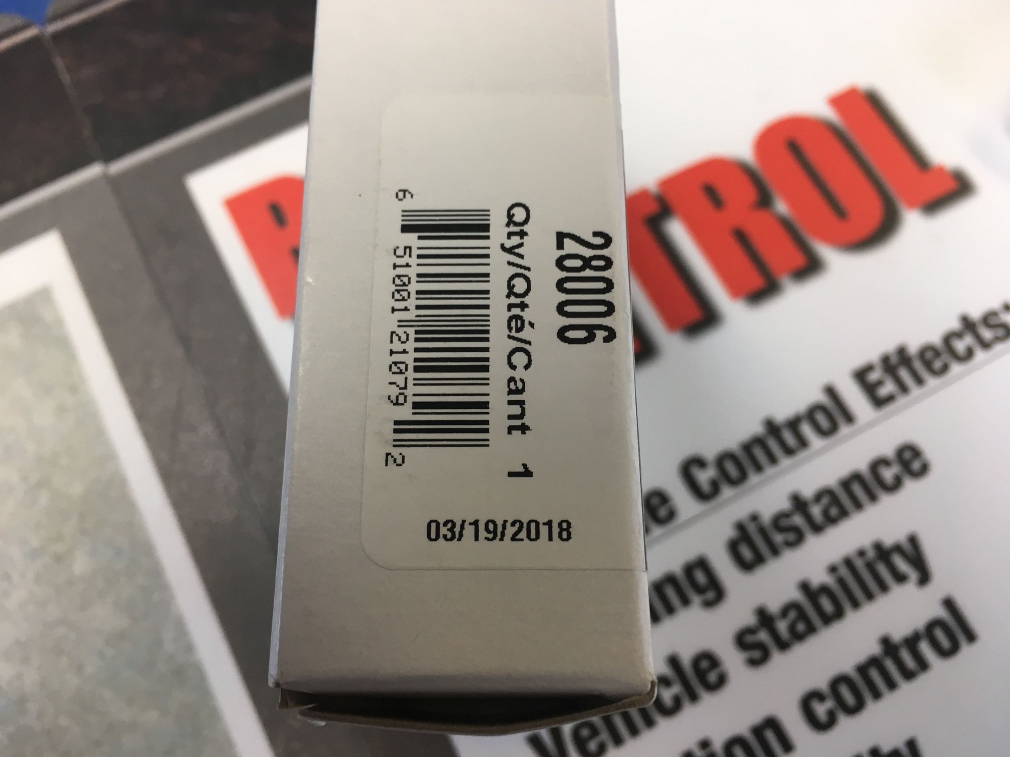

Default Schrader 28006 date codes
Originally Posted by Yello95
That's great...let us know the date codes please...just curious...Thanks
Here's one of the sensors:
I don't know if there's a date in those numbers but the box says 3/19/2018:
The date on the box is the date they were shipped...the date of the sensors on yours should be on a corner on the other side...the red side...in a clock circle with an arrow pointing to the month and the year in each side of the line
