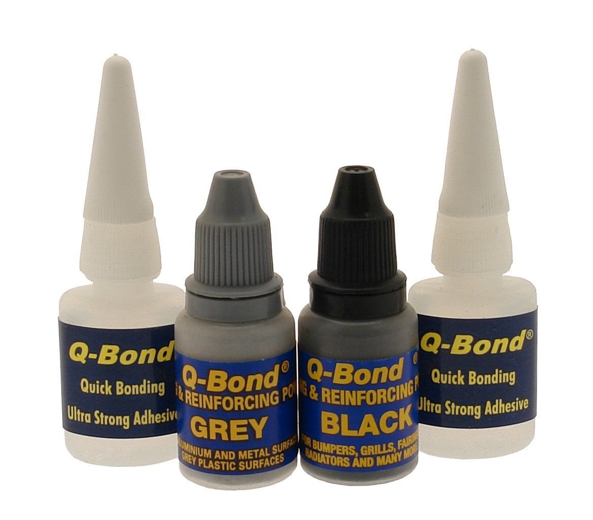

This stuff works great.used it MANY times to rebuild broken tabs
Amazon Amazon
I have also seen it for sale at Auto Zone and Advanced Auto
