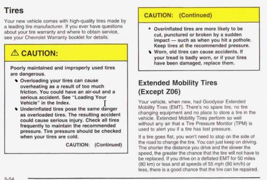

So Keep it in the sweet spot." ( 30/31 psi Hot )[/QUOTE]
Then why does Corvette's Owner's Manual shows this? I keep mine at 30 cold and they generally go to 32 when hot and as summer comes will probably be higher due to the fact I took off the run flats and put new tires on. But, I do check the pressures via instrument panel fairly often just being curious.
I do believe I'll follow them than you. ;-)
Excellent for you...keep doing what GM says is correct...they are always right...we all know that...I cannot give an example where GM has ever given bad information anywhere or screwed up anywhere...they got it right with the balancer issue..with the column lock issue..with their run flats issues...and lots of other problems...so please keep following what works for you
When I do what you do (30 lbs cold) in the summertime with temps 90+...mine go up to 35-36 and that is way too much for me...GM's 30 cold door sticker is a generic sticker...so lets both keep on doing what is best for us....
