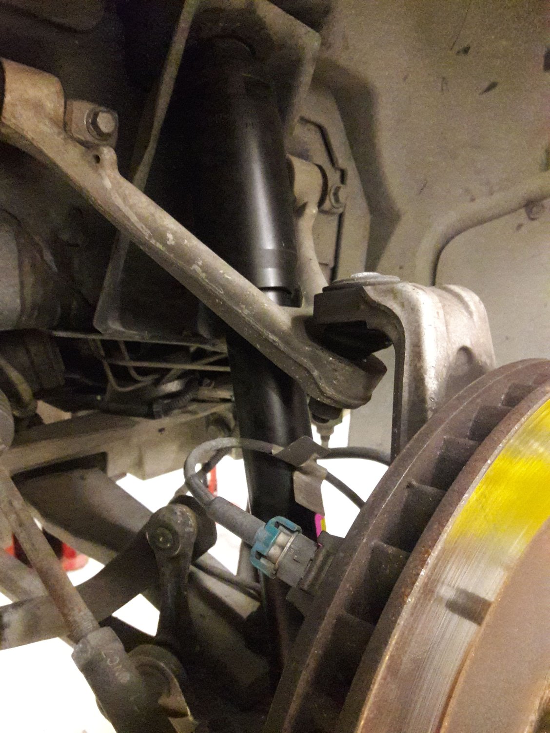

Finally got around to installing c6z06 shocks on my c5 (had some time at work to get it done)
2002 z51 with 75k miles. The last fun run I was on, I did not like the way the car handled in the corners It was not as stable during high speed cornering.
I read a few write ups on here about the install, and decided to order a set from RA.
I started with the rear shocks, since I heard they were easier to install.

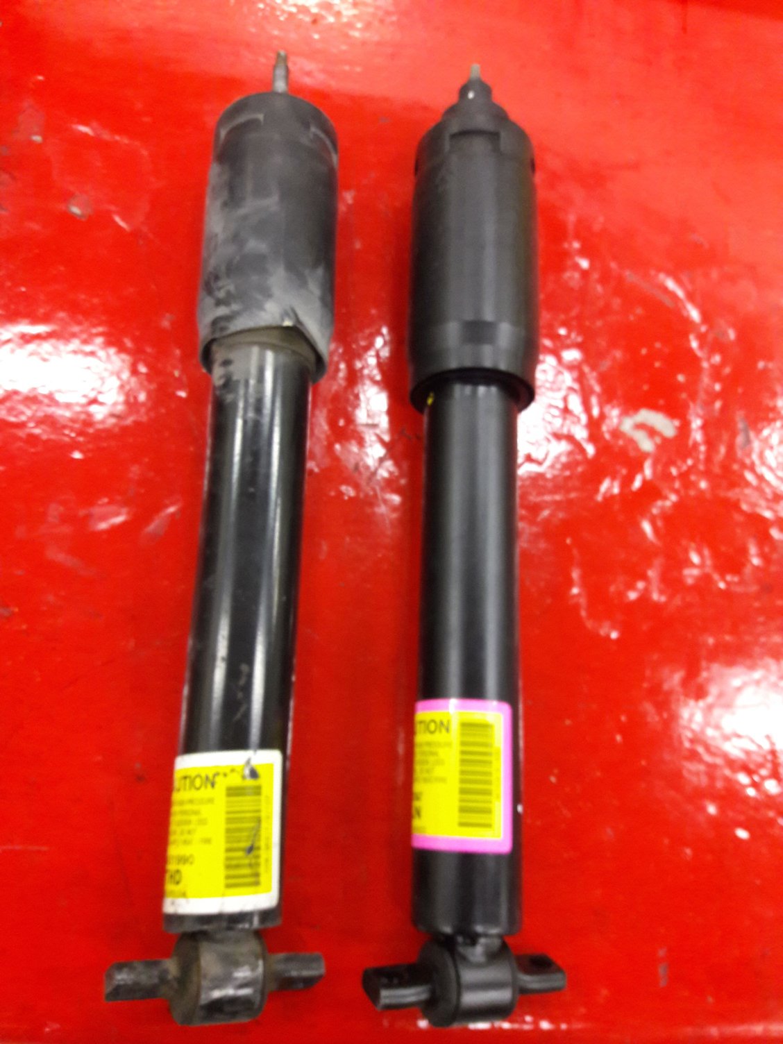

The rears were much easier to install than the fronts. Remove the 2 bolts on the upper mount and the large bolt on the lower mount, compress the shock and remove it.. reverse the procedure to install the new ones..

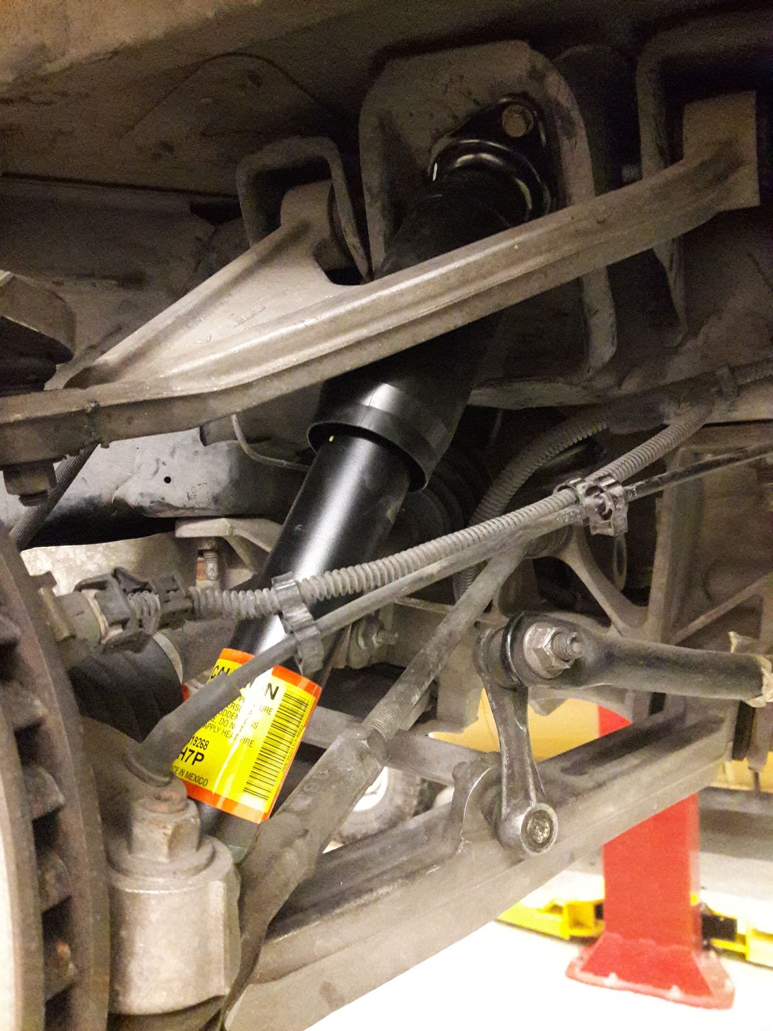

I struggled with my 1st front shock, until I decided to unbolt the upper control arm from the car.
After I unbolted the upper control arm, the front shock removal and install was easier.
Two bolts and nuts on the lower shock mount. 1 nut for the upper shock mount.
I also balanced all 4 tires and did my oil change. I plan to check the alignment after I put a few miles on it..

Old vs new rear shock
New rear shock installed
Old vs new front shock
New front shock installed
How was it getting the top nut off on the fronts? I bought the Lisle tool - paid extra $$ for express shipping - and the squared-off end just broke off. I wound up having to cut them off on both sides
Grab the top with vice grips. Try the needle nosed type first. Once the wrench hits the frame, you just ignore it and concentrate on the nut. Also, spray them down with PB Blaster. They aren't too bad.
I used vise grips on the old shocks, to hold the top of the shock while spinning the nut.
I used a socket for shock absorbers when i put the new shocks on, to hold the shock while i tightened the nut on top.
