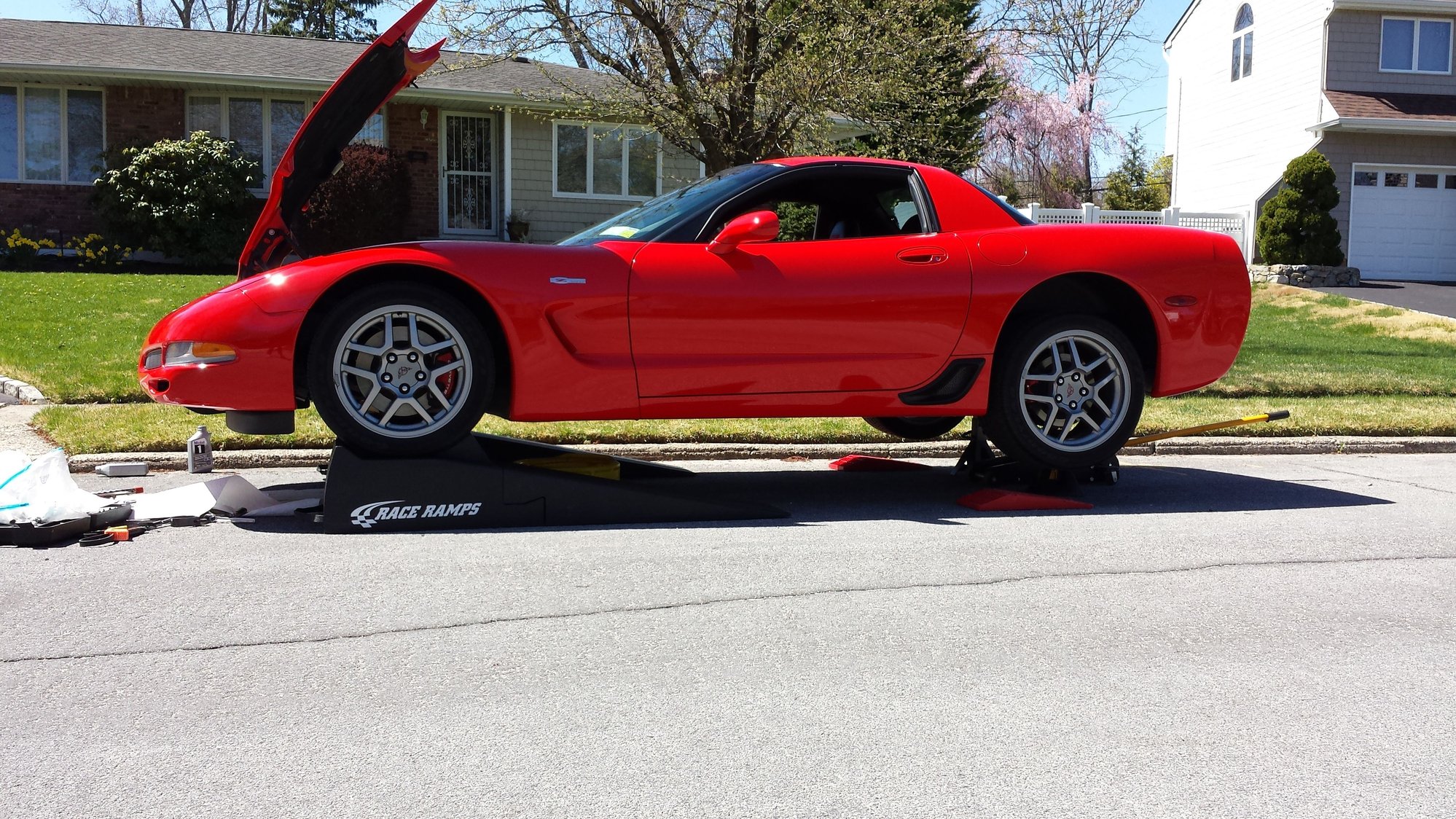

Race ramps - drive it up on the ramps for oil changes, I jack the rear up with a low profile jack and a 2x4 on a rear crossmember. If I need to take the wheels off - Once the rear is on jack stands I jack the front up just enough to get jack stands under the front and pull the ramps out.

I use race ramps with a low rise jack in the rear.

I used the Race ramps until I got the Quick Jack
