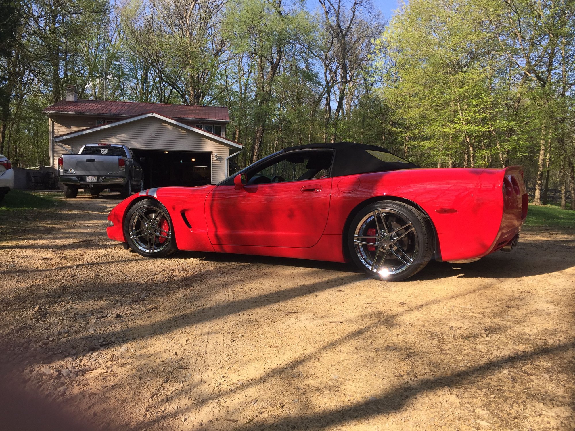

May car has 305's in the rear. They were put on by the previous owner. Th stick out a bit but he also added C6 style mud flaps which look awesome in my opinion
