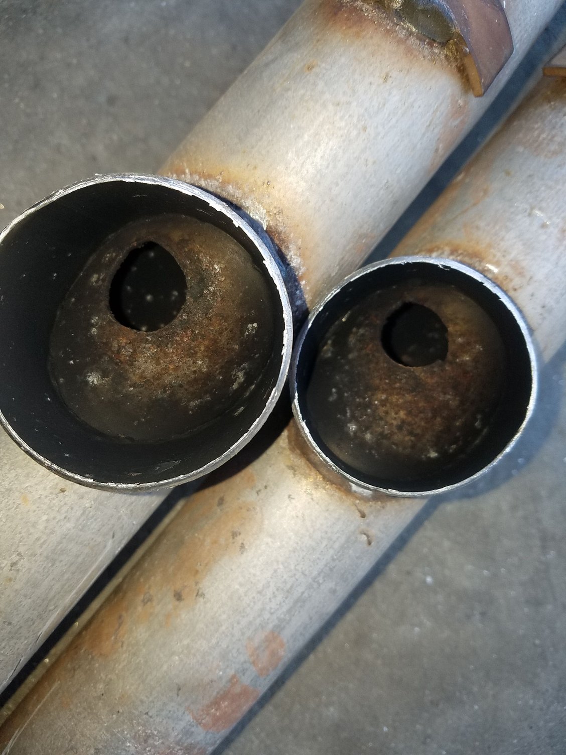

If I can find the pic I will post it. I was very surprised at what I saw. I was expecting the holes to be close to the size of the cross pipe.
Found one!
this is not the pic I saw, but it’s close.
Found one!
wow that is small....i made my H pipe on my '77 2.5 true duals and it was completely open.....
maybe a C5 design engineer will chime in and enlighten us. thanks bob

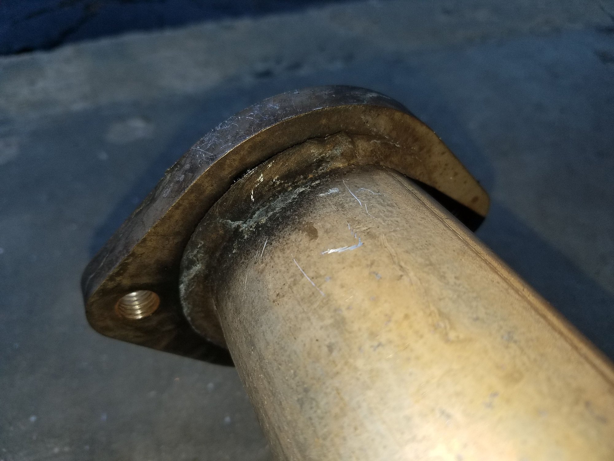

Cracked weld on stock H pipe
Stock H pipe cut open
One of the flanges on my stock H pipe broke when I put my axle back on. I did not want to re-weld it so I went with the Borla X pipe. Pic of my stock H pipe cut open,
Old Jun 1, 2018 | 01:26 PM
bobs77vet's Avatar
bobs77vet
Joined: Sep 2004
Posts: 11,874
Likes: 263
From: Arlington Va Current ride 04 vert, previous vettes: 69 vert, 77 resto mod
so that says to me they are only equaling out the high pressure pulses and that they dont want it to be unrestricted for some reason. they could have made that hole any size they wanted.....
